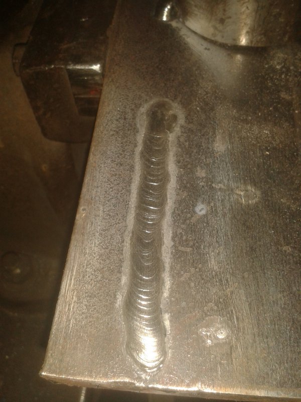

Other day local scrappys rung me to say a holdall of welding rods here do i want them?
Yer why not have a look
Anyway most of them were 6013's of various sizes but were shot(got far to damp/wet over time.

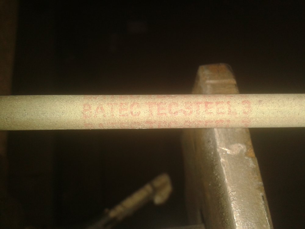

But what was in this bag were 15 of these
They're 6mm 300mm long in a green coating and steel(magnet test)
Did a google on the name(thats all thats written on them BTW) didn't come up with much

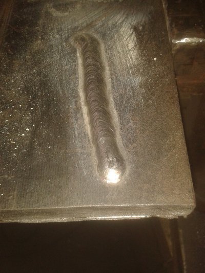

so i thought lets dry them out and burn one
Ramped up the machine to 175 amps striked up very easy and burned quite well,had to keep it very tight arc though, thats on a bit of 12mm plate btw

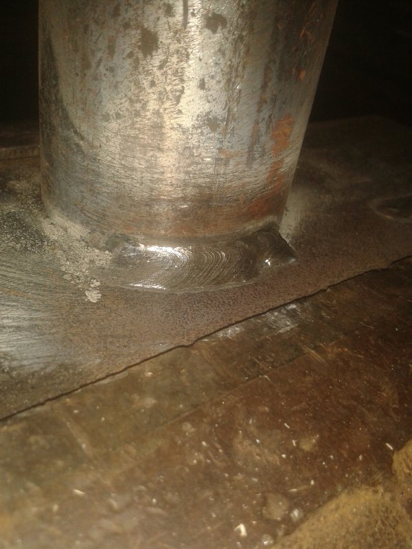

Then a bit of 6mm pipe to the 12mm plate see how that went
Just a short run,but went on smooth

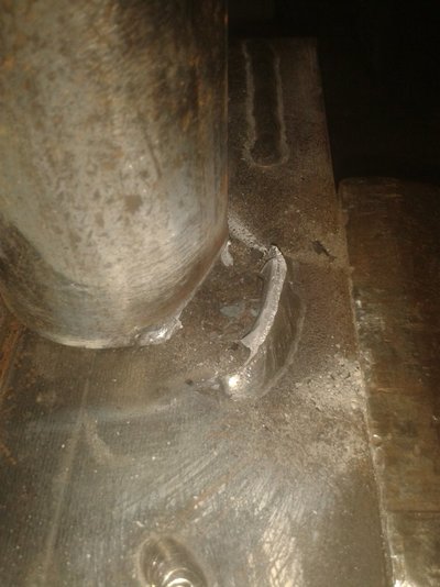

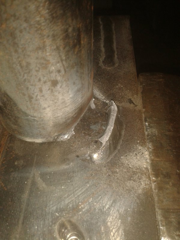

Now lets see how strong they are

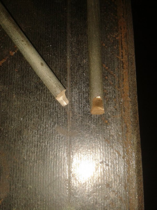

Blimey,that was serious BFH and 7 blows to break that,you can see some of the pipe broke off
What the hell are these rods?

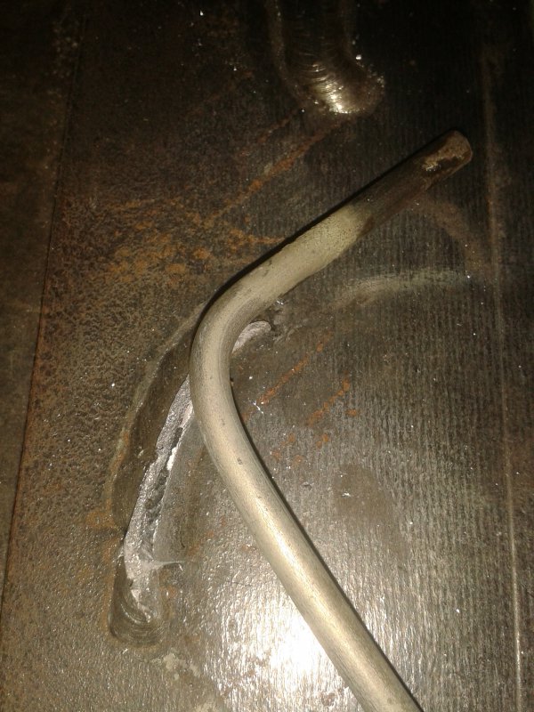

Just to add,some of them weren't worth using,so i thought i'll make up some hooks being 6mm they'd come in handy as you do
Well heated them up to a cherry red but when i tried to bend them they just snapped like they were glass,wow,strange?????????
So you knowledgeable old time stick chaps any clue what they might be?????
