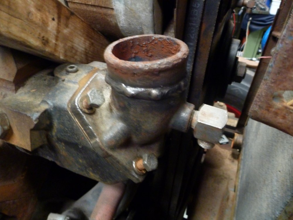

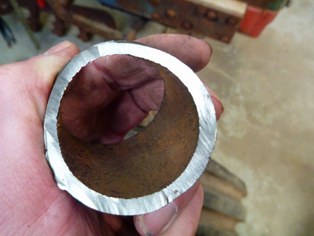

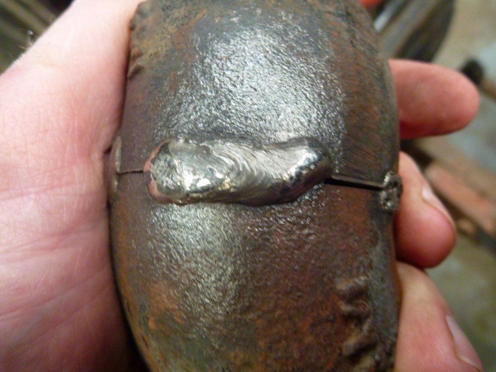

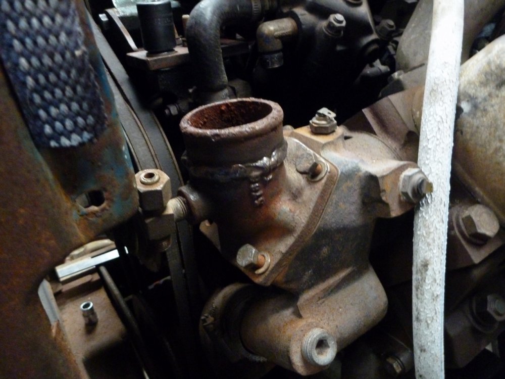

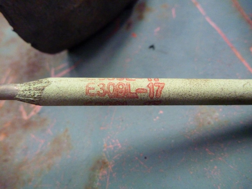

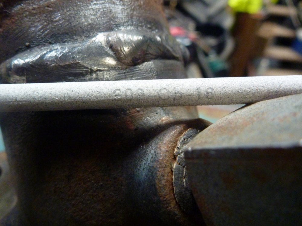

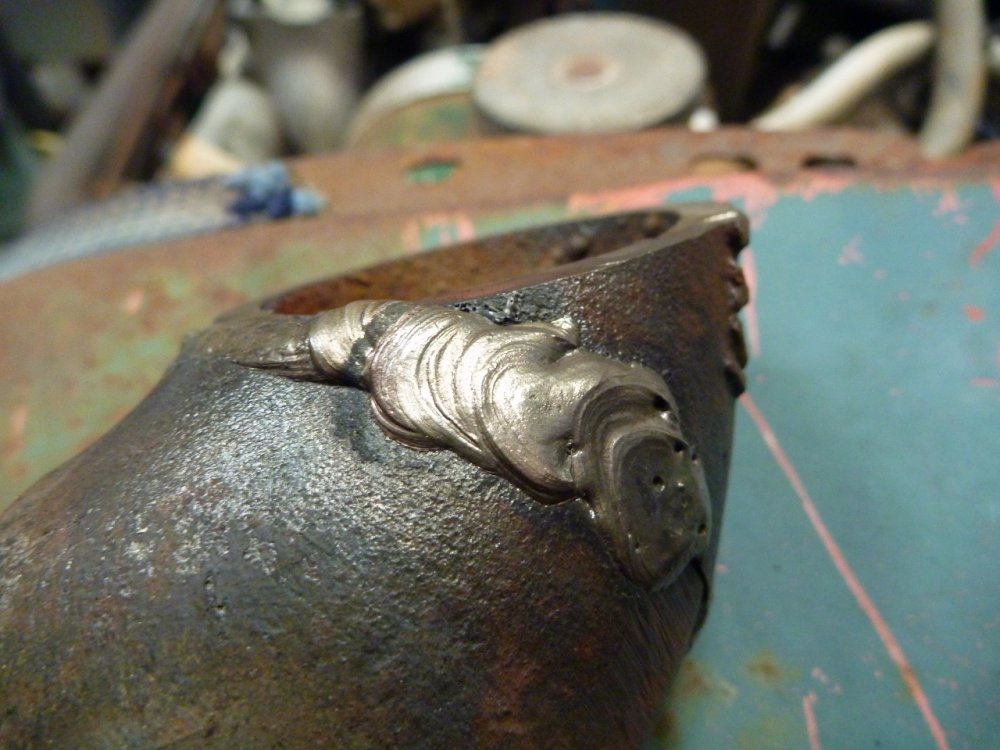

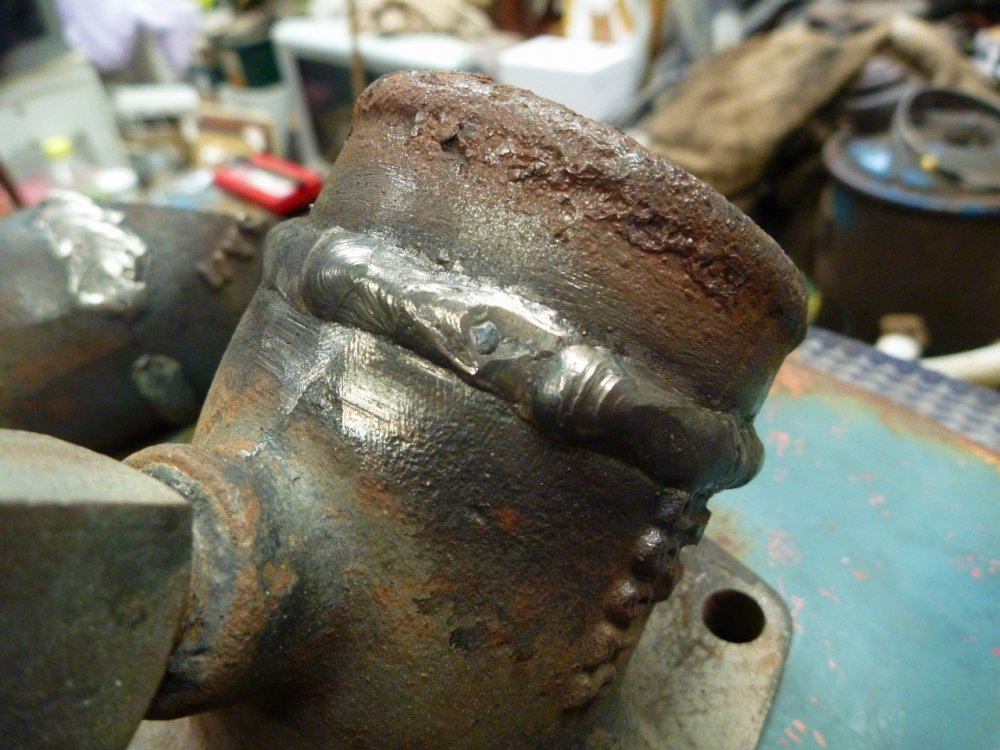

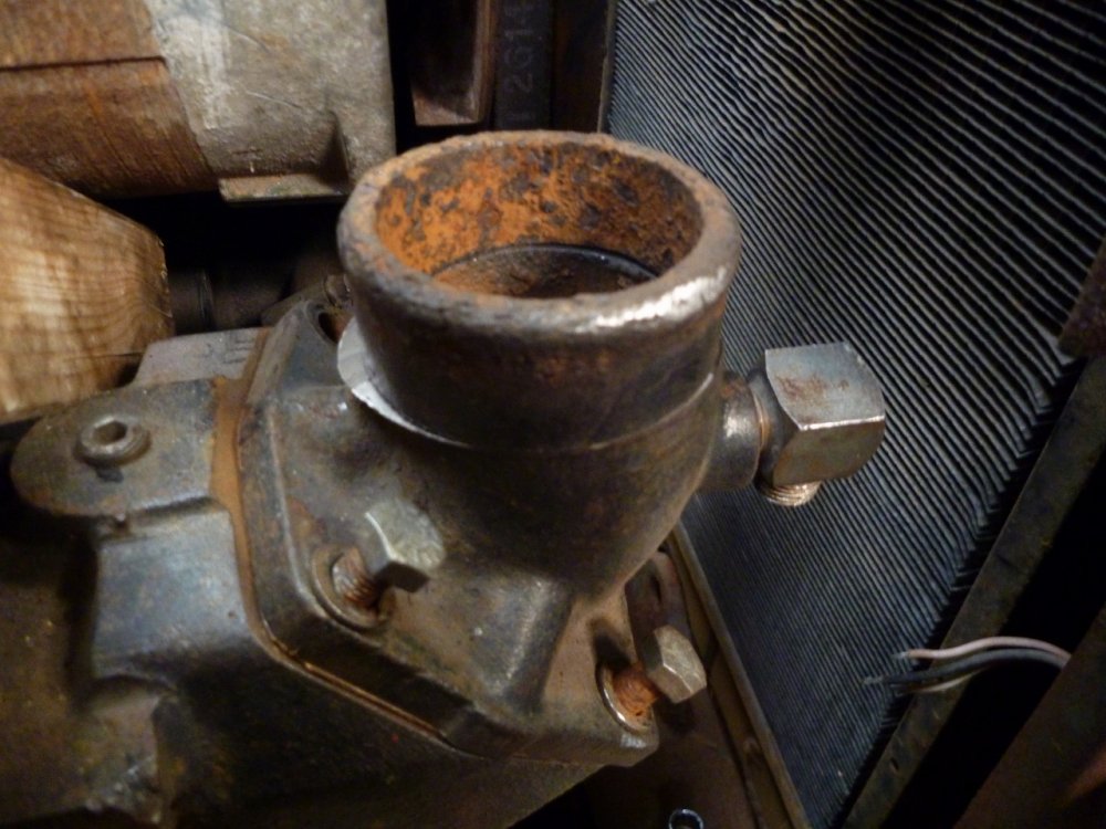

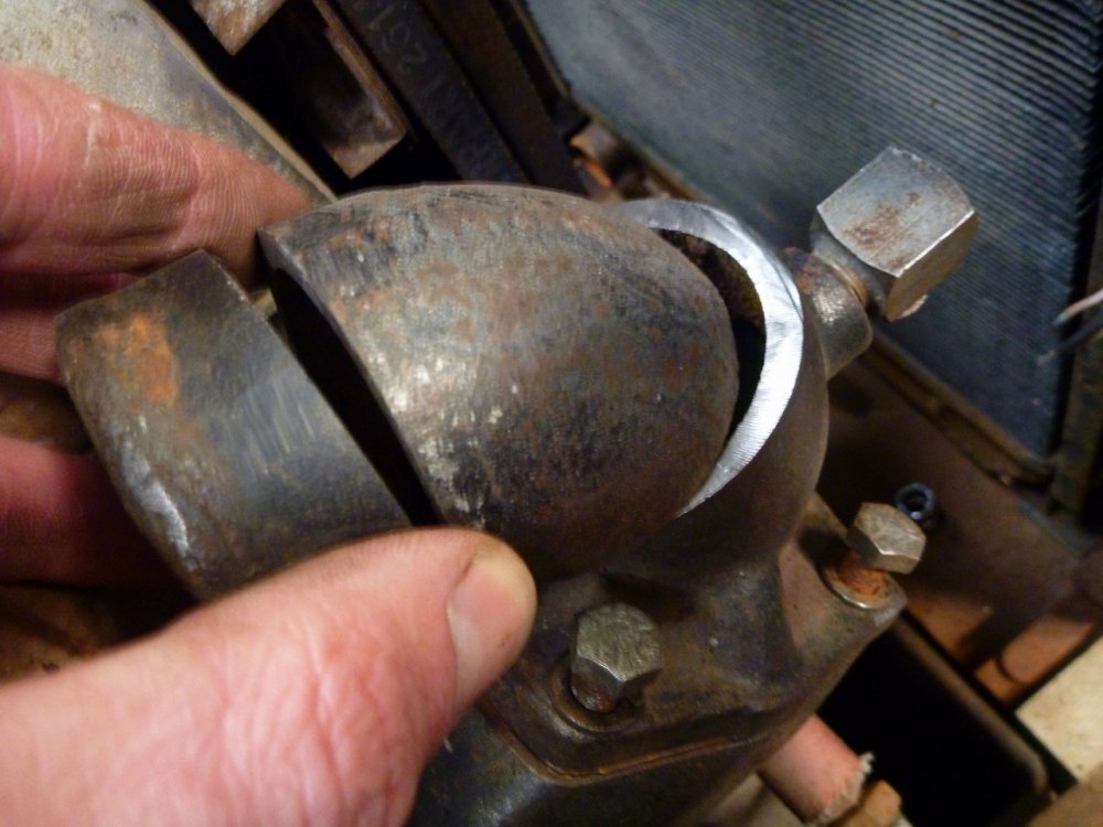

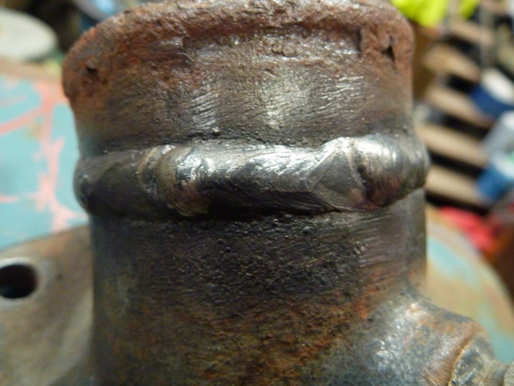

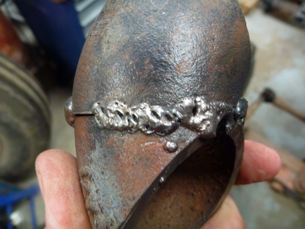

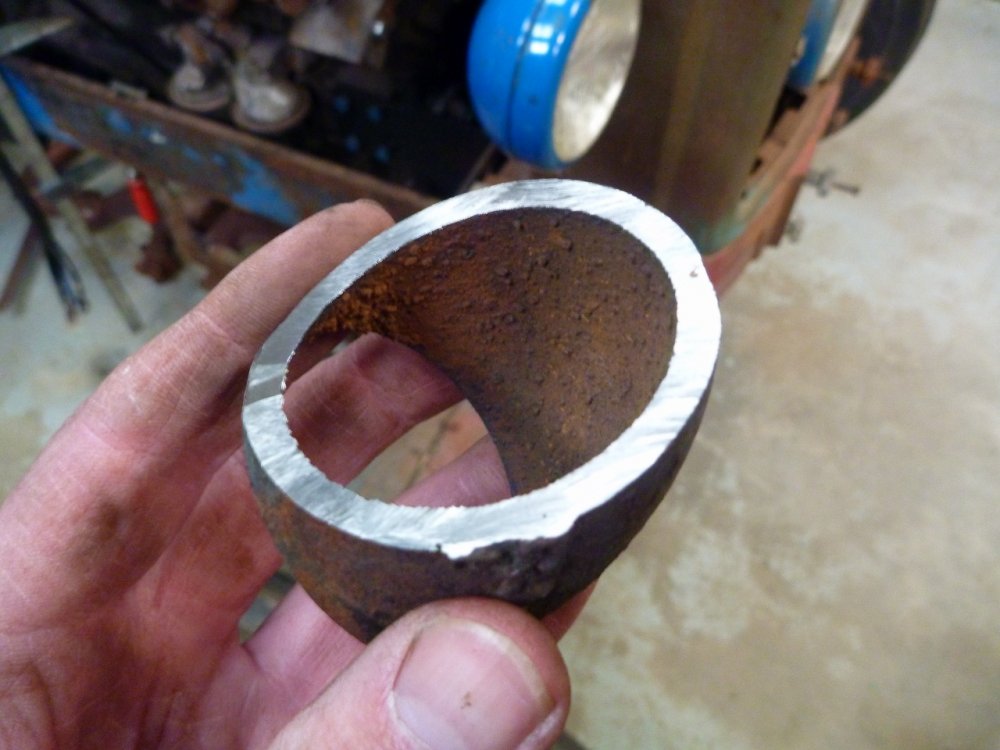

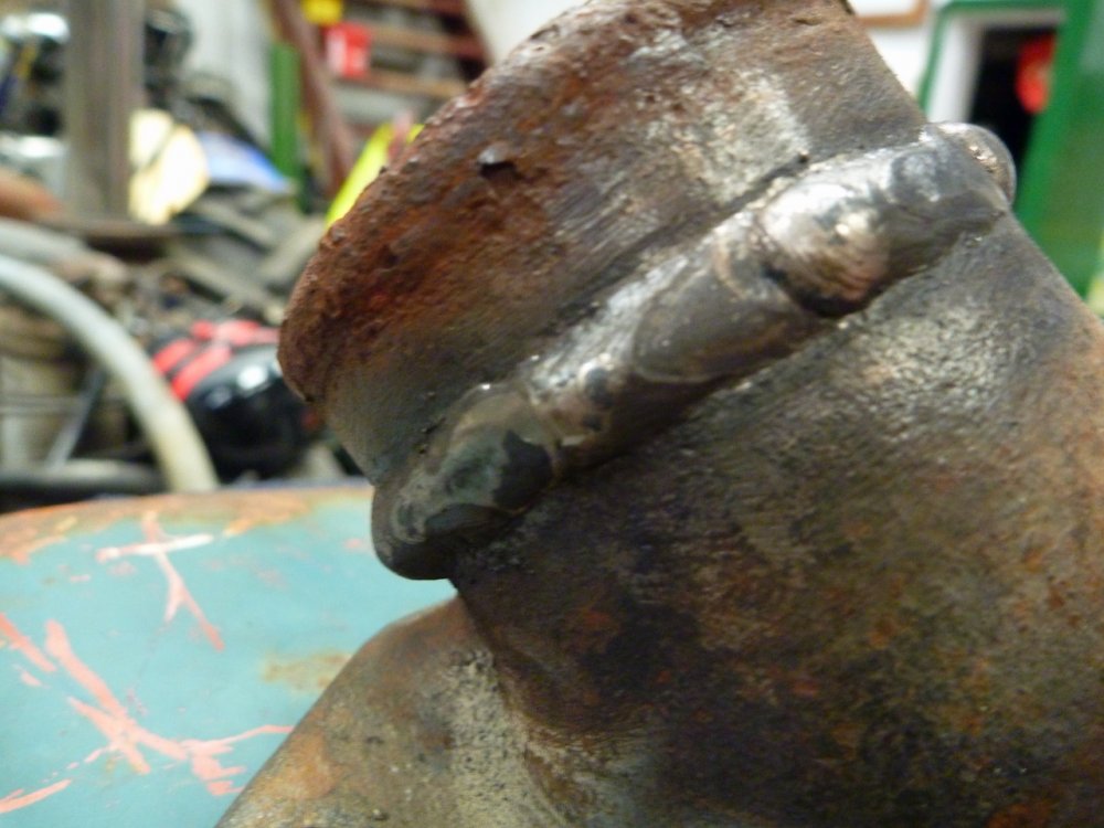

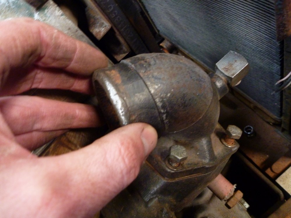

Evening all, I have got a pair of thermostat housings from a Perkins v8 engine that need the outlet repositioning. Now I think they are a cast steel as opposed to a cast iron as a new hand file doesn't want to touch them and we tried cutting one in the chop saw which has a tct blade to no avail.
What would be your advice on rod type be to re weld them back up after we have managed to cut them ? Wall thickness is about 3/8 and 2 1/4 diameter od.
Could they be tigged instead ?
Thanks in advance
Chris
