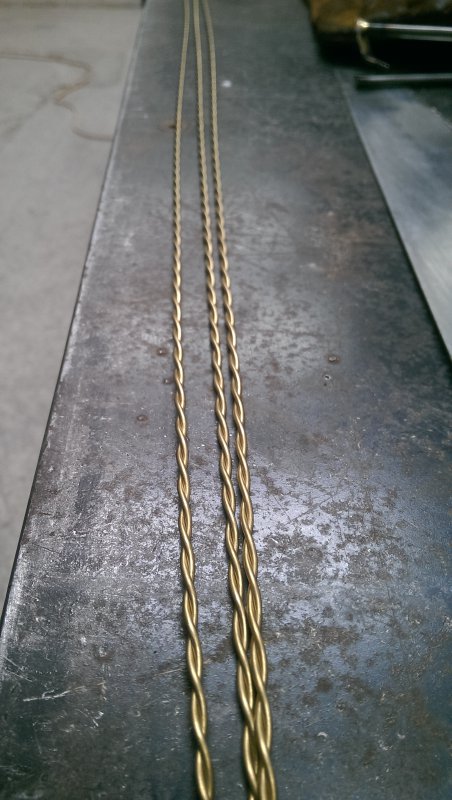

I am getting low on 3mm brazing rods.
I dimly remember a drawing i ons of those old handyman books of some old boy twisting thin gas welding rods together to make a larger one. Like hell I thought.
I have two tubes of 1.2mm brazing rods doing nothing. stick two in the vice, pop the other ends in the chuck of my cordless drill. And hell it works.
Could also be used for jewelry as well. It is quite hard picking up short the end of the last rod with the new one, but it works as well, so no waste.
