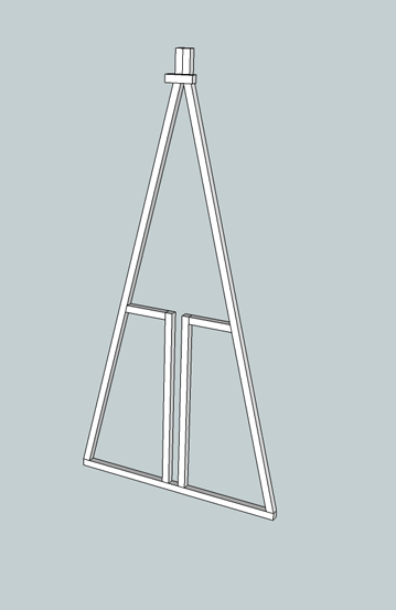

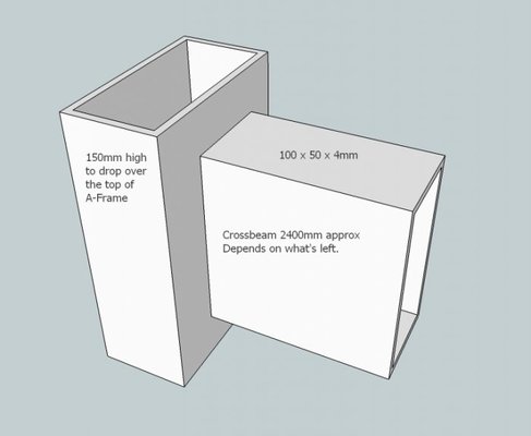

The next step is a rotisserie to make life easier when it is time to do the underside, cleaning, repairing and painting. This is where I'm going to need some guidance, I've got a few ideas but no idea what materials I should be using. The car started off weighing in at 1052 Kg, I would think now I will have a max of 550/600 Kg to support on the rotisserie.

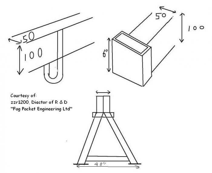

After hunting the site for inspiration and following countless links these blueprints from zzr1200 were the starting point, from a thread about an engine hoist gantry.

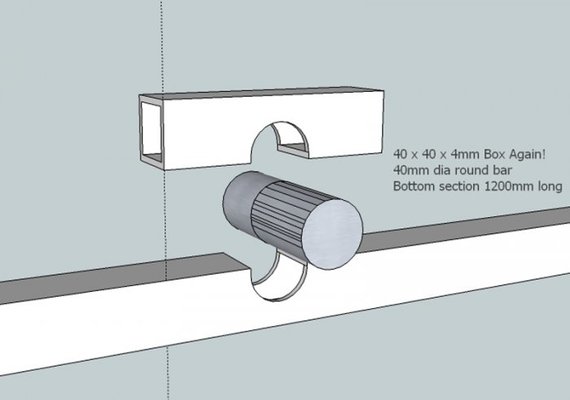

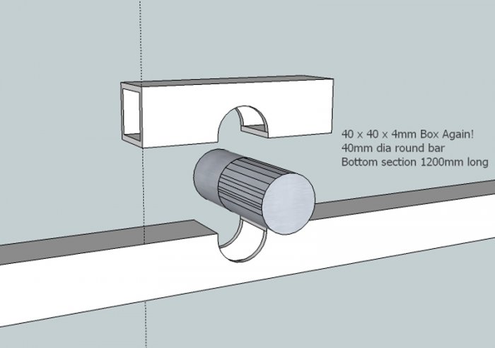

I thought it would be handy if I got 2 tools in one So here are some sketches put together on Google Sketchup
The A-Frame is all 40 x 40 x4mm box as are the 2 uprights that will support the pivot, up to the job?

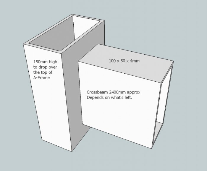

The crossbeam for gantry duty, 100% knock off from zzr1200

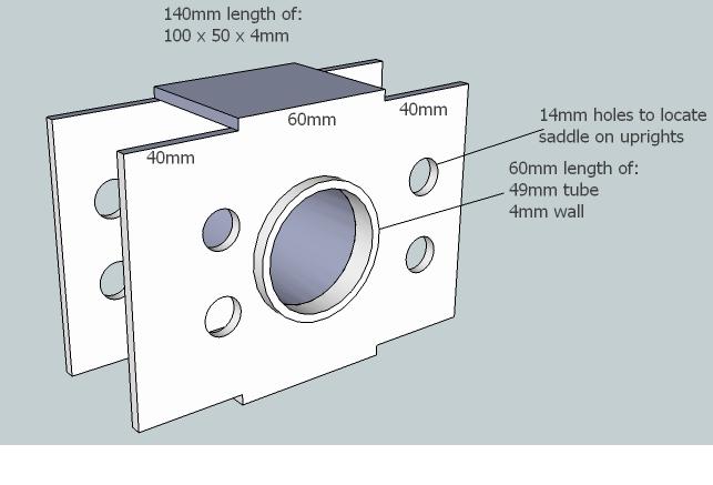

The "saddle" that will drop over the 2 uprights and support the whole show, hopefully
I think that's more than enough to be going on with, all suggestions, criticisms and guidance gratefully received,
