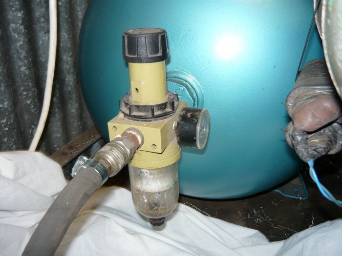

price of a norgren water seperator regulator free
