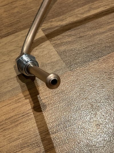

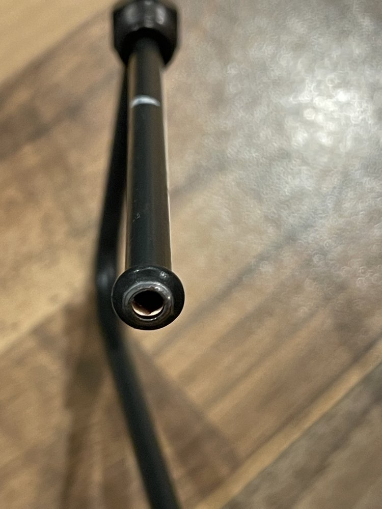

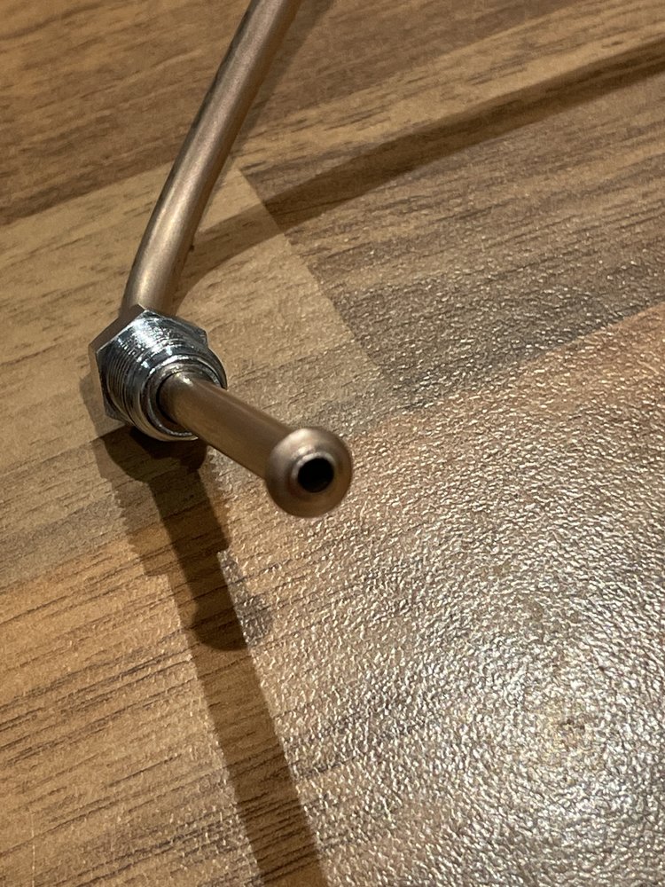

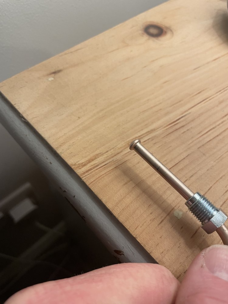

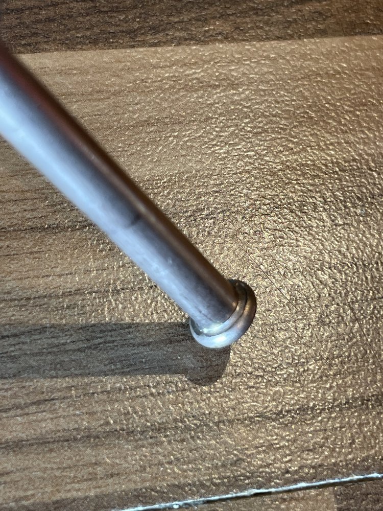

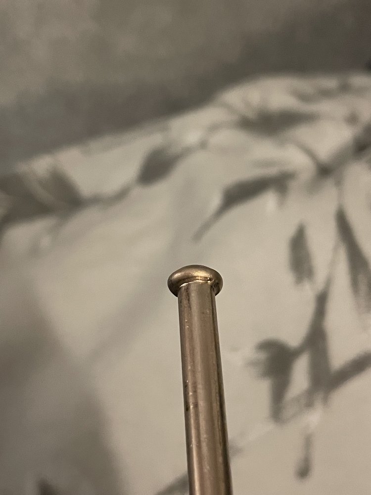

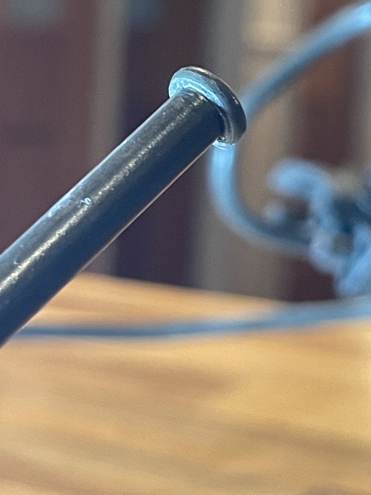

Here’s some better pictures of those flares on the pre made pipes (fronts are steel pipes from dealer, rear are Kunifer from an eBay seller):
Since it's a "bubble" type flare and I assume it's a modern vehicle then it's going to be DIN/ISO.

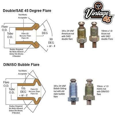

There's a lot of confusion around but it's really not too complicated. The key thing is to establish the difference between the old "Girling" "Bubble" and the DIN/ISO "bubble"
Many classic minis had both DIN/ISO and "Girling" bubbles on the one line. The Girling bubble is formed using the first step of the SAE double flare, the DIN die has nothing to do with it. I've encountered replacement wheel cylinders for 50s British vehicles where they require Girling "Bubble" flares instead of the original Double SAE flares. I've read of people doing some dodgy "fixes" (copper washers) despite the real fix being changing the flare type.
I agree it looks like this car has DIN/ISO flares (it’s a 2013 MG).

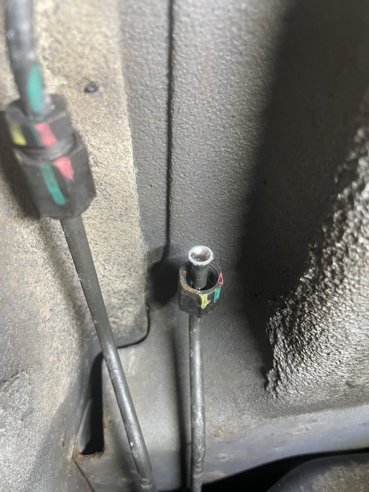

The car in question does have 2x pipes with male/female joints from factory. Every other pipe on the car has male ends as you say.
These 2x pipes start from the ABS module and go to just under the passenger front floor pan with female ends, from here 2x long pipes with male ends go to the rear brake flexes.
Would these female ends be SAE double flares? If so then DIN male connects to SAE double/female no problem?
My plan is to replace the pipes from these male/female joints back to the rear brakes with Kunifer. I don’t want to replace these front pipes that have the female ends as it looks a PITA and theres nothing wrong with them either.

The most important thing about a DIN flare is the square shoulder at the back of the flare and the matching shoulder of the tube nut. Because of this, you can't double flare a DIN flare because there's nowhere for the material to go. SAE tube nuts have a notable chamfer to match the tapered back of the flare, but also means the double flared material has space to move into when required. The above diagram isn't great because the DIN flare is quite ambiguously drawn.
This is a better example. Ignore the single flare
DIN tube nuts should have a plain section on the flare end (SAE can be with or without depending on manufacturer) which can be necessary depending how deep the thread is tapped in the fitting. An SAE fitting with full thread wouldn't seat before it became thread bound in such a case.
You have DIN flares and DIN tube nuts on your pipes and as you need a bubble flare to connect to your pipe joints, it doesn't really matter if it's DIN or ISO (providing the female tube nuts are tapped full depth) because the outer face of the flare is essentially the same, but just make the flares to match the tube nut acting on the flare (don't make ISO flares and use SAE tube nuts and vice versa)
