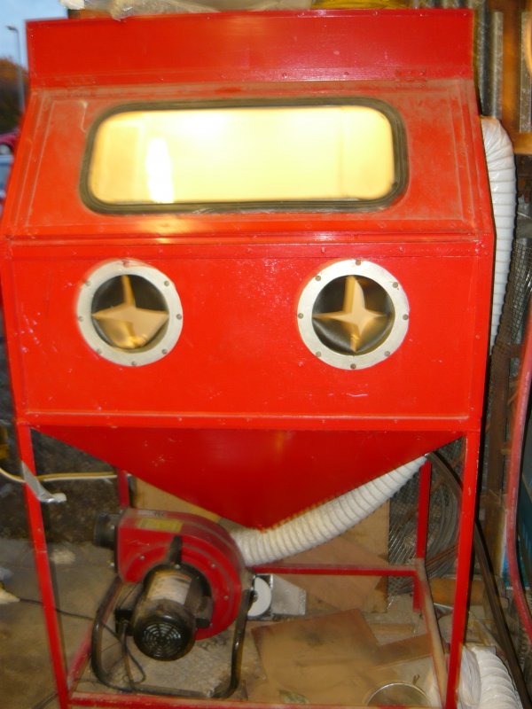

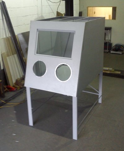

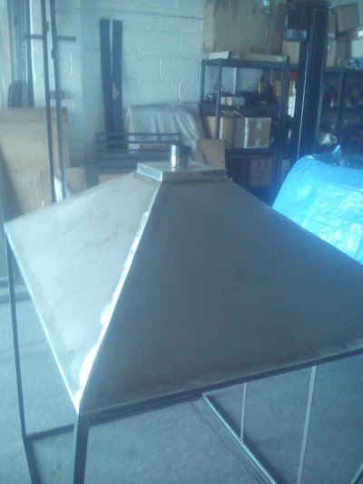

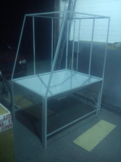

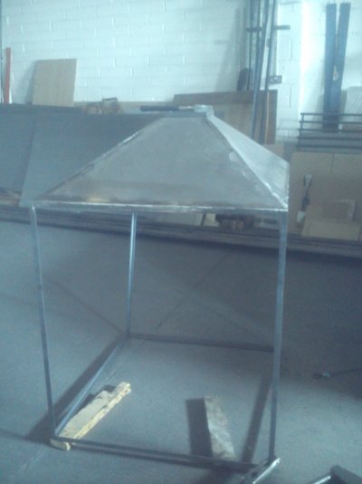

Here's my latest project, a sandblasting cabinet. I will probably be mostly using this to clean vehicle wheels. I looked around at the existing cabinets on the market and found the Guyson Wheelmaster, so I set about copying it.

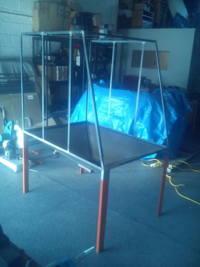

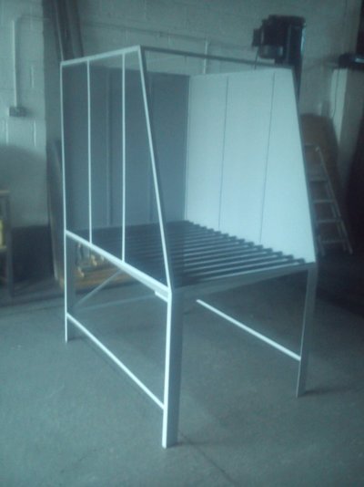

I have used 20mm x 20mm x 3mm angle, 3mm flat and 1.2mm sheet.
