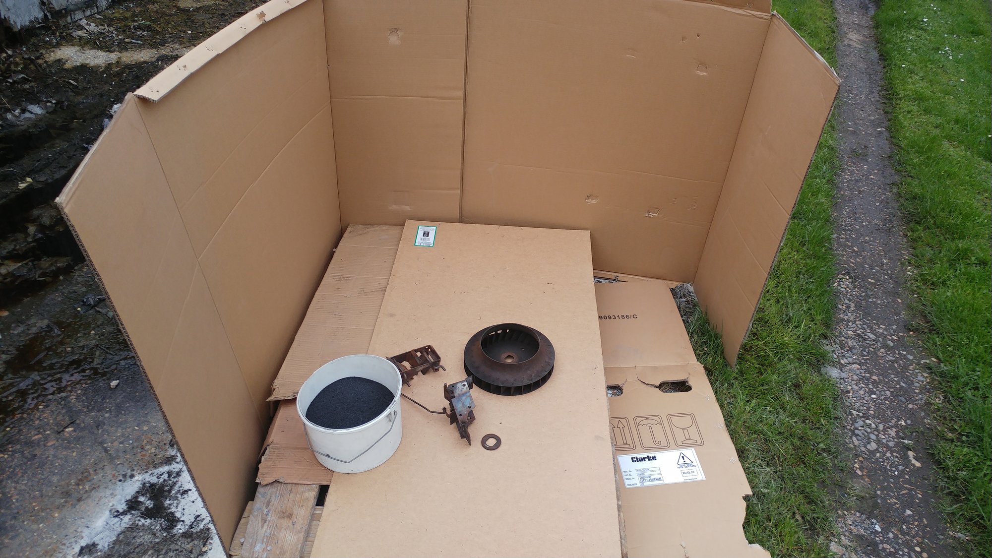

Just want to update everybody who contributed to my thread. So first of all I did not go with crashed glass or glass beads. I did not have to many parts to blast so I thought I did not want to spend the money. I build a cabinet using first just cardboard boxes which you can see in the first pic.

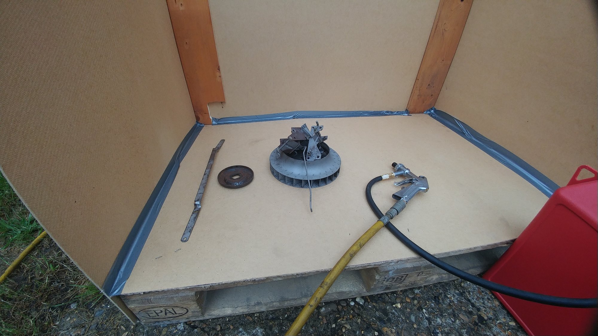

I changed it to some I don't know what it is chipboard sheets? that I got from wickes.

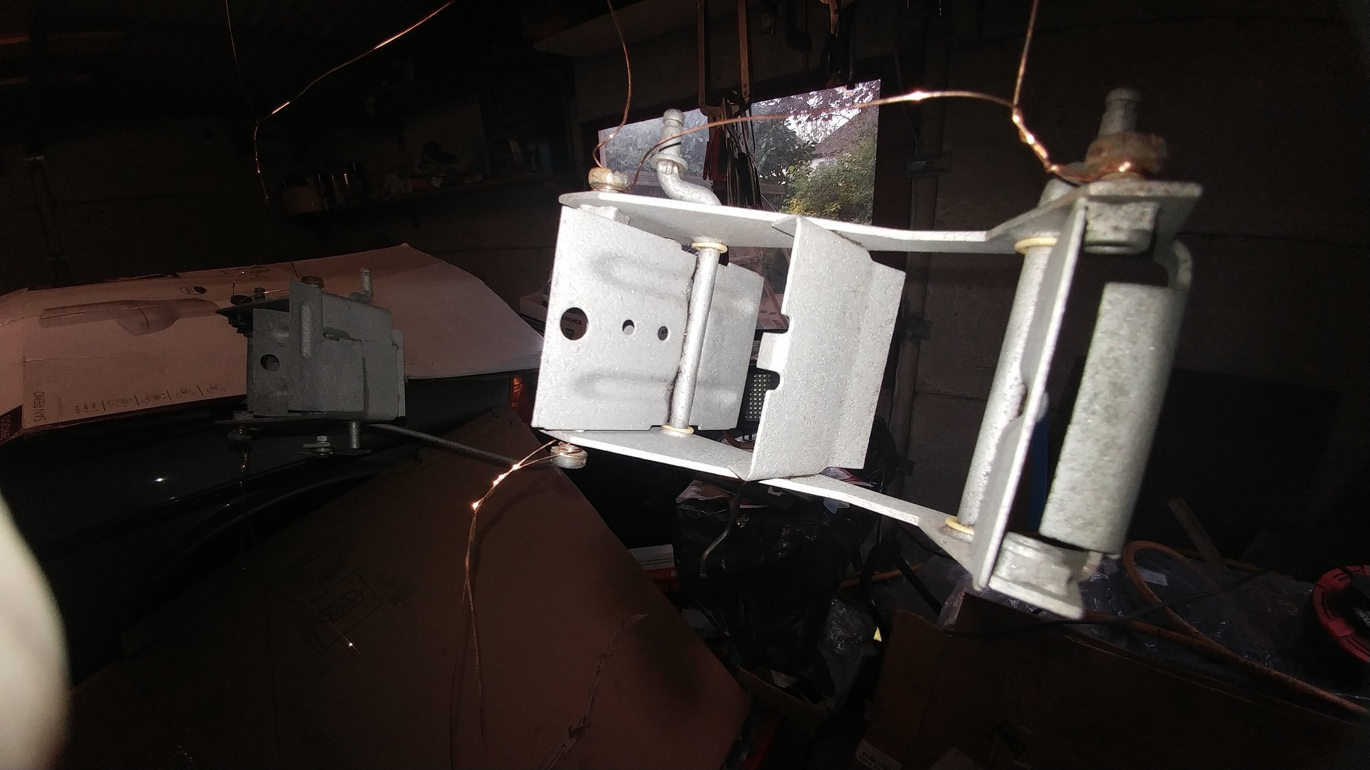

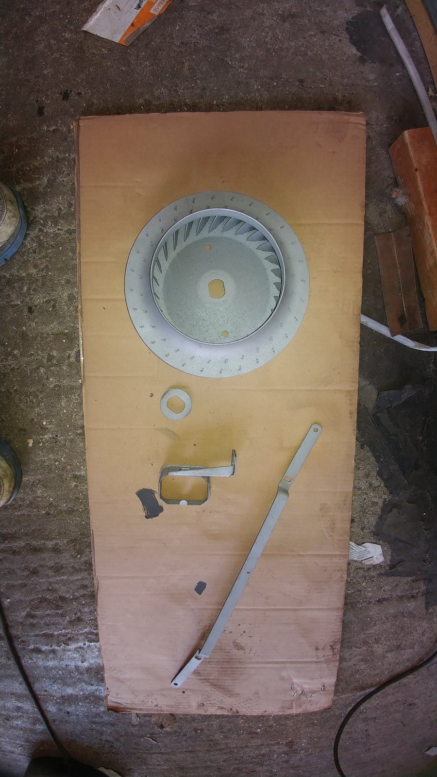

I used aluminium oxide that I used to sand blast sub frame for another car couple of years ago and I used this portable sand blaster that turned out to be useless. Ive got a big blasting pot but as I mentioned before I converted it to soda blasting pot and did not want to put aluminium oxide in it. Anyway the next couple of pictures show the results I achieved.

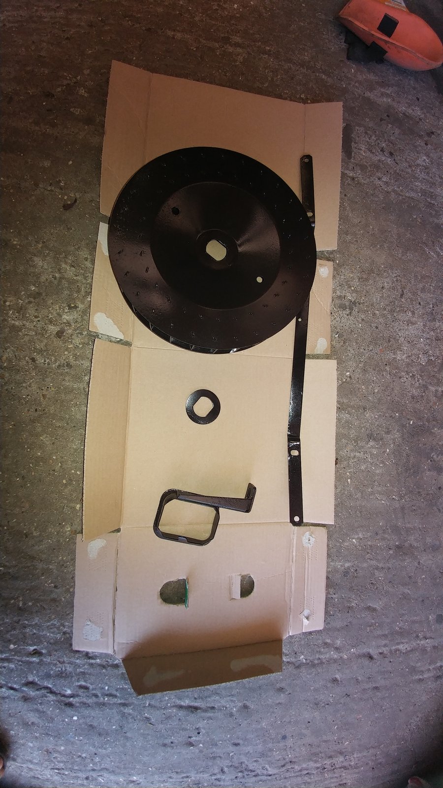

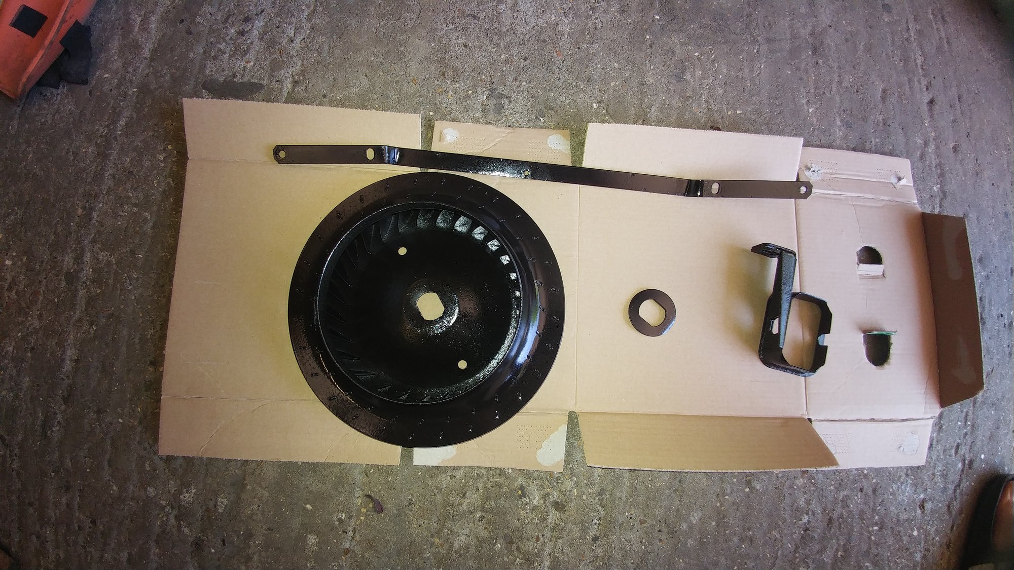

I also painted the parts. There are parts for VW aicooled engine by the way.
