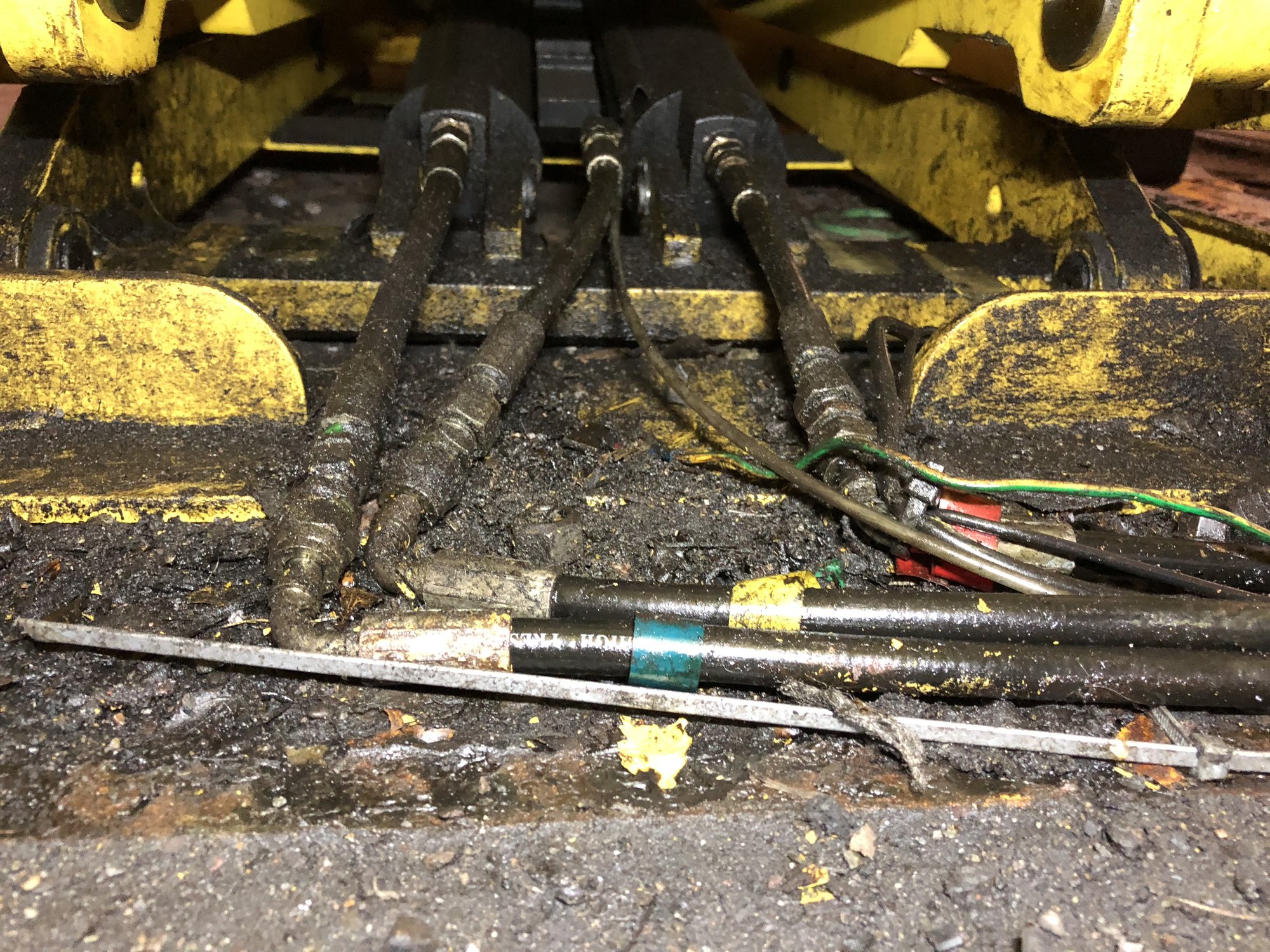

I have a few scissors lifts/ramps - two different makes, which I will need to relocate, there are three lifts that are not currently working at the moment, and that is where the problem begin.
I will need access to underneath the deck to undo the anchor bolt to free them from the floor, which I will need to lift the deck up, but with the lift not working this presents a small challenge.
- They have double acting cylinders fitted and I am thinking to undo the hydraulic hoses to the cylinders and lift the deck with an engine crane, will this work?
- One of the ramps is recessed into the ground, so lifting with an engine crane might difficult, can I use a portapower - with the correct adaptor fittings, to jack it up? I will support it with some wooden blocks while undoing the anchor bolts. They weight around 800kg per set.

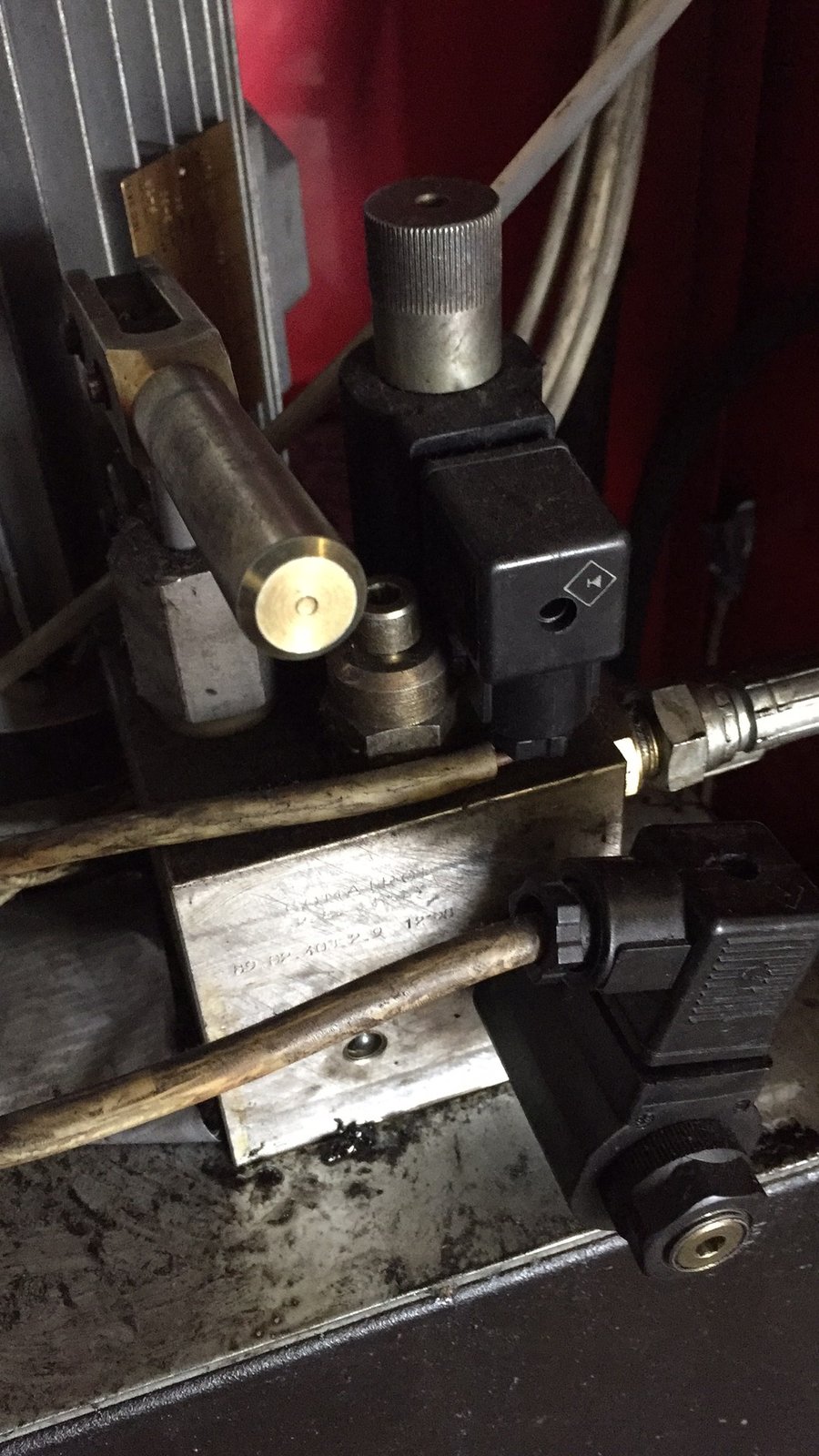

- One of the ramps is fitted with a manual backup jack, and I have tested it and it works, but could someone identify the release from the valve block?

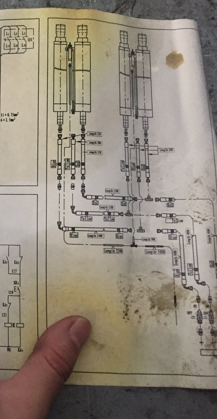

- They have three connections on the schematic and I am wondering why they have individual supplies for left and right cylinder for extension but only one pipe for retraction? I have attached the schematic below.
