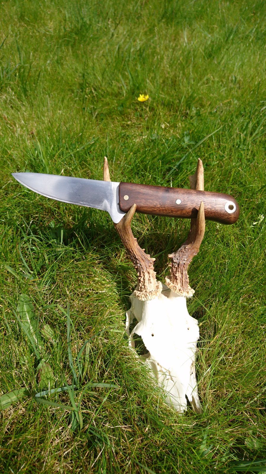

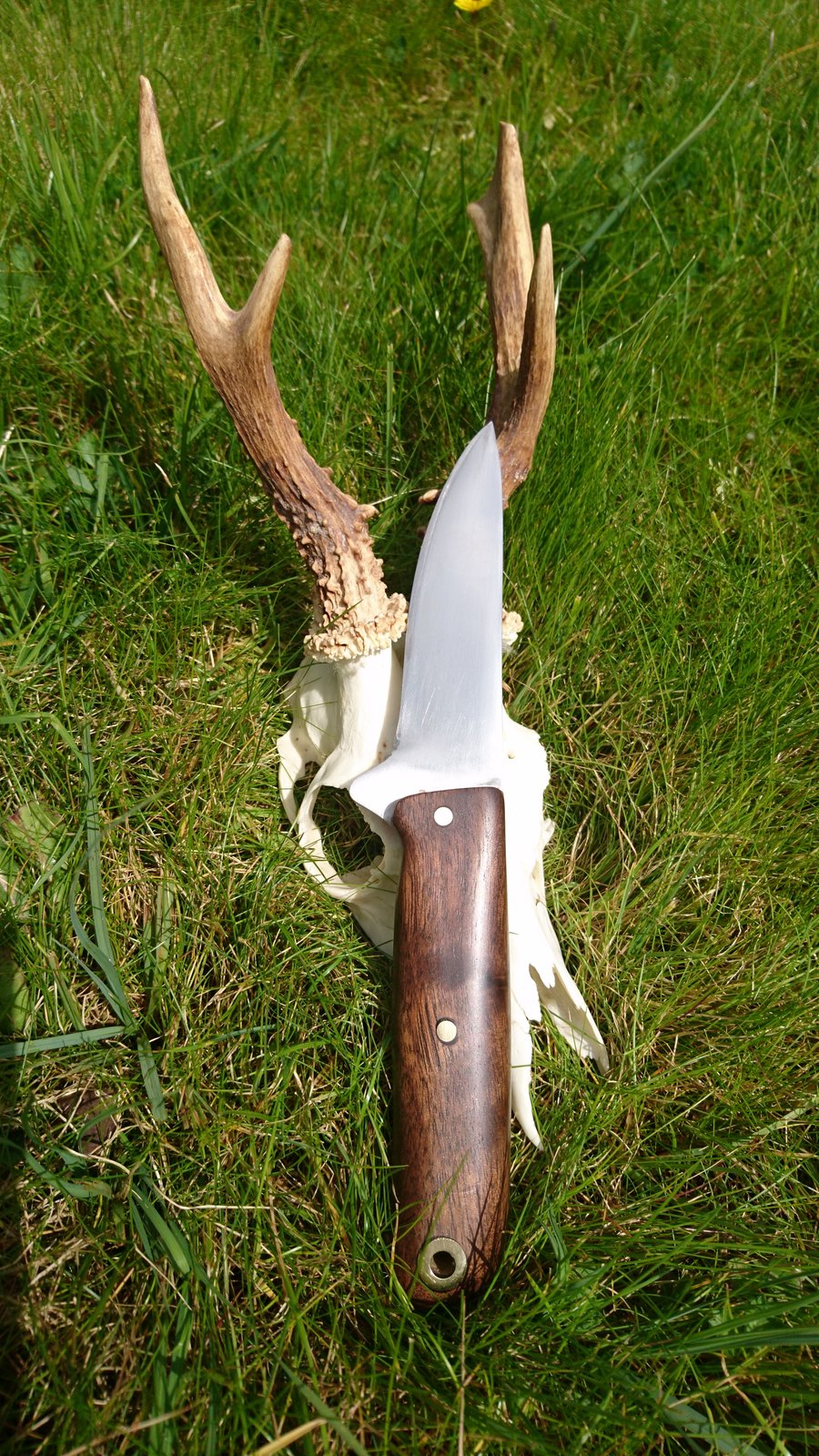

5mm x50 mm 01 tool. It's OK but not my favourite as it tempers funny. Sort of holds out then all of a sudden the colours seem to shoot through and it has to go into a water quench like lightning. The full taper shown is definitely easier than a scandi to time in that regardLet's not go off on a tangent and discuss the pros and cons of knife legislation.
Great work again and nice photos, what metal have you used this time ?

Ah, that little fella ain't for sale. Not a good head or anything just a run of the mill roe buck I shot many moons ago with a story behind itBeautiful work, it fits the skull perfect too.
How much for the skull?
