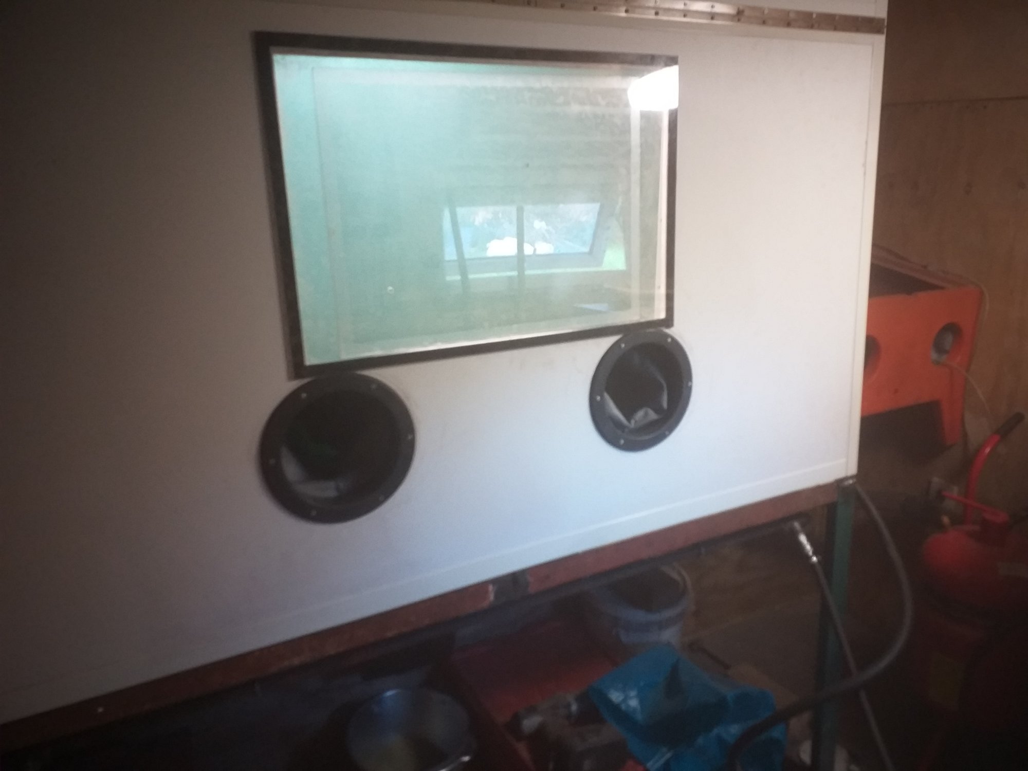

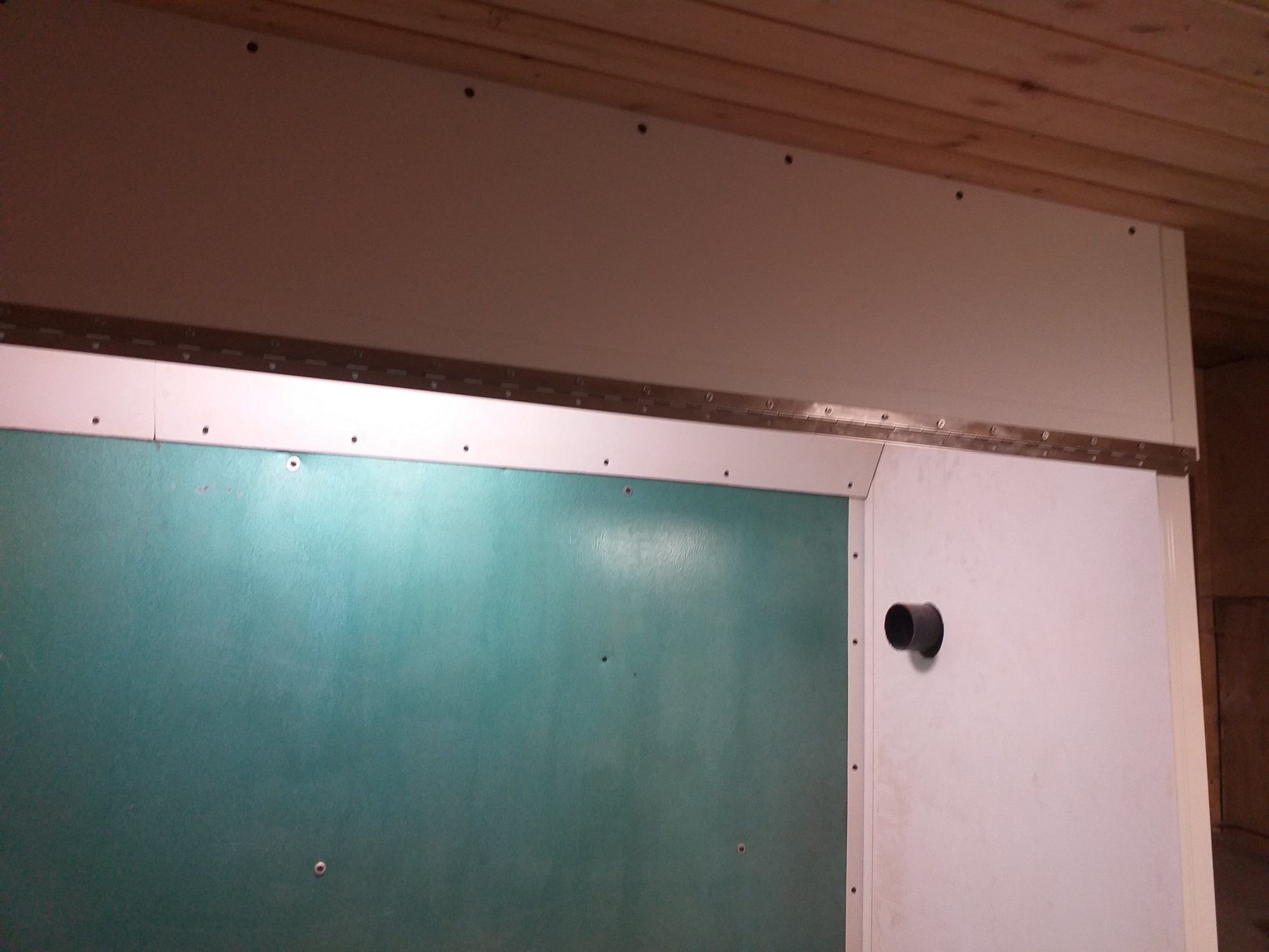

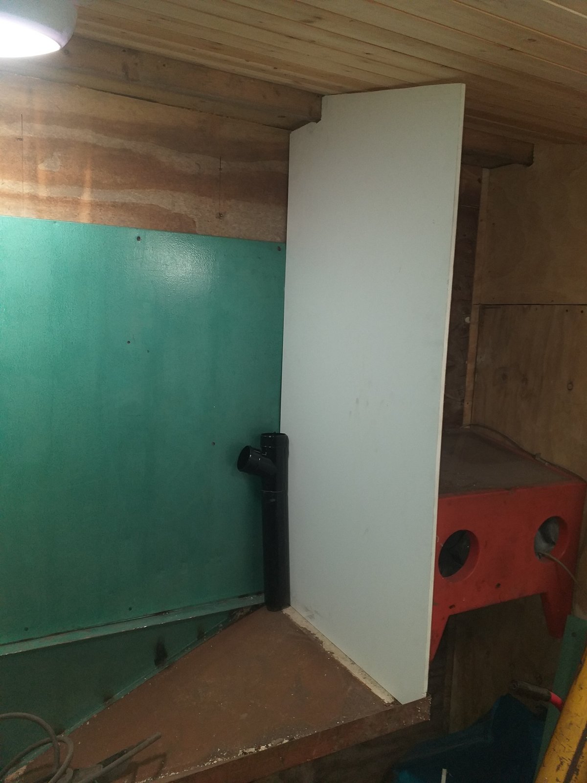

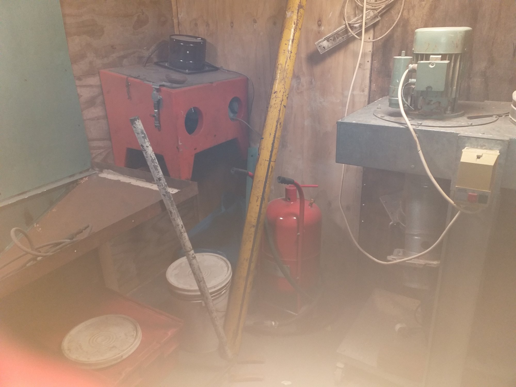

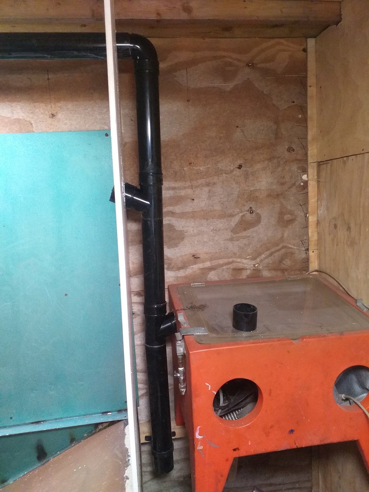

Thought I had better start a thread on my shoestring home blasting cabinet / room, I have only ever had a small bead blasting cabinet before,

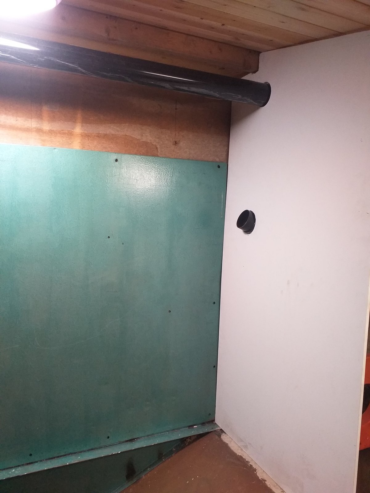

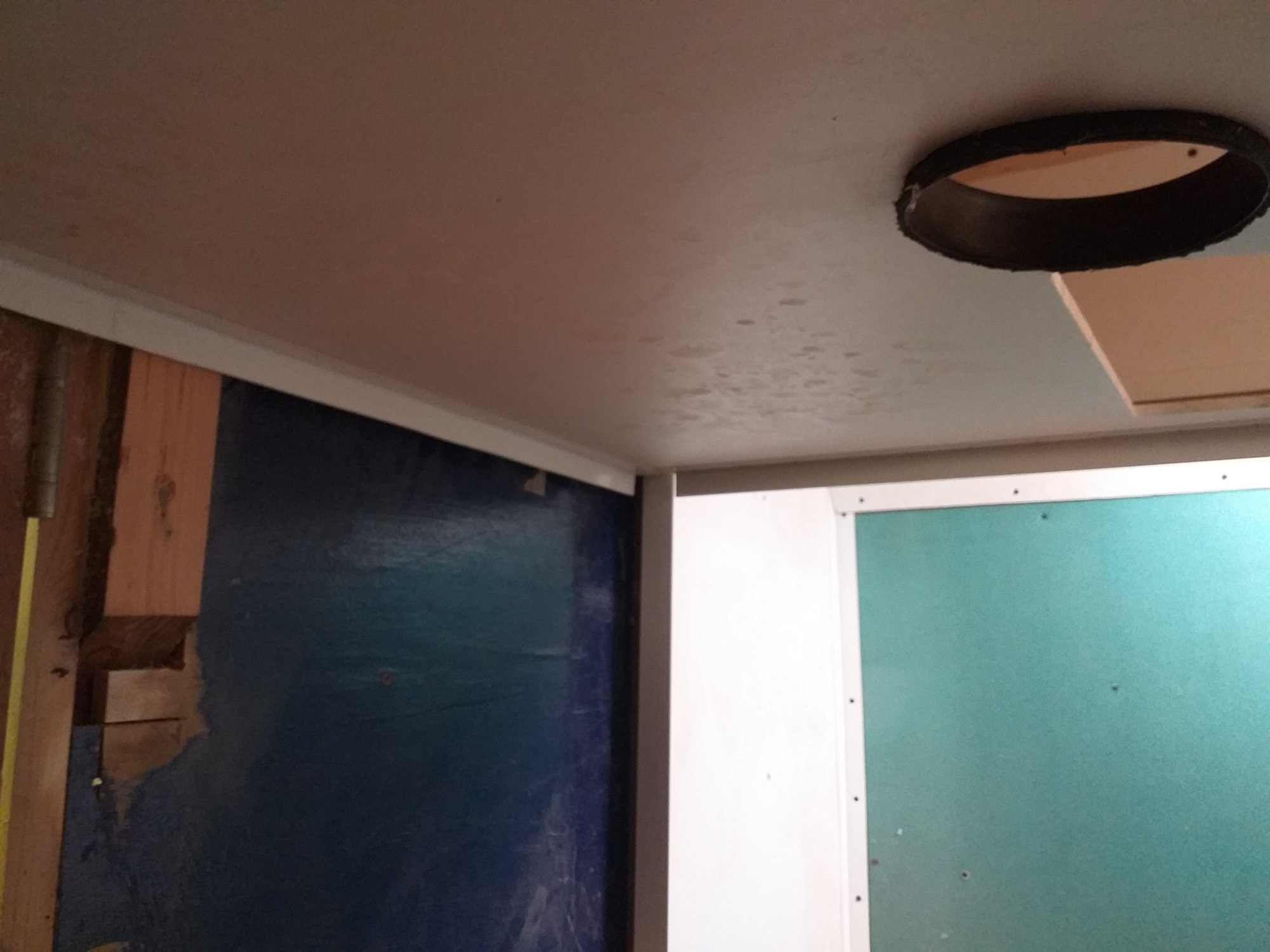

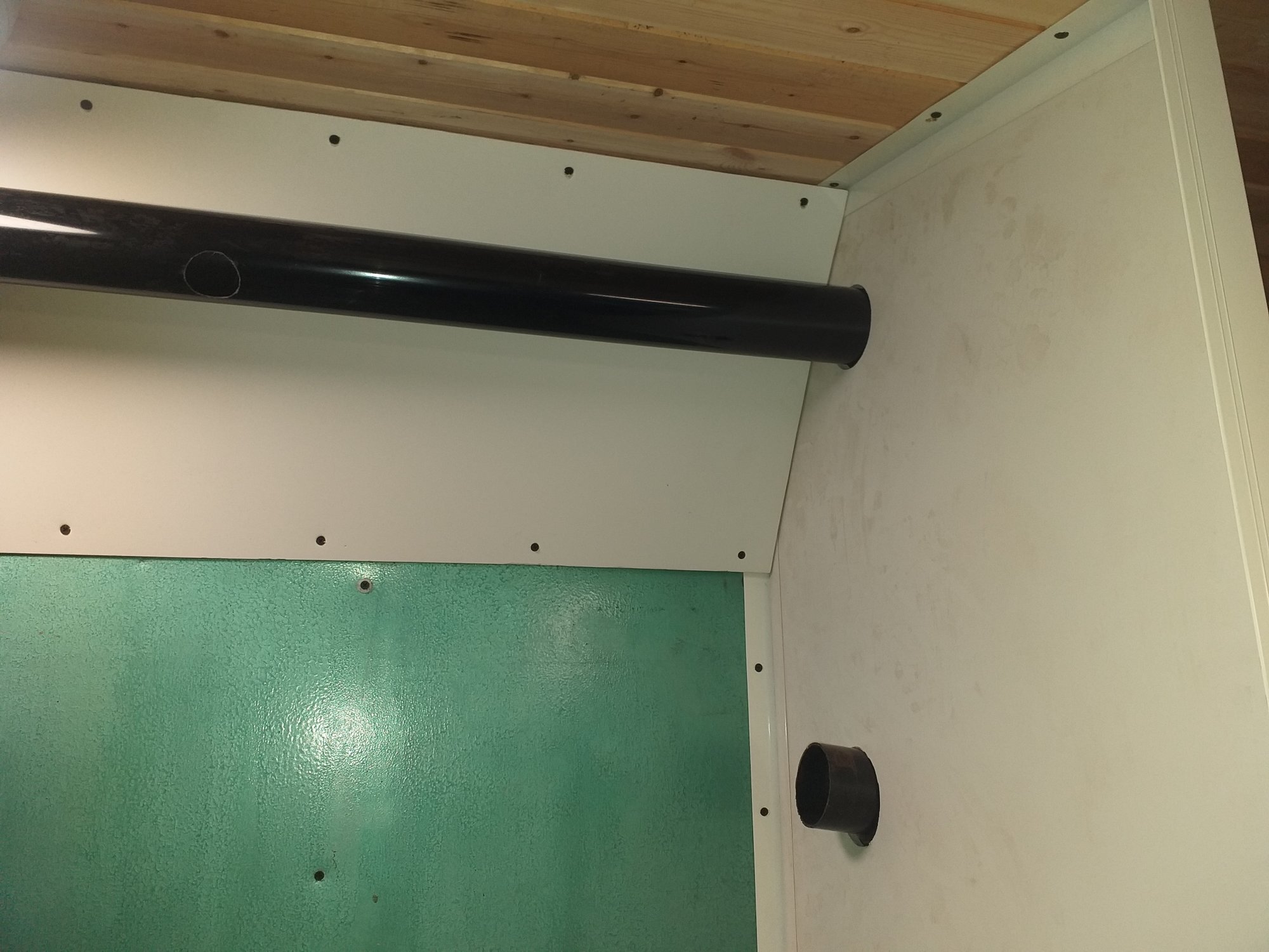

one question is where should I extract the air from? it is a tall cabinet, so I can get bike frames or say a Mk2 Jag boot lid in, I am thinking of pulling air from the middle of one side, with the option of top extraction,

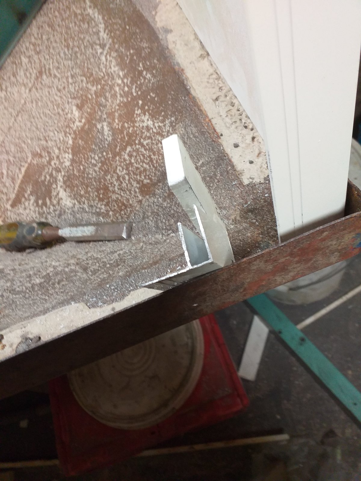

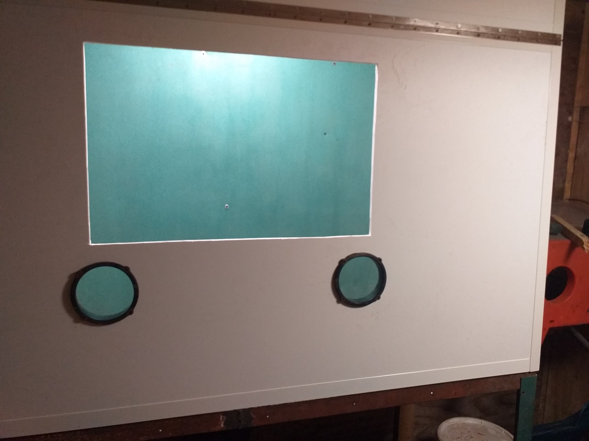

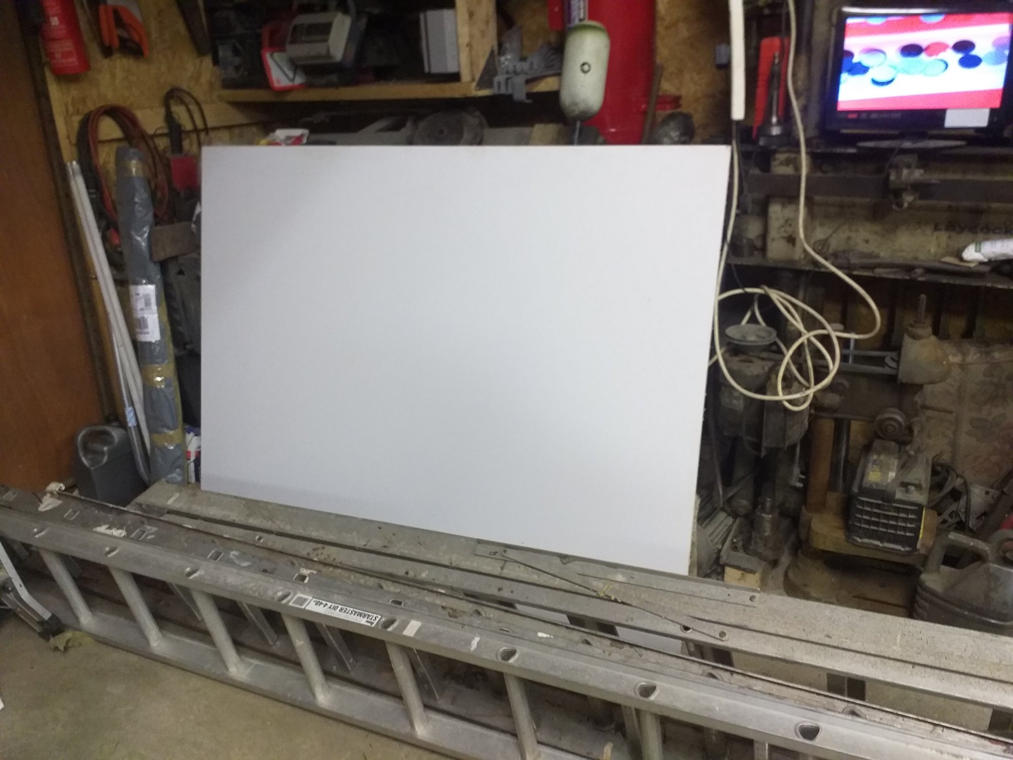

The front of the cabinet is made from 10mm foam board with alloy extrusion round the edges for a bit of strength, to keep it light, I intend to hinge it from the top so I can easily open it for loading,

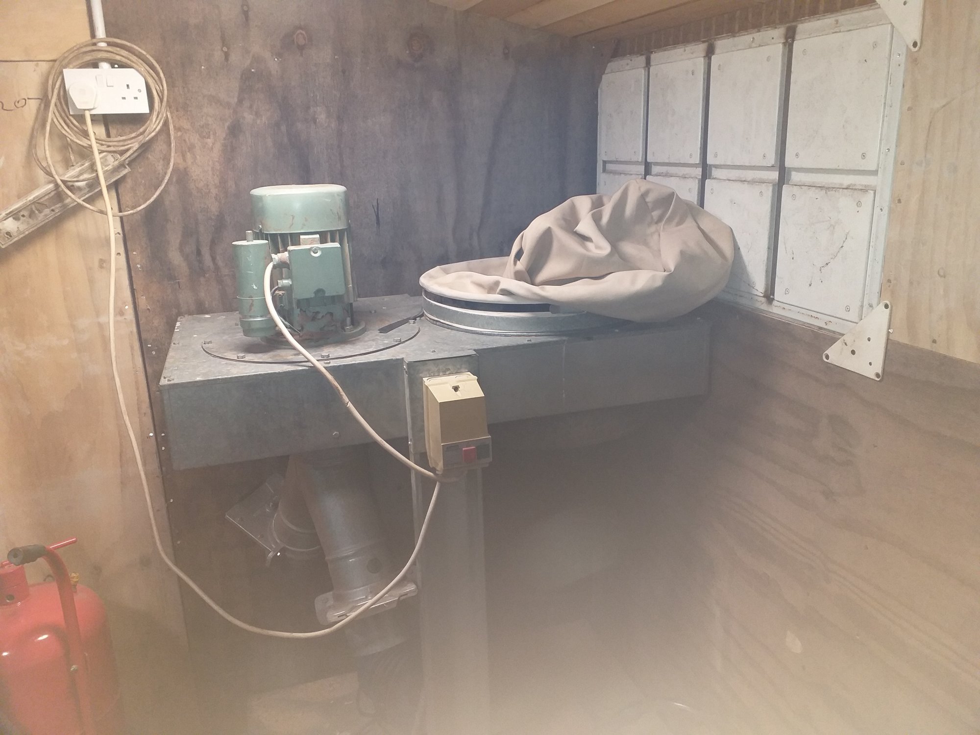

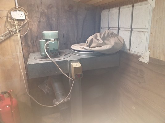

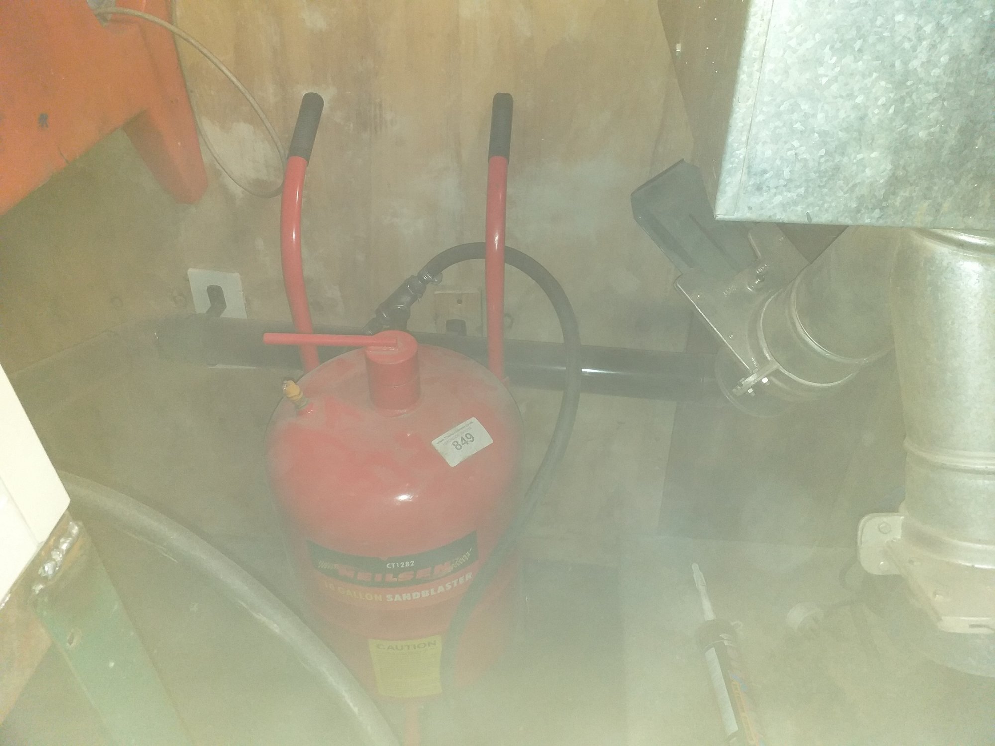

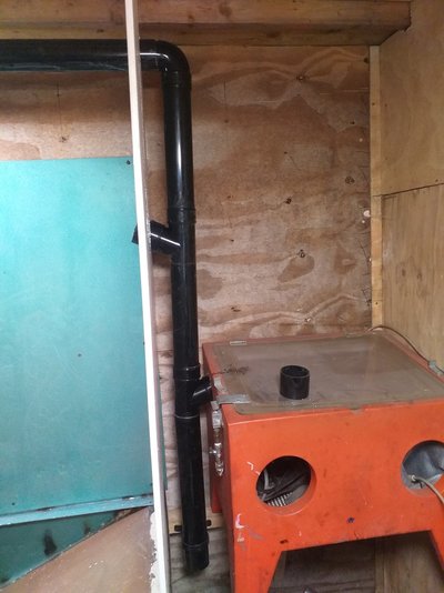

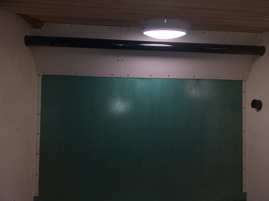

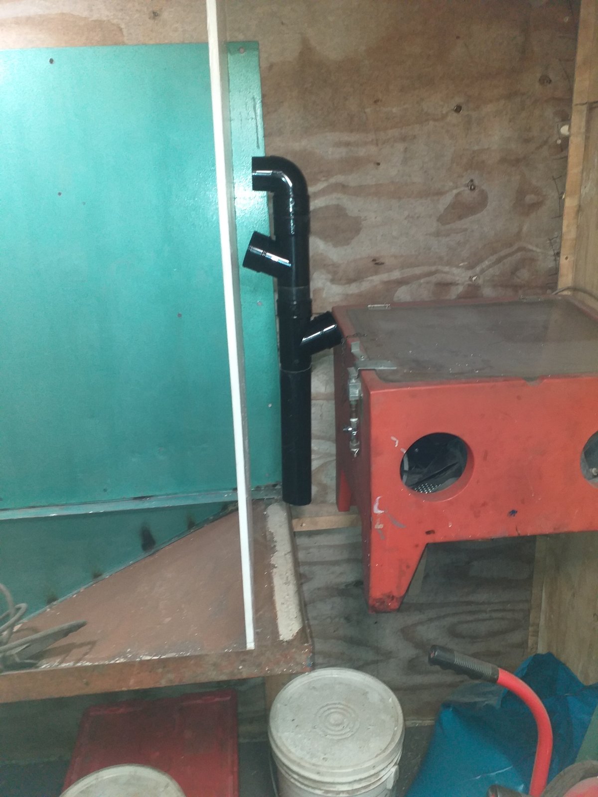

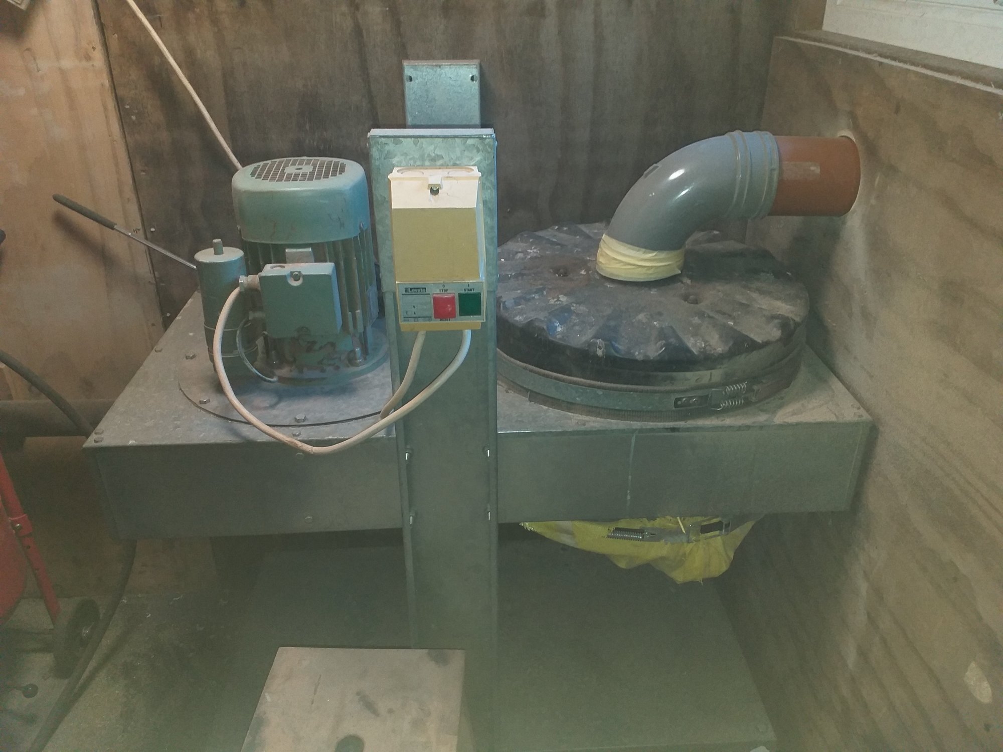

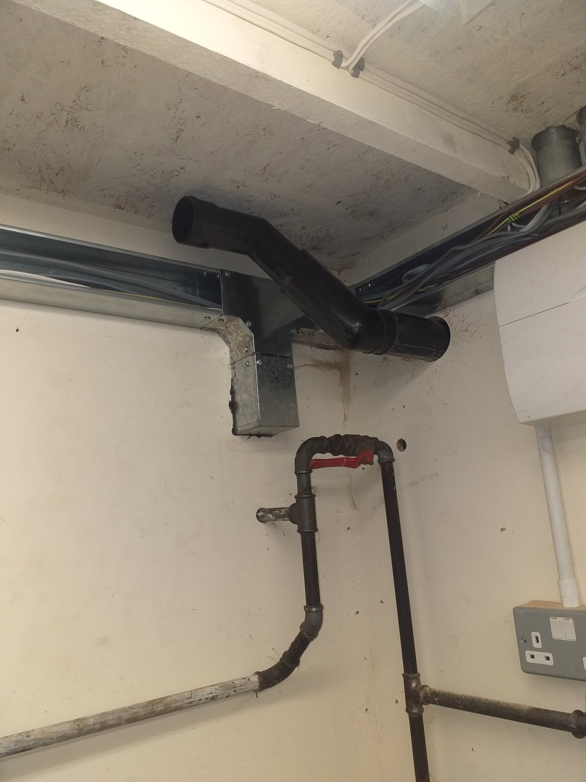

I have the ebay woodwork dust extractor and will be running 70mm rain down pipe to it, I will also carry the drain pipe across the top of the cabinet and into the machine shop next door to provide fume extraction for TIG welding, the pipe across the top could have a cutout with a sliding cover to regulate the extraction,
The rain pipe is just showing the general idea, it will go to the top before turning left,
wish me luck, comments welcome

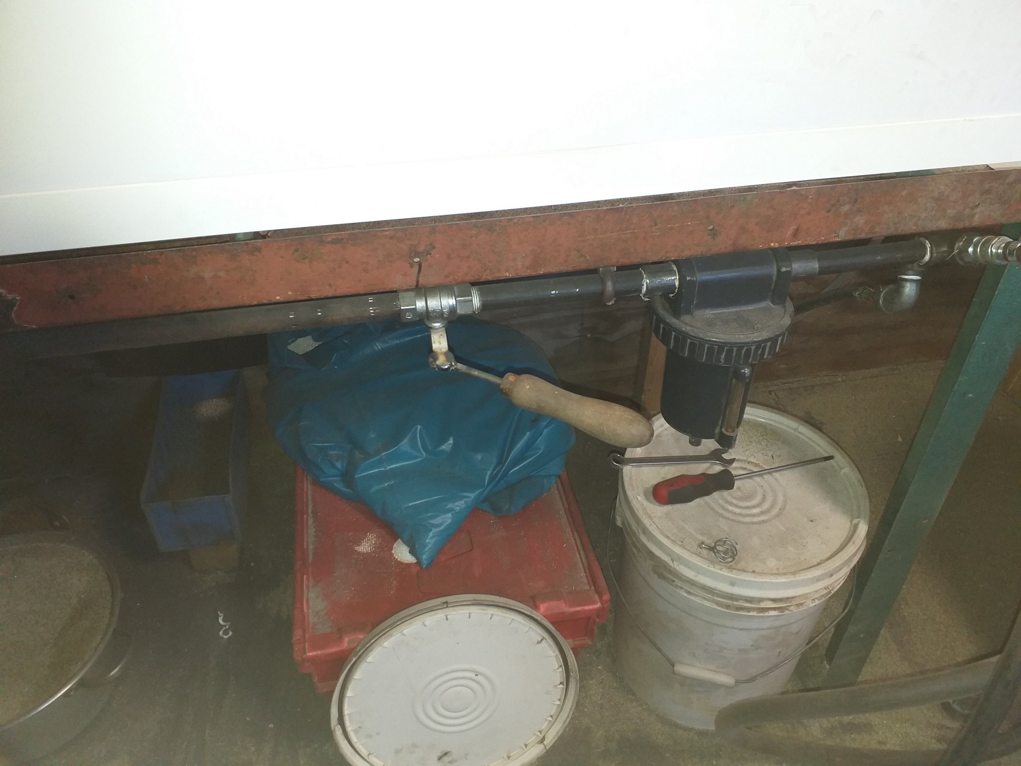

everything ready made

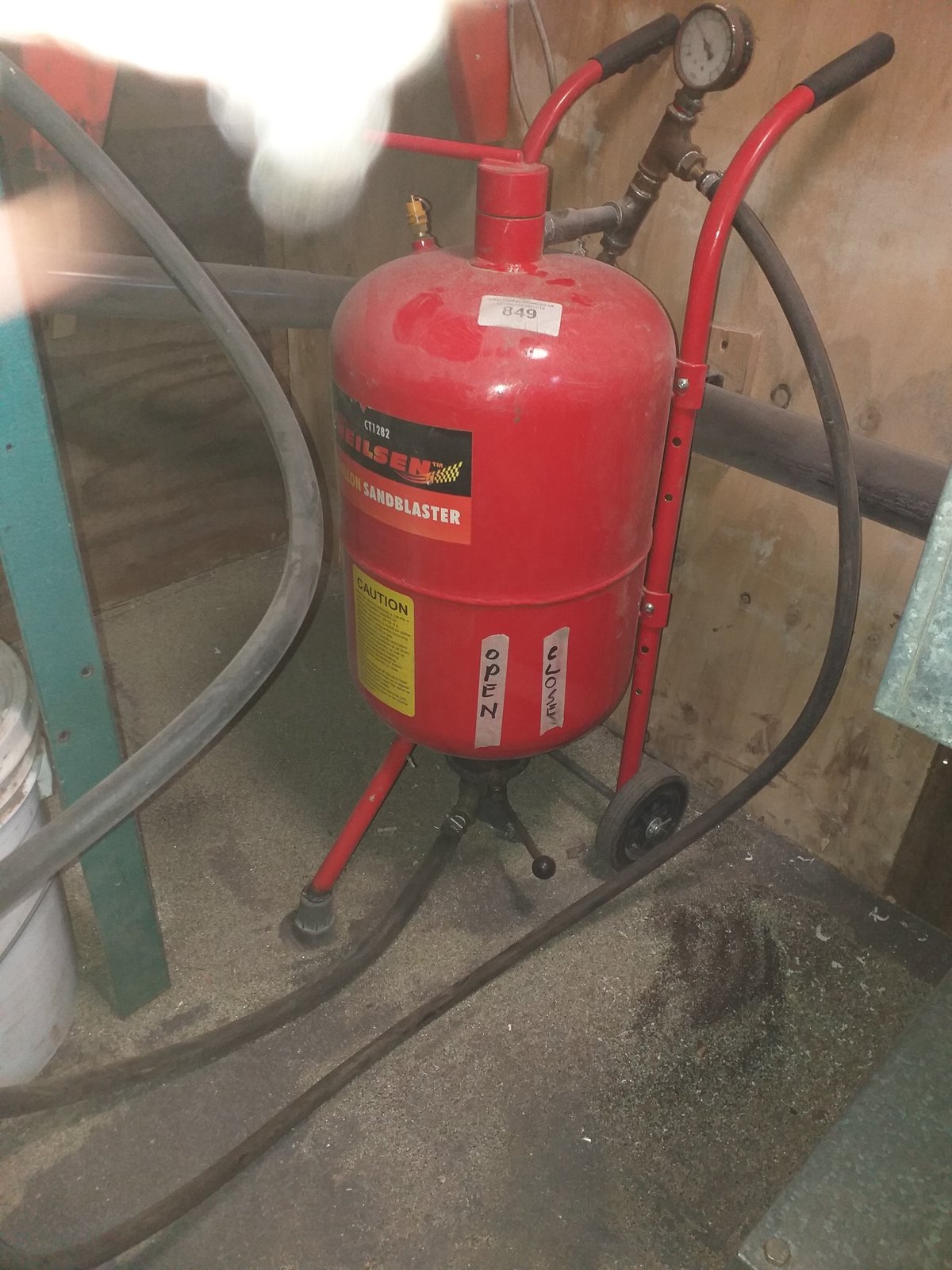

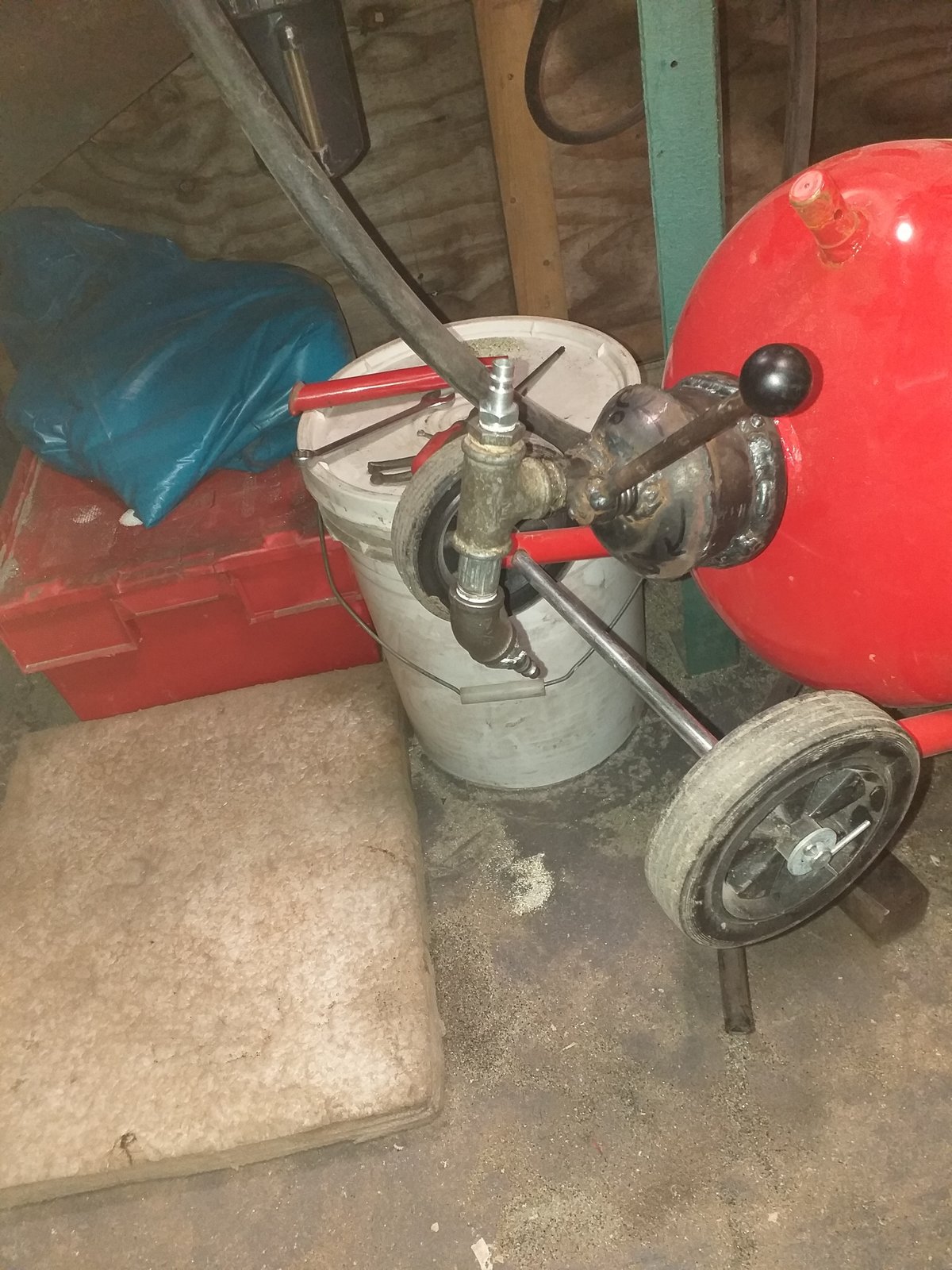

theres about half a cupful in a 25kg bag that's 2 big and knackes the job up if I don't are u using a ball valve for the media if so there crap and nothing but trouble the correct size media sieved with a decent reg u can run all day without altering it
