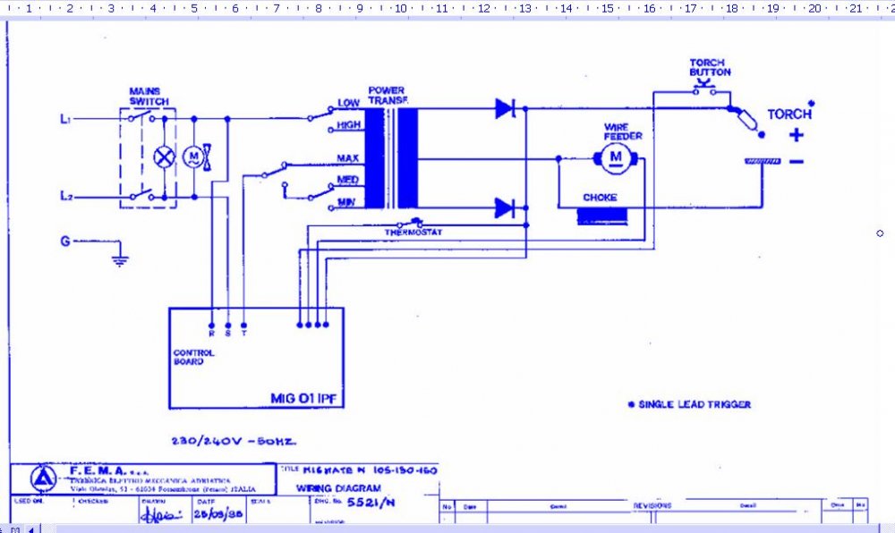

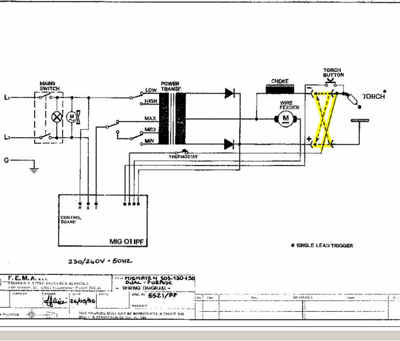

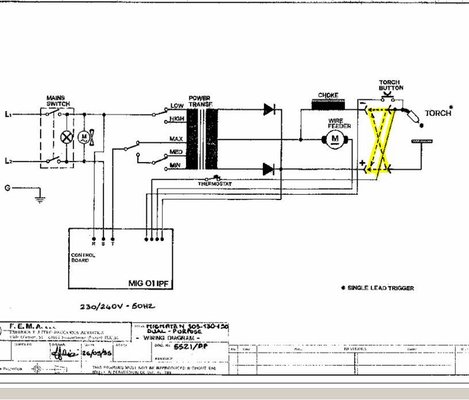

H HairyDubber Member Messages 23 Mar 8, 2014 #1 I'm wanting to conver my 150 mig mate to gasless it isn't a universal machine, does anyone know if and how this can be done cheers

brokenbiker Member Messages 10,436 Location Llanbobyll, south wales Mar 8, 2014 #3 it is pretty much just swapping the torch and return connections, remove the gas bottle and load in some self shielding wire.

mike 109444 Member Messages 4,715 Mar 8, 2014 #4 First pic is like what you have Second is what you are trying to do (the yellow dashed lines) pcb.jpg 77.4 KB · Views: 141 sip circuit g_g less.jpg 65.4 KB · Views: 134
