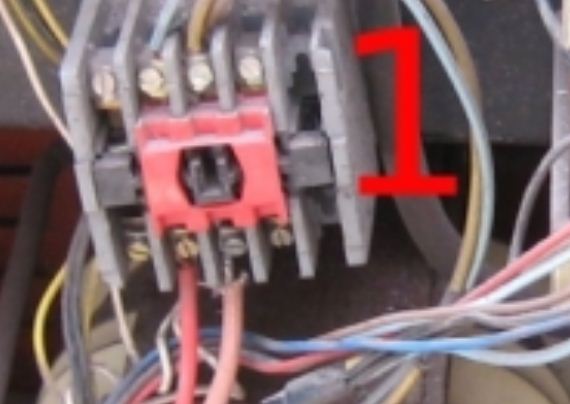

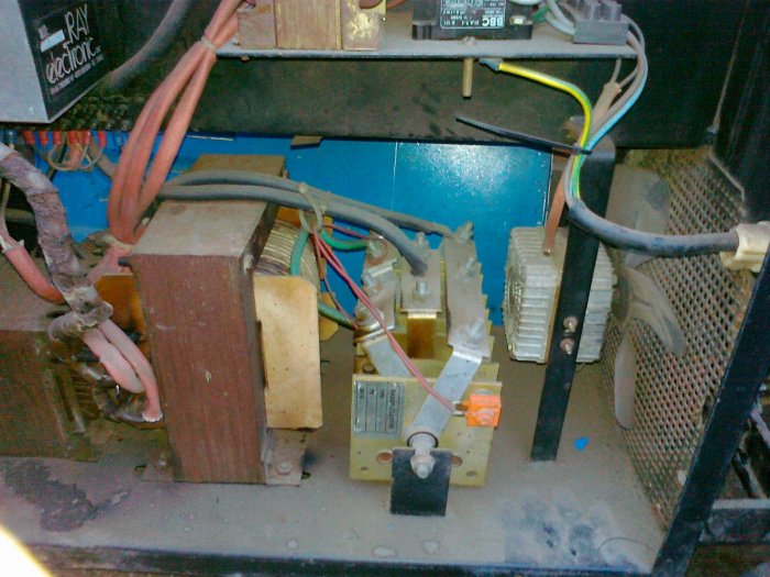

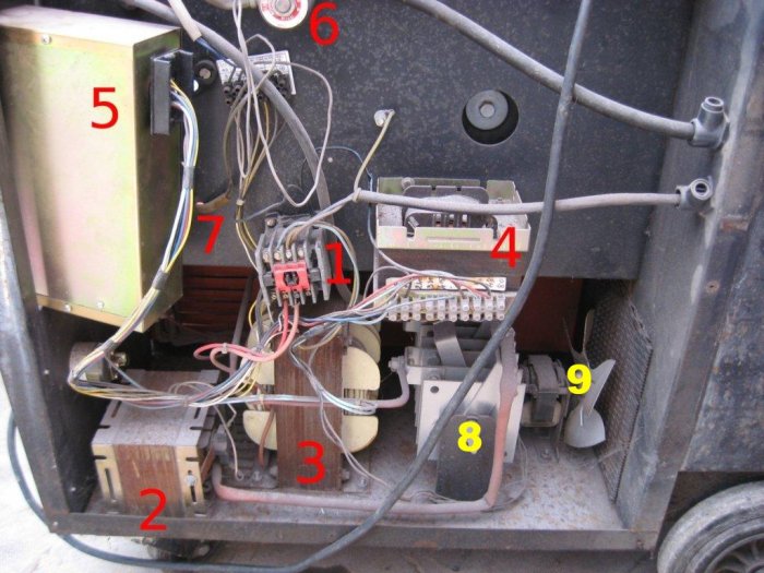

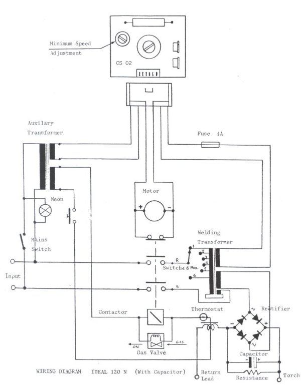

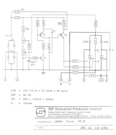

Mid-weld it just stopped and paying a bit of attention shows that it has blown the little 5A glass fuse mounted on the control panel. Replacing the fuse restores the light, but as soon as the trigger is pulled the fuse pops again instantly (before any clunky clunky relay sounds or wire/gas being fed). Spent a while searching for similar issues with no real success (other than it may be the rectifier/PCB/feed roller) so it's time to beg for advice.
I've pulled the torch apart to check the contacts and tried it with no wire in and the feed roller undone, both with the same result. Pulled the control box out and looked for any signs of burnt out pcb (long shot I know) and dropped the side of the MIG to check inside for any loose wires, so now I'm at the point of staring at it and sucking my teeth like a builder who's about to give you his estimate
Can anyone point me in some kind of 'do this,test that' way forward please?
