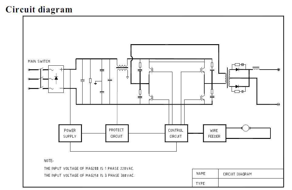

Hi guys ... my sip ideal 303 has developed a fault today. Would anyone have any ideas.. when i push the wire feed button the wire comes out as normal.. but when i pull the trigger it dosent go at all. Have tried 2 torches an also tried a bit of wire in the euro connector with torch removed.. only the gas comes out but no wire feed.. im not sure if its wire feeder itself or a fault on a board.. another thing i did notice is if the wire is sticking out the nosel slightly an i make an eart to the table it will weld but the wire feed seems maxed out... any help would be great.. thanks
