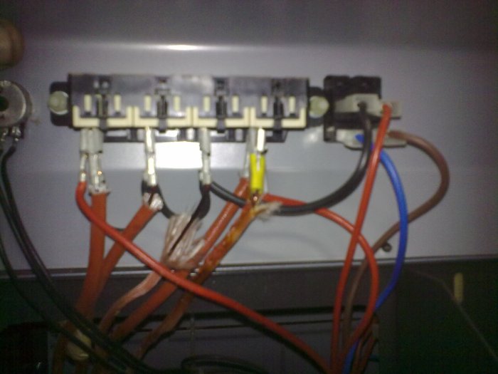

I am trying to fit a gas soloined to a 90's migmate super i am trying to find the neutral wire & the wire for the voltage selector switch enclosed photo of wiring.
assuming it is trace the power cable and take a neutral from that and the positive side should come from the relay that supplies power to the welding transformer when you pull the trigger
