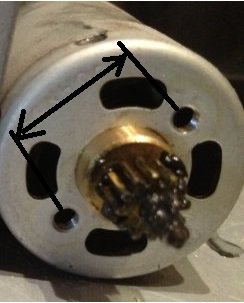

this is the motor, should I check voltage before fitting a new also am I able to service the welder or is there any known issues I should watch out for?
if you have a meter then worth checking that voltage changes when wire speed knob operated.

Have you sorted a supplier for a new motor ?
ps while you have the motor out can you measure the distance between the two mounting screws as in pic Ta and if possible the outside diameter of the motor.
