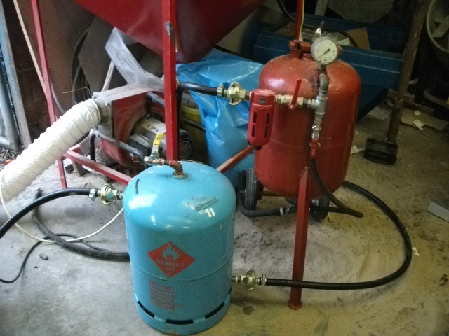

I've got a large Ingersol Rand compressor (ex industrial that I'm converting to single phase). The tank is big ( could be 150 ltrs ?) and the motor / pump is on a seperate frame bolted to the tank. Shortage of space in my garage means I'd been considering making it into a vertical cylinder format then had another thought - why not site the actual tank outside but keeping pump, motor, valves, electrics etc inside
After all LPG tanks are outside and have pressurised contents. Accepted it's need a decent coat of paint but is there any reason why not ? I'm thinking a small, say, 25ltr tank inside for pressure switch etc and the large tank fillable via a valve so if just small volumes of air needed then only the 25ltr tank filled.
Thoughts ?
Thanks.
