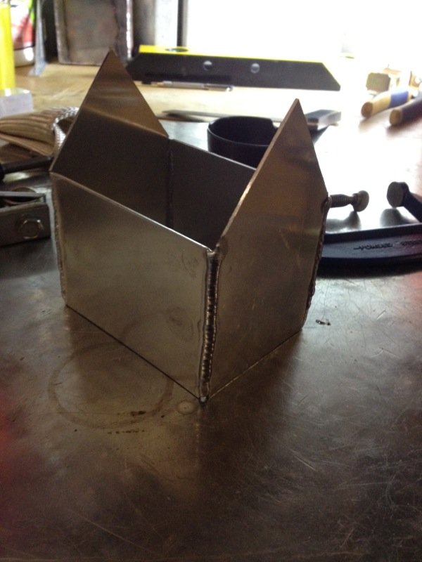

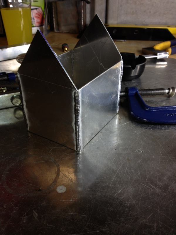

My little one has been given a project to do for school. It can be anything, but has to involve light and electricity, so she asked if we could make something with the welder.
We decided to make a simple house from 1.6mm aluminium sheet.
I let her do all of the marking out on card for templates, then she transfered them onto the sheet for cutting afterwards. I cut them out in the bandsaw, and them we tacked up and welded the majority last night.

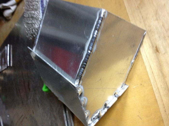

This was my first Alu sheet project, and I was quite pleased with how it welded. I used aluminium box section as a backer and guide piece to clamp at right angles and it really helped to stop the heat getting out of control.

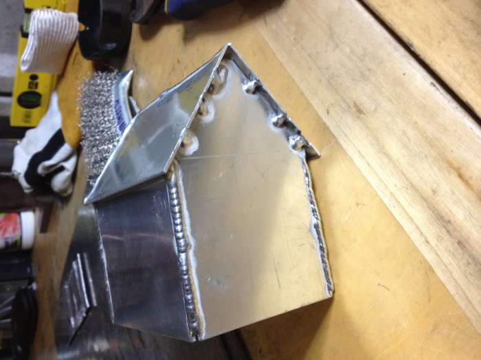

We will weld the floor and roof pieces on later
Excuse my ignorance, but what's a Bid box?

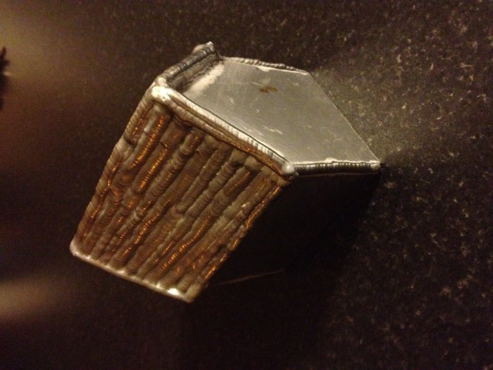

I think i'll cut a slit in the roof and hole saw a piece out of the bottom before welding up. I'd have had to cut a hole to stop it blowing out at the end of welding anyway (learnt that one the hard way!). Think I've even got a little rubber bung that will work too for filling afterwards.
