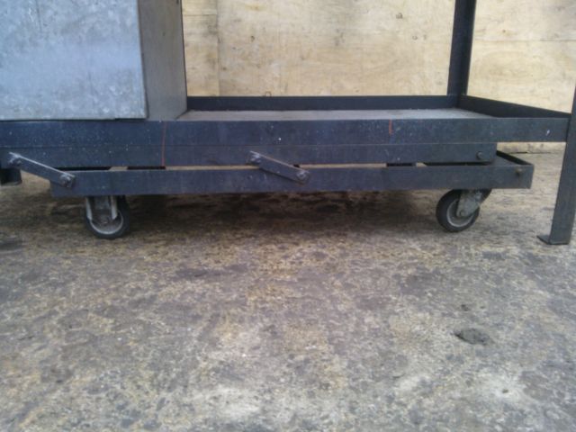

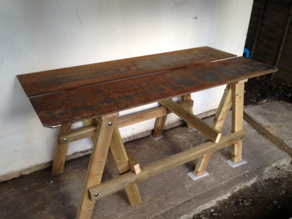

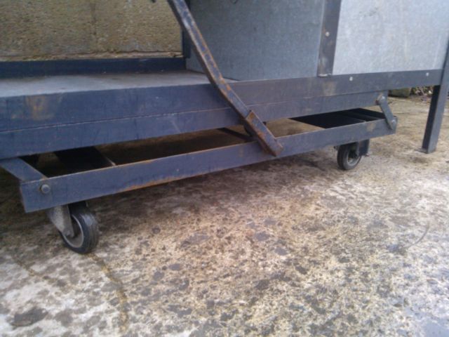

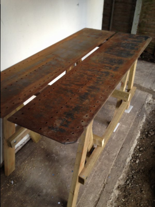

I'm not too bad with my Mig nowadays so time for me to make a decent Welding bench for my garage.
Its my first Welding project I started last week.
There is Not much room in the garage so it had to be sized accordingly.
After some research and trawling through some threads on here I bought some materials and set into action.
Used 10mm plate for the top and 40x40x3mm for the legs and supports was square hollow section I found in the college skips..also added and ground point at the front.
I added support in the centre for to avoid any warping in the future. Probably added more weld than needed really but hopefully that will not be a issue.
few pics I took.
Still work to be done as I want some casters in the future and possibly some storage for grinders and disks etc..
Any advice as to where i can get reasonable price on set of casters? Or a link? Seen them on amazon but I'm not convinced with them.
I hope the pics work as took what seemed a age to sort out.
Any comments welcome.
