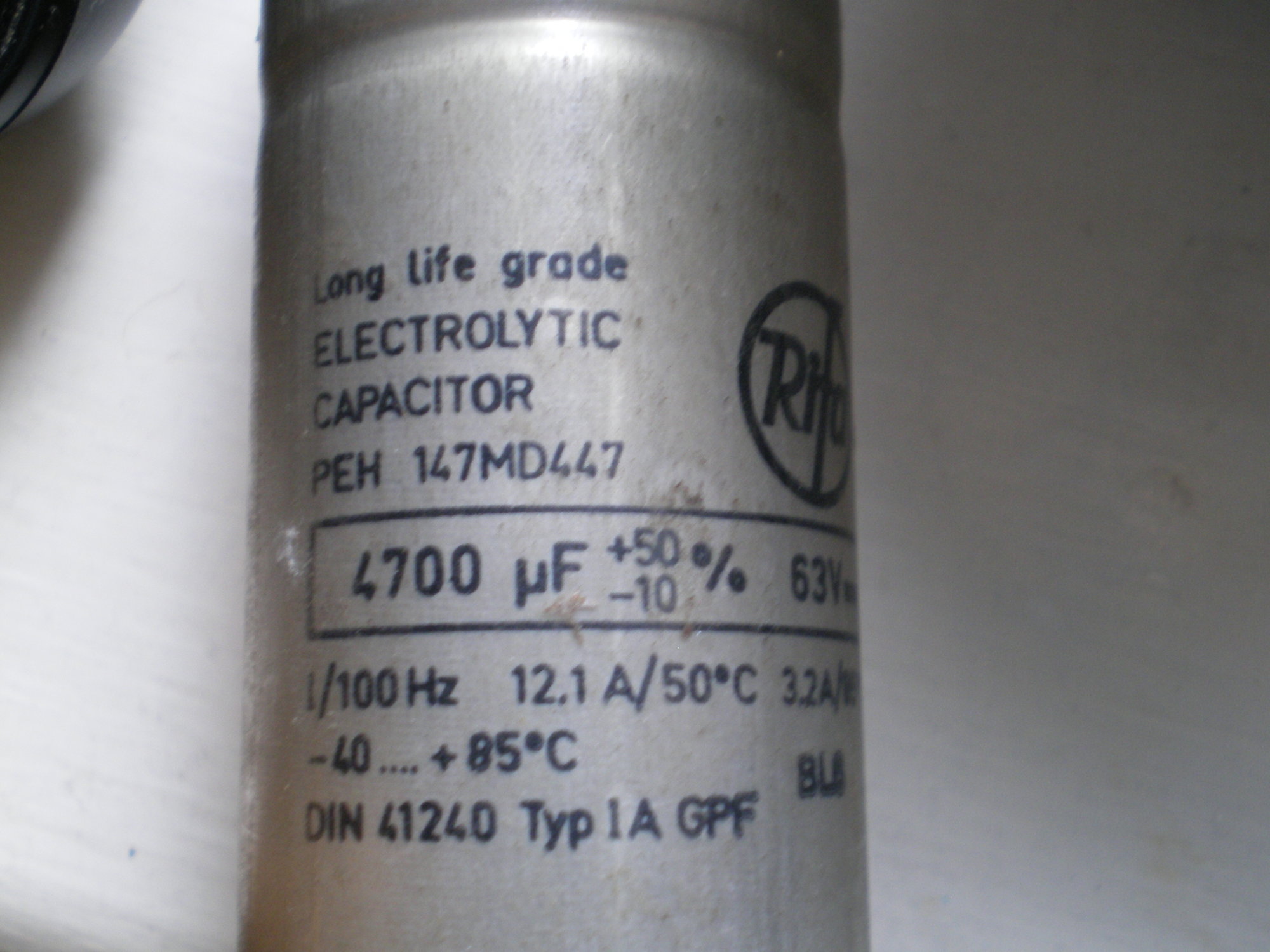

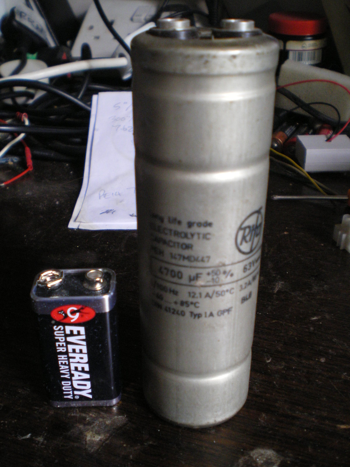

I want to experiment further with my Topmig 150 by fitting capacitance between transformer and choke as the better welders have. I have 12 of these caps which are 4700uF and 63v but not sure about the other specs and if they would be suitable.
I would like to connect all 12 in parallel for a total of somewhere around 55000uF.If I understand previous posts it is suggested using a number of smaller caps is 'kinder' to each one so would these be likely to survive?
Thanks
John
