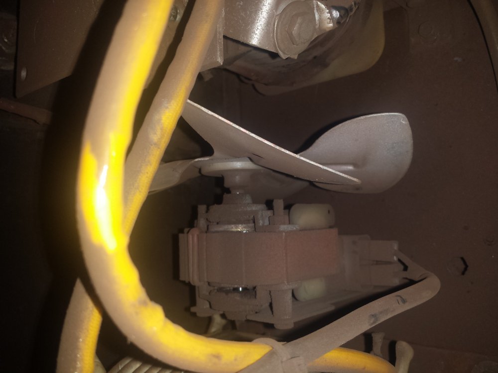

So im in the process of selling this welder off, as its surplus to requirements now.
had someone come look at it and say the fan sounds like its on its way out,
any idea where you'd get a replacement (just something that would fit ..)
Or could you just wack any old same voltage fan that fits in the space and hook it up? I know nothing on electrics but I cant imagine a fan being much of an issue ..
I used a fan from an office fan heater that had been scrapped. Tried it for size and mounting holes lined up so it must be a pretty universal model used in a few things.
In the with the same welder?
Heres a video of the sound, this is how its always been the last 2 years I've had it so I'm not actualy sure if its normal or not.
The fan moves a little back and forward and the bracket thats holds the fan has a little play in it too.
