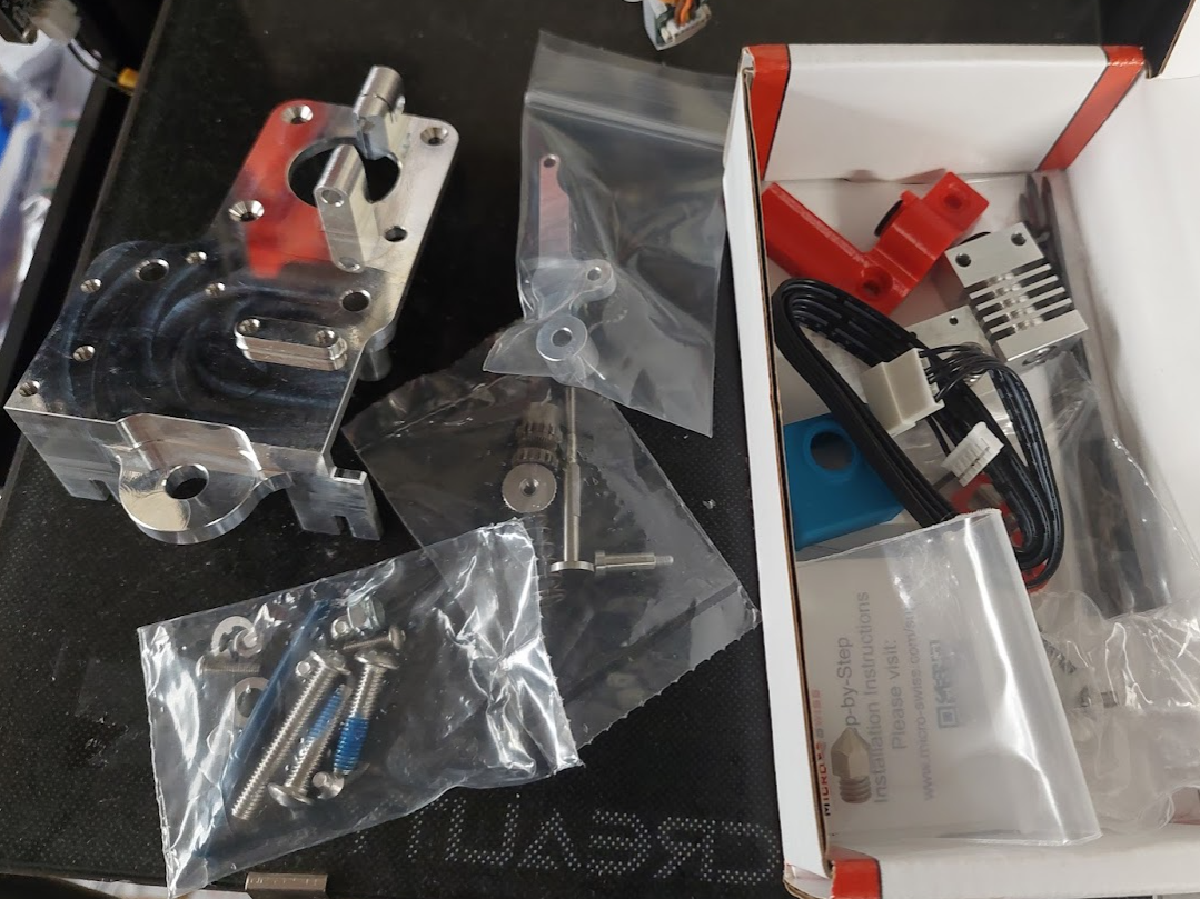

Here's the collection of parts I've bought for this machine-

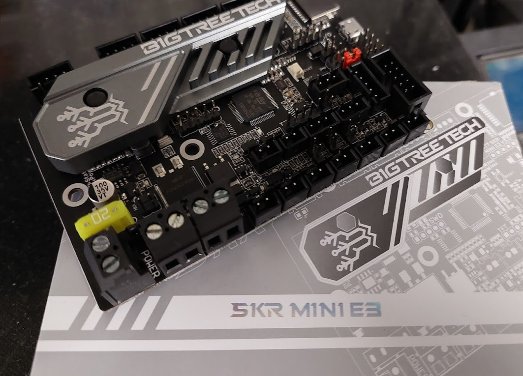

BigTreeTech SKR Mini E3 V3.0

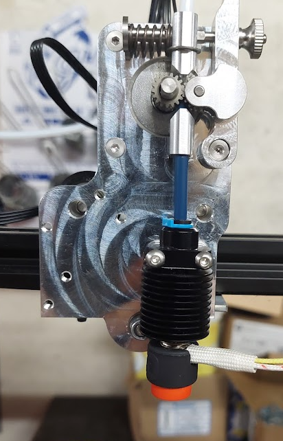

MicroSwiss Direct Drive extruder
E3D Revo CR hotend
Raspberry Pi 4
Touchscreen for the Pi
And not shown is a BTT TFT35 E2 screen, and a BL Touch.

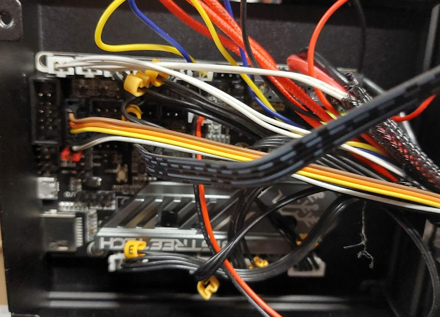

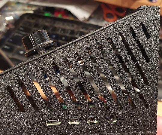

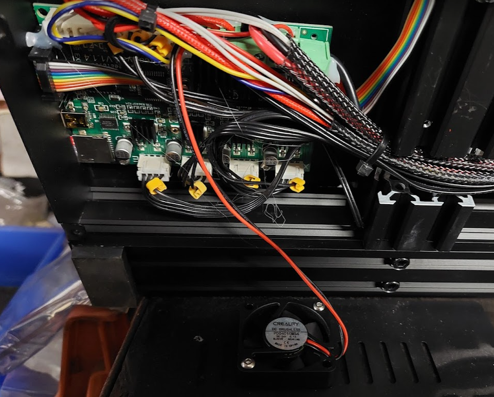

First one to be fitted is the SKR Mini E3.
A big complaint with the original Ender control boards, was they didn't have silent drivers. So whenever the printer was moving, it made lots of humming noises.
The BTT SKR Mini E3 boards, are pretty much direct drop in replacements for the original control board. I installed a V2 board into my other Ender 3, and it really was just plug and play.
This is the latest version, which comes with a nice custom heatsink.
4 screws remove the cover for the control board -
Then it's just a case of unplug all the connectors, swap them to the new board, and swap the boards in the housing -

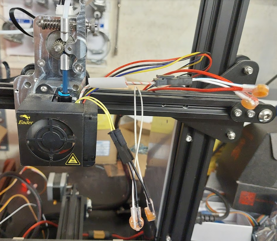

The only issue is the main hotend cooling fan either needs a connector fitted, or wired into a permanent feed.
On the original board, it's wired into a dedicated screw terminal, but the SKR mini E3 V3 sacrificed the space for additional plug-in headers.
I've just wired it in with the main 24V power cables for now, as I don't have any of the correct connectors.

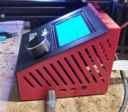

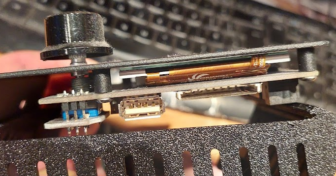

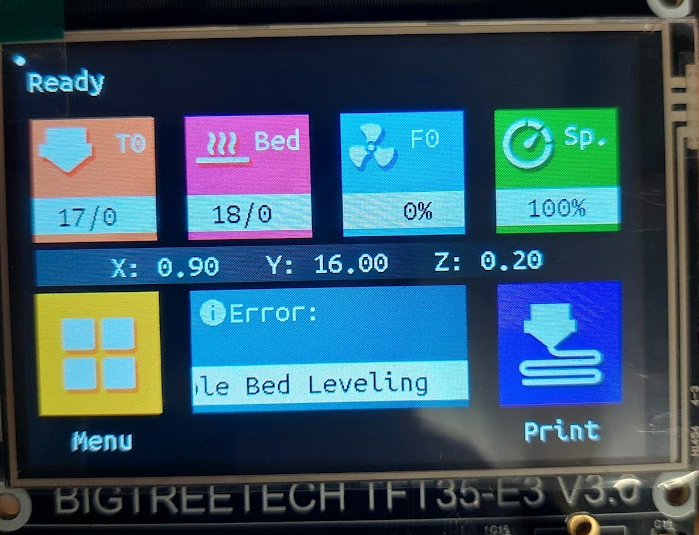

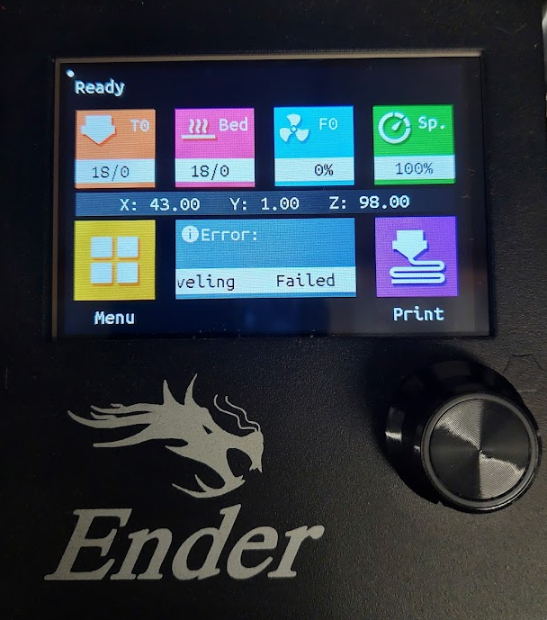

At the same time as installing the SKR board, I also put the wiring in for the new touchscreen display.
And prior to fitting the new board into the housing, I powered it up, to make sure it works -
The main reason for the new display, is it's touchscreen, so it makes usage a lot easier.
It's also the exact same size as the original screen, and is a direct drop in replacement. If wanted, you can fit this screen to the original control board, it's not dependant on installing a new control board.

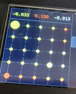

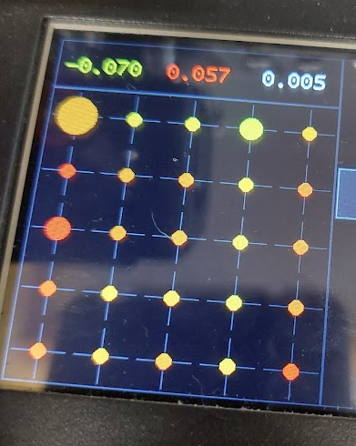

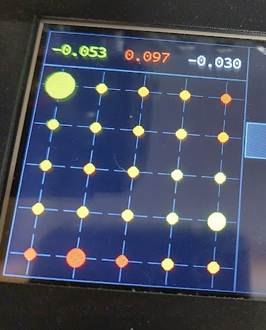

Once everything is fitted in place, and the covers back on, check it all still powers up, and things can be activated/moved-

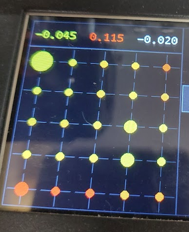

It is coming up with a bed levelling error, which I'm guessing is to do with the default settings in the SKR board, but the hotend works, bed heater works, all axes move, and the extruder works, so the core functionality is working how it should.
