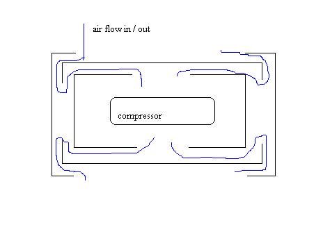

Go to your local carpet shop and ask for some offcuts of the high pile carpet. They usually throw away quite some carpet if a staircase is done. Carpet works very well.
Dont forget a box has 6 sides, the floor & roof are just as important.
Dont bolt compresor down, mount on pnumatic tyres (you can lock/chock wheels to stop movement)
