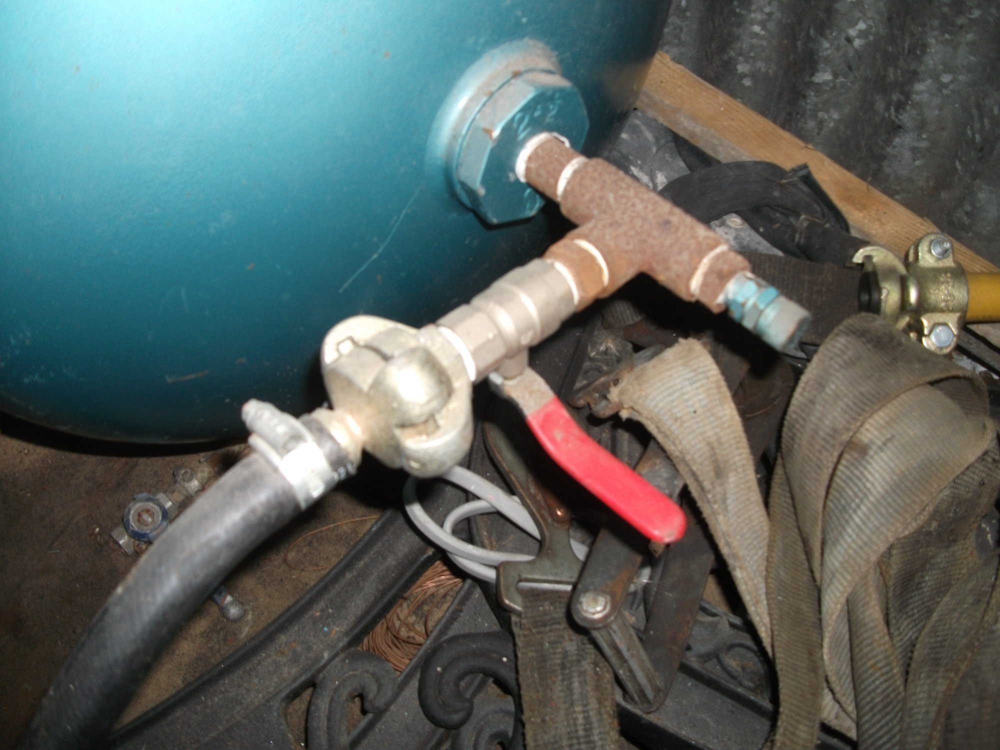

I'm planning out the air main for my new workshop, the plan, based on nothing much, is to go with the widest easily available pipework, and the John Guest 28mm aluminium pipe looks reasonably affordable.
Quite possibly massive overkill, I accept, but I don't want to be struggling to run a spray gun and air fed mask. I'm running two 3 hp compressors, one old school Ingersol Rand, and one semi decent Clarke, so should be able to supply enough free air to do this.
So that leaves a few problems, but the one that I'm struggling with is how to go from the compressors to the air main?
I think the standard fittings coming out of the tank are too restrictive, and was thinking of removing the large bung and using that to connect to the main, but I can't seem to find a large enough flexi hose. The biggest I can see is 22mm, and I can see no point in connecting that to 28mm pipework, might as well stick with 22mm.
Or is it a case of going to pirtek and asking for something to be made up?
Am I overthinking this?
