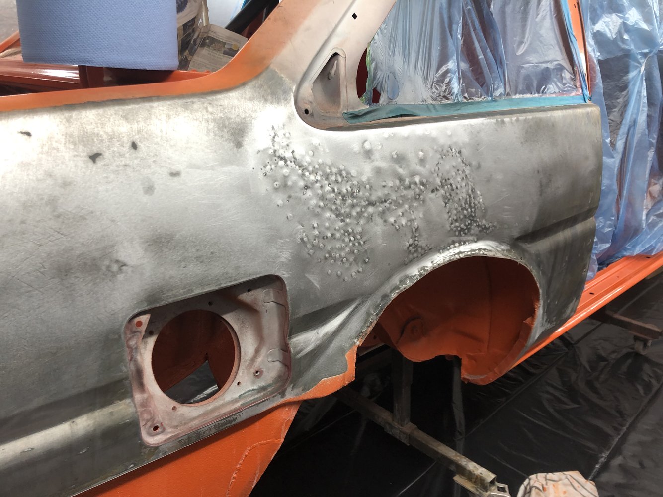

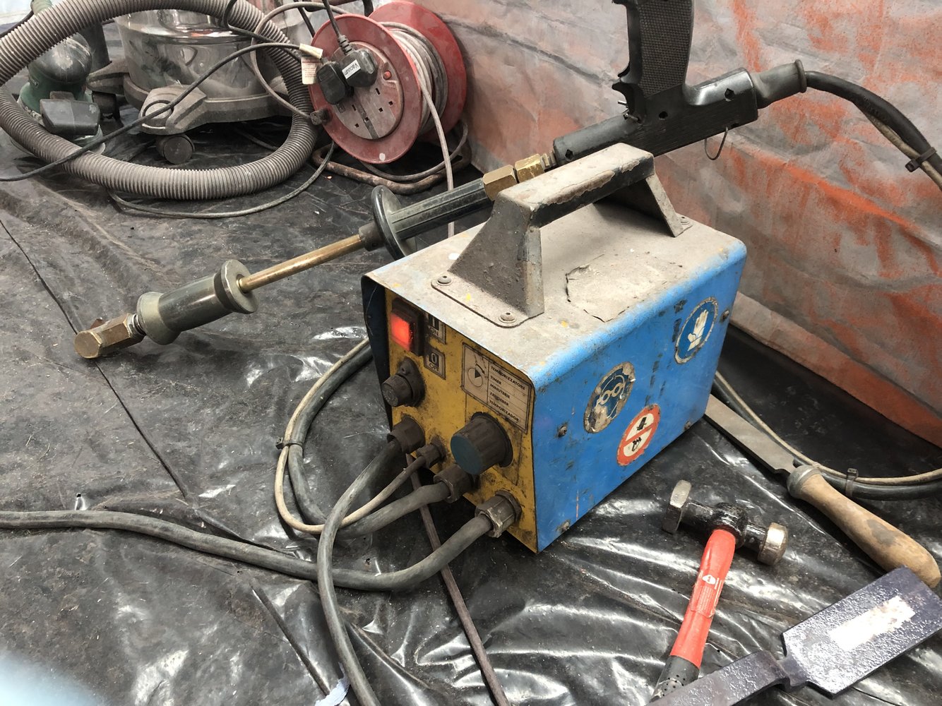

I've been given a spot weld dent puller on loan to do a few little jobs on my car resto. Control-wise it has an on/off switch and a dial (a timer). It's the type with an earth lead and a slide hammer on the positive side with the three pointed star on the end. Can't remember the make at the moment, but it has proven quite handy with pulling a dent on the sill, where I had 'peeled' it open and it had work-hardened when I bent it back. I was using it to do some shrinking on the rear lamp panel with some success, when, after sharpening the business end (on the advise of the lad who lent me it), with a shower of sparks it blew a hole in the panel
. I wonder if it was too sharp? Fixed amount of current through a smaller area?
