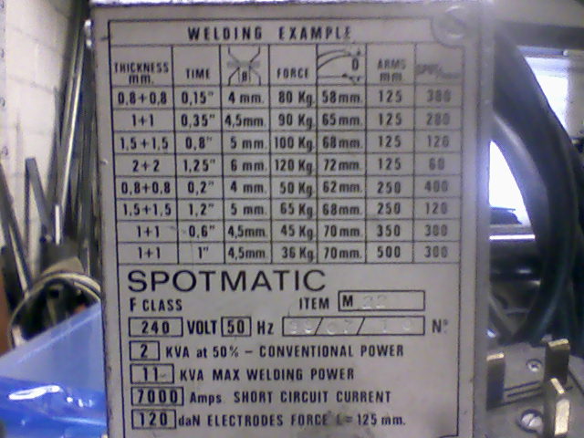

Ok so I have managed to get hold of a spot welder, it's a trangle 240v spot welder.
It has a lever on the top which pulls the copper arms together and a black button.
When I clamp the arms together and pull the black button back it powers up, how long should I be keeping the power on for say joining two 1.2mm panels?
Also any other useful advice would be great
