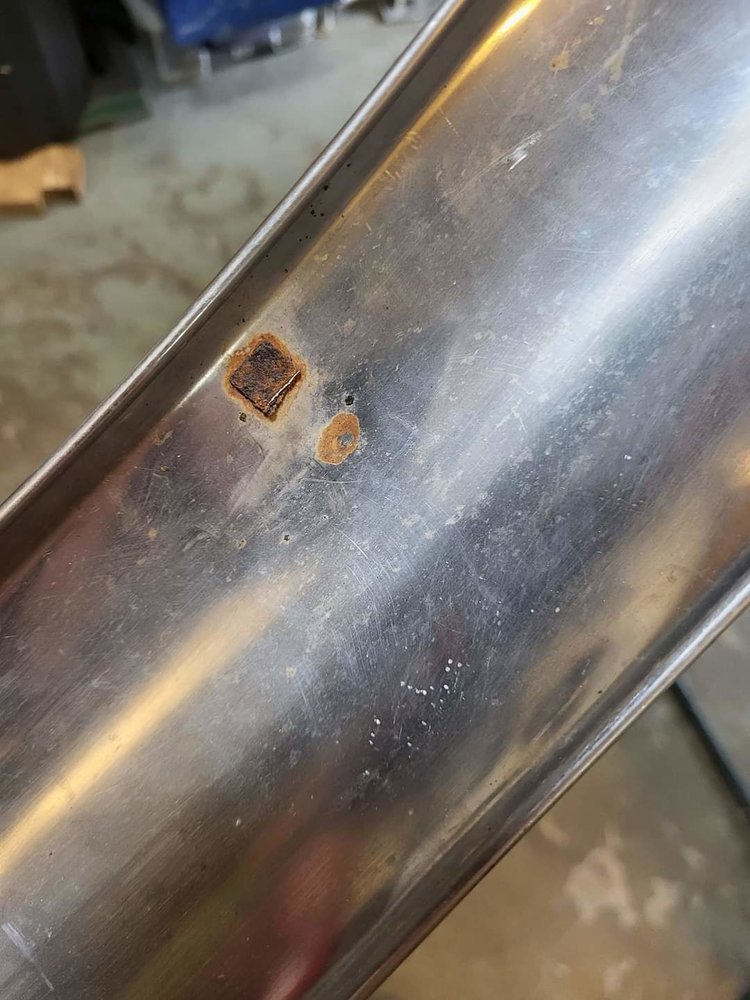

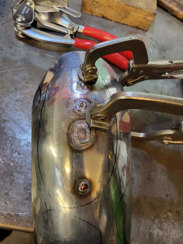

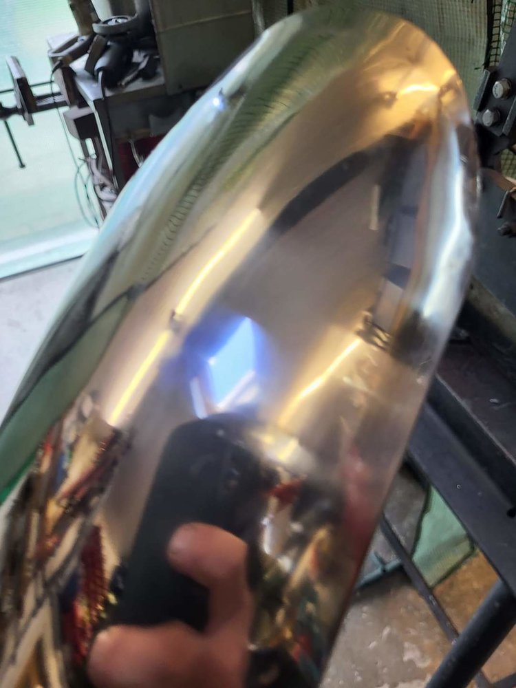

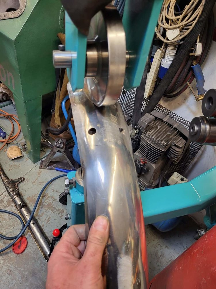

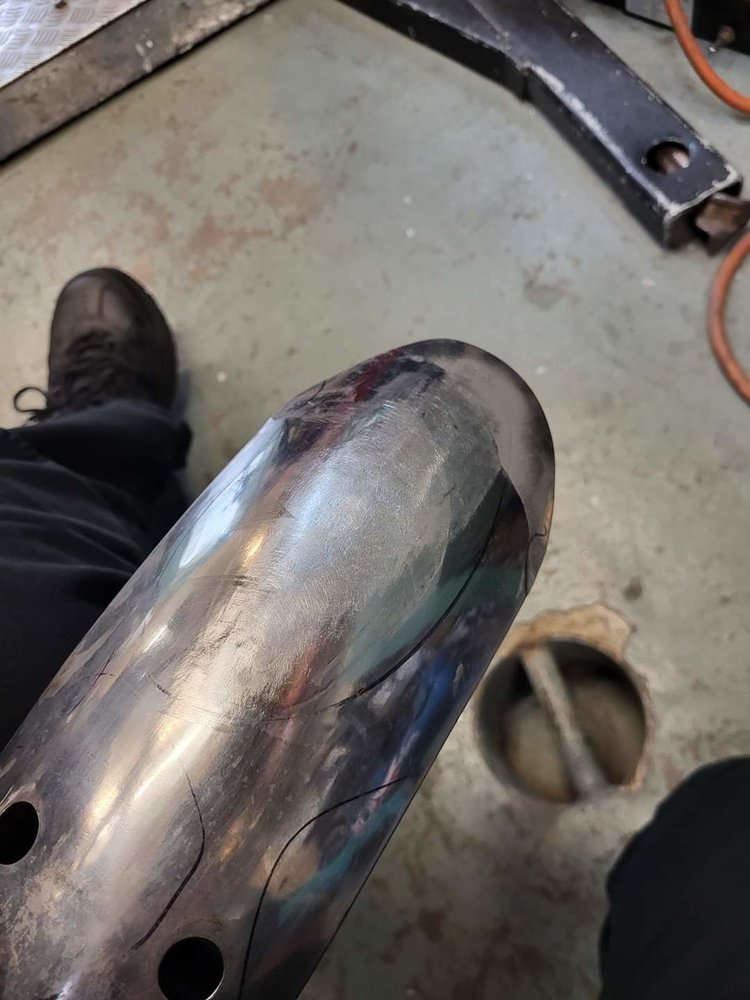

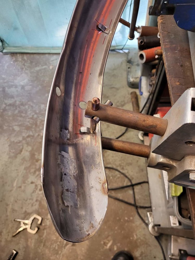

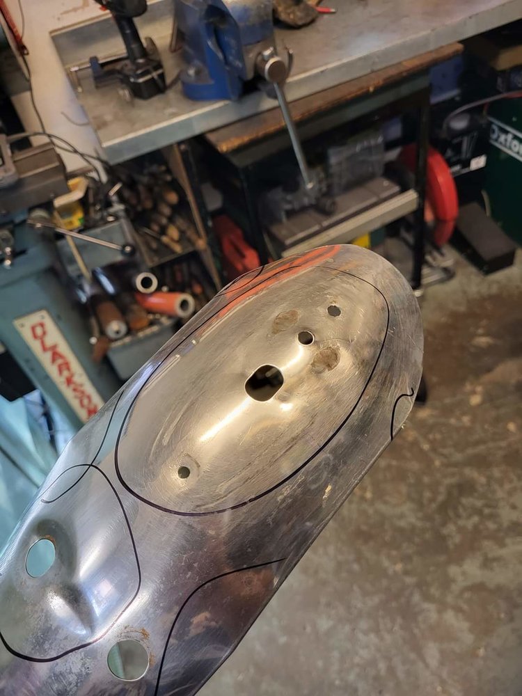

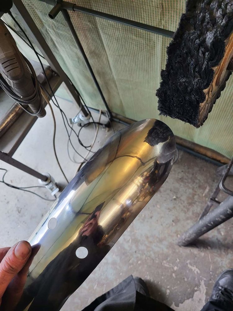

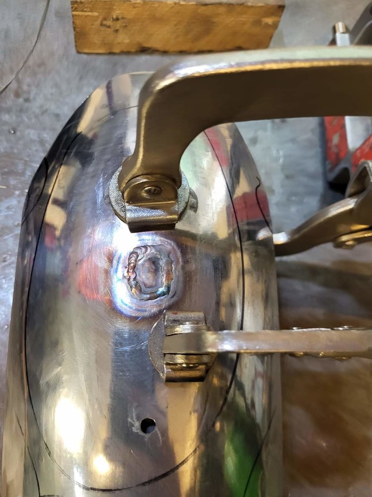

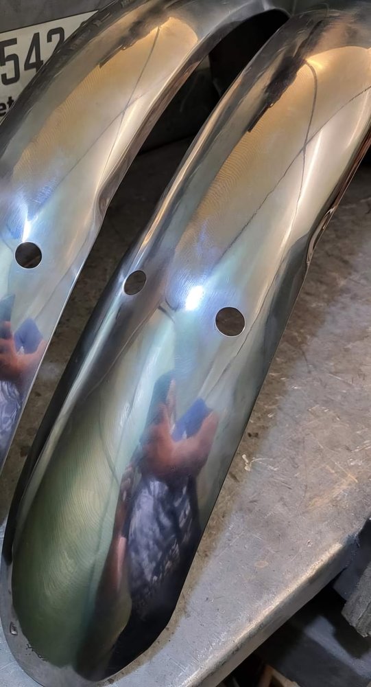

Here is a stainless steel mudguard I repaired recently. It's from a very rare Malaguti trail bike. The owner is restoring it back to factory spec but someone had drilled holes for a non UK spec rear light. These needed to be deleted and the dents etc repaired. It was a real challenge because there wasn't much material to work with when sanding down the welds. I had to make sure of 100% penetration with no pin holes because it's mirror polished but the stainless steel it's made from is only 0.5mm

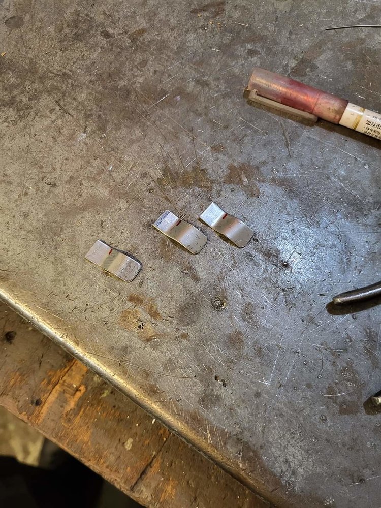

I also made new cable clips as the old ones were made from mild.steel and rotted off!
