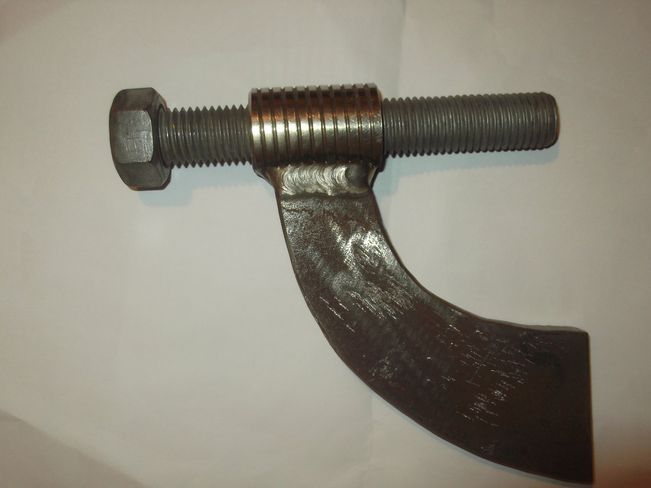

This is a welding dog that I made a couple of weeks ago and has a mild steel body and a stainless threaded section (part of a M16 concrete anchor). I joined the two together with a dissimilar metal rod (Stubs 65 XL). Lovely rod to use but expensive to buy if you've only got to weld a few bits.
