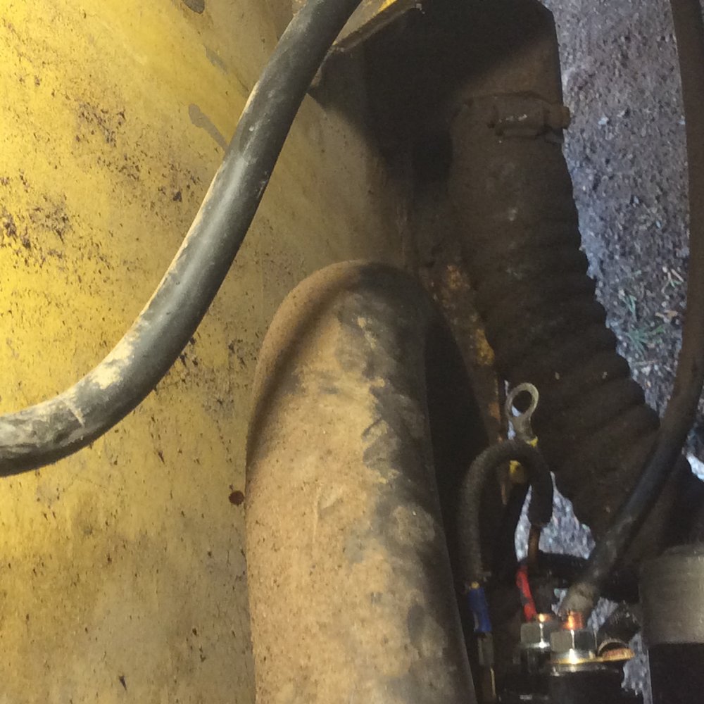

, that would be the small term on the solenoid, some have a wire that goes to the same terminal at the bat +, that goes to alternator output if fitted, see it the wire is live when the key is turned to start positionHyster fork lift.We need more information to help. What vehicle is it?
Mazda engine?Hyster fork lift.
On a starter motor, you've got batt +ve, and excitation.
That's all, -ve is the engine block.
On my gas Hyster there is a fist full of wires at the starter, battery lead, earth lead, one to the alternator sharing the same crimp as the ignition feed, one to the starter solenoid and another to a terminal that back feeds the ignition circuit when its cranking.
Bob
I love confidently saying something, and being proven wrong.Not messy celery! On traditional ignition systems, there is an output from the solenoid which shorts out the ballast resistor, the idea being that the 9V coil still receives about 9V during cranking, for easier starting. Normal running drops 3V across the ballast resistor.

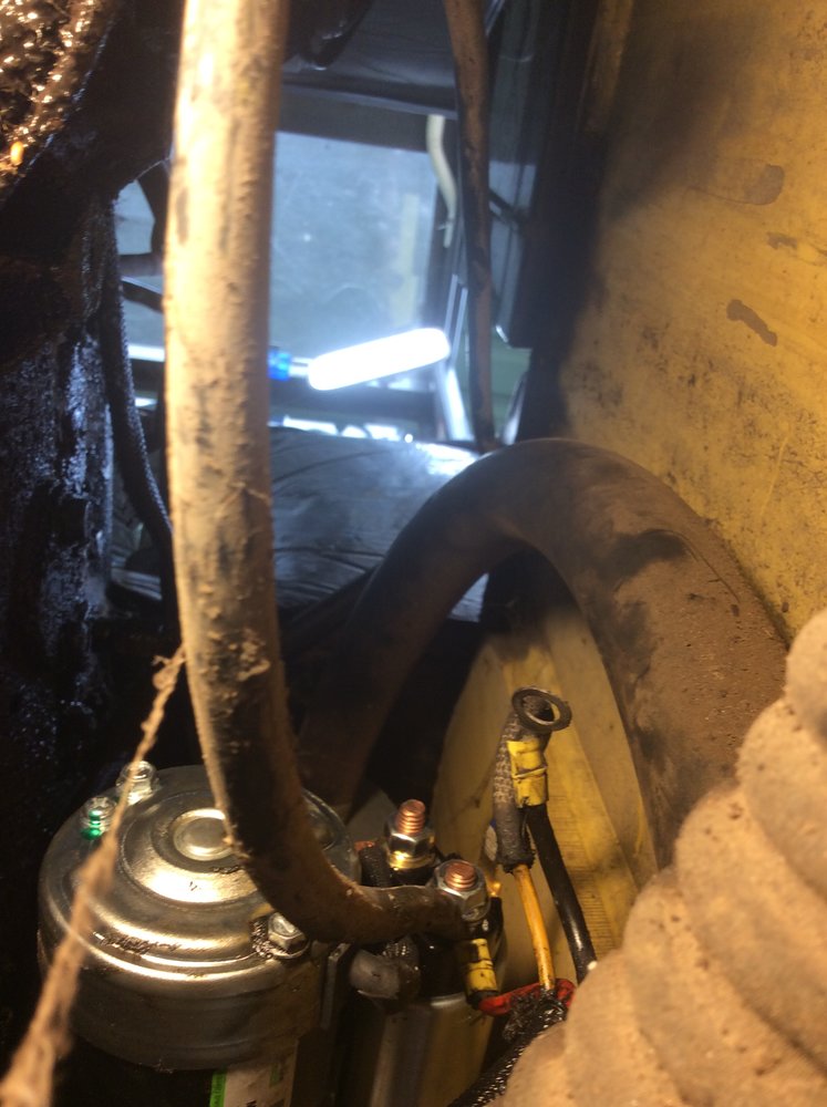

The yellow goes to the solenoid spade,red to the bottom m8 stud,then the black? I assume from dodgy memory,to the top m8 stud.it doesen;t look big enough to be the battery feed to the starter - thats why I guessed feed from alternator
take another photo from underneath?
So that would assume it’s a positive,despite its black colour?Only logical place for the stray is under the other terminal on the starter along with the battery cable, the top one is to the starter windings, nothing goes there.
