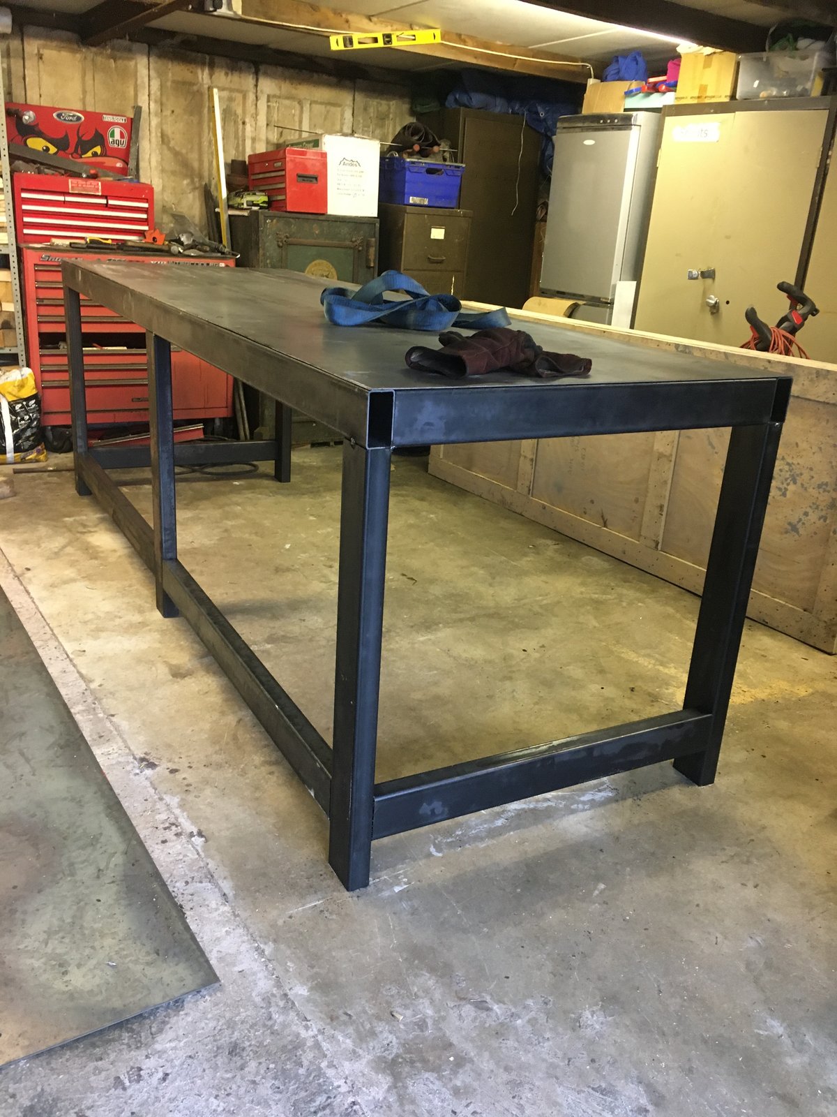

Well after my run out through Castleton I had to make a 3m x 1m x 1m work bench for a Ops customer of mine. I had a nightmare with FH Brundles this week as I waited all week for the steel to arrive and I should of had this made and in Birmingham yesterday! I wouldn’t mind but it’s only 150x50x3 RHS, 75x50x6 angle and 3000x1500x3 sheet so standard stuff but I only got it yesterday afternoon!

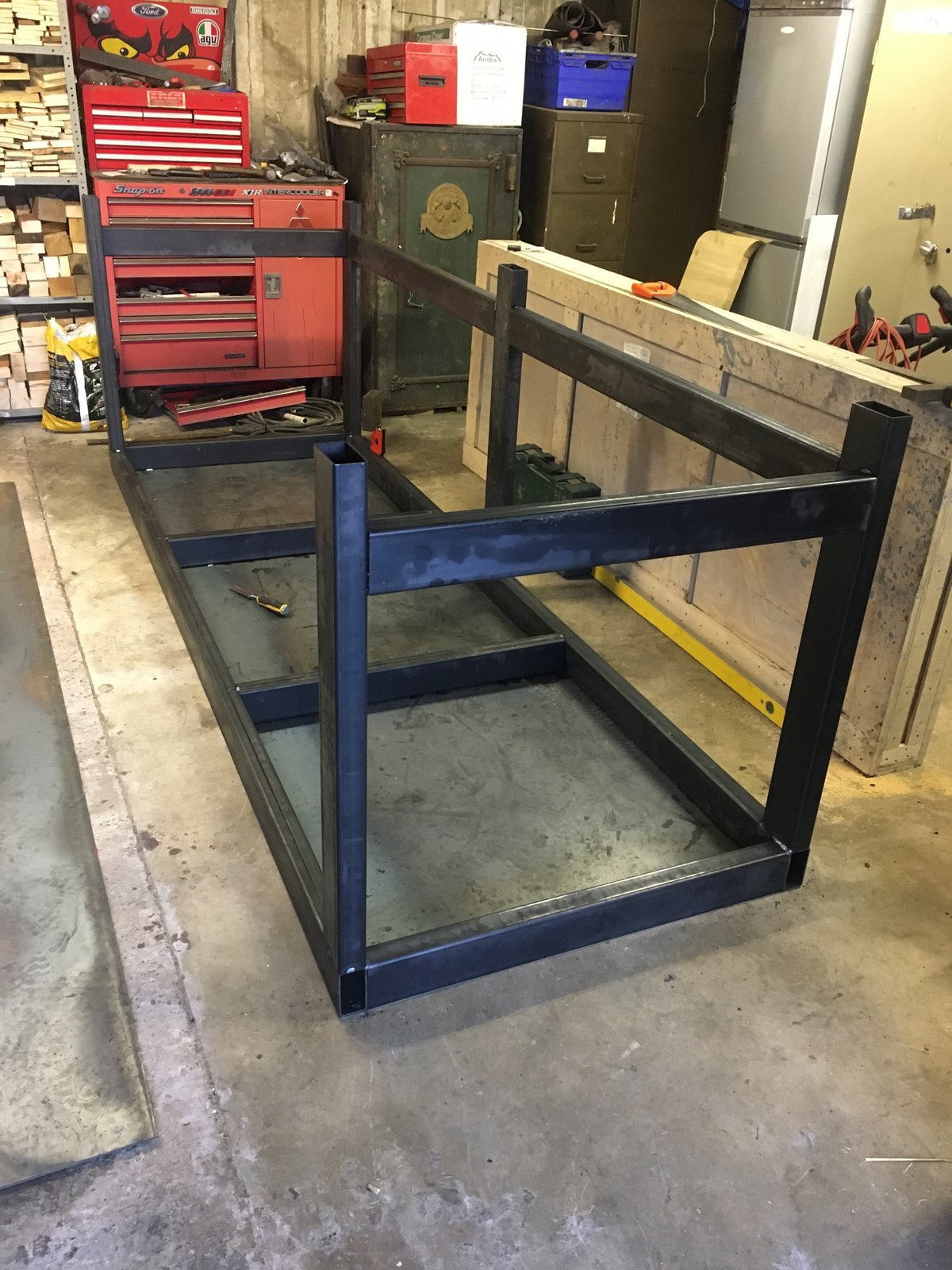

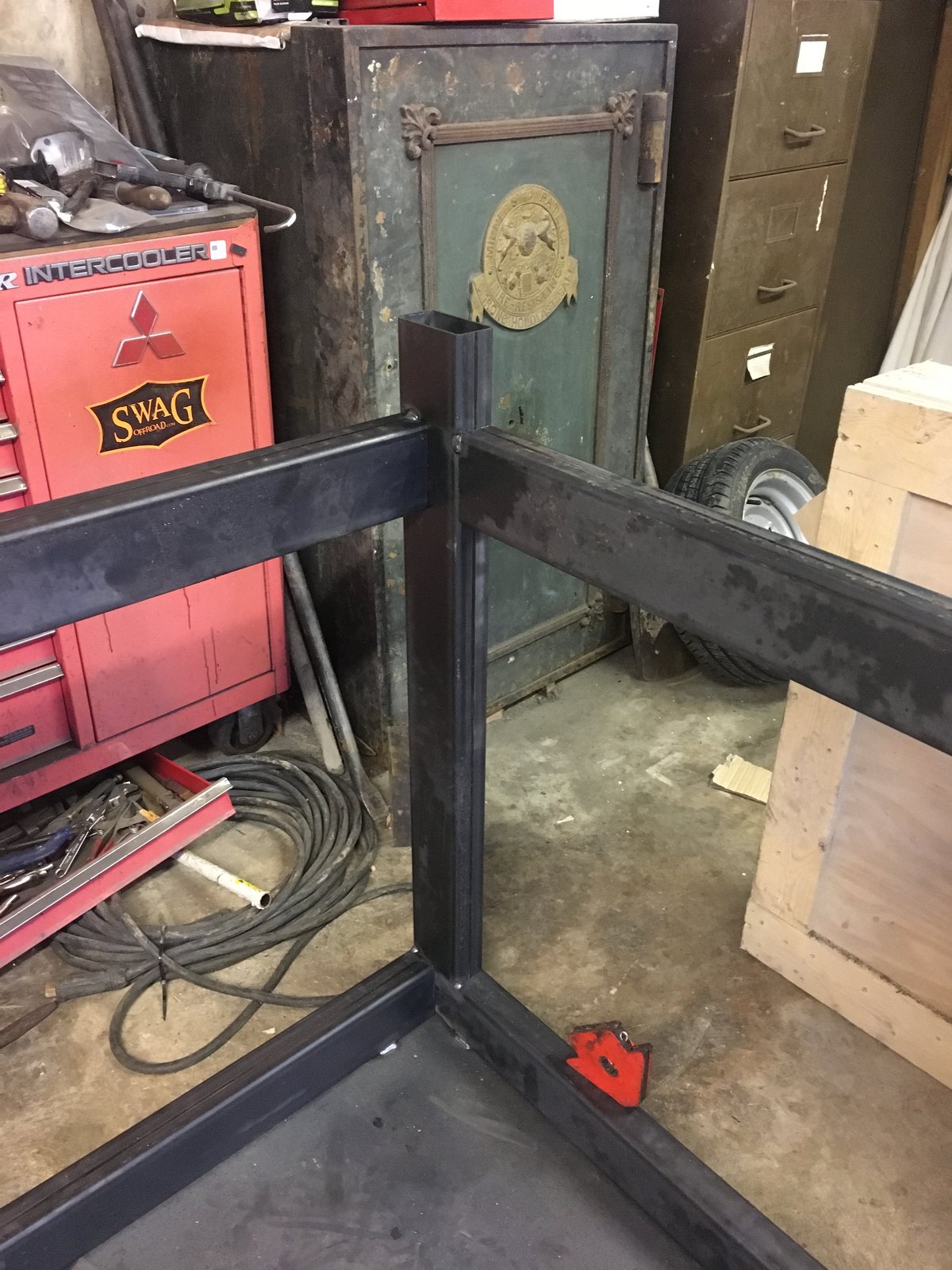

Anyway, got all the cutting out the way and started by trimming the sheet down to 3000x1000. I laid this on my garage floor as a square template to place the frame on and tacked everything together.
I need to wait for a lift now to turn it over so I can check all is level before welding it completely but everyone is busy until later this evening. I’ll be welding the 3 sections angle under the bench top between the two centre sections to strength the top but want to make sure any bow in the sheet comes out when I lift it the right way up
The fun thing will be trying to get it on the back of my Ifor ready for delivery Monday morning
more updates when it’s been righted
