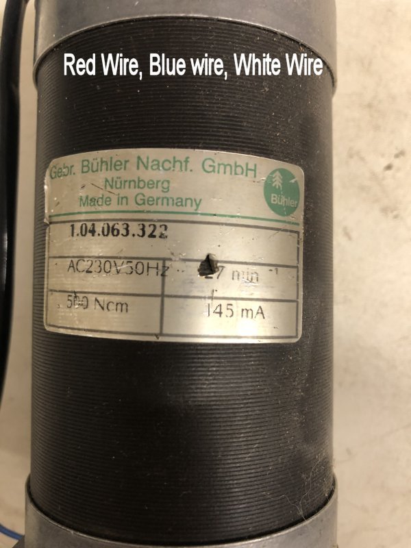

so a while back i got this motor with a detachable gearbox.
i assume il need a driver for it.
it has three wires - Red, Blue and White
any ideas what would work for it.
3 wires and AC supply says 3 phase motor to me. The fact that torque and (such a small) current are given on the label makes me think it's probably made to be a servo, but without an encoder and servo drive it's just a little three phase motor. Equal resistance between the three leads would confirm it, then you just need a VFD to run it.
