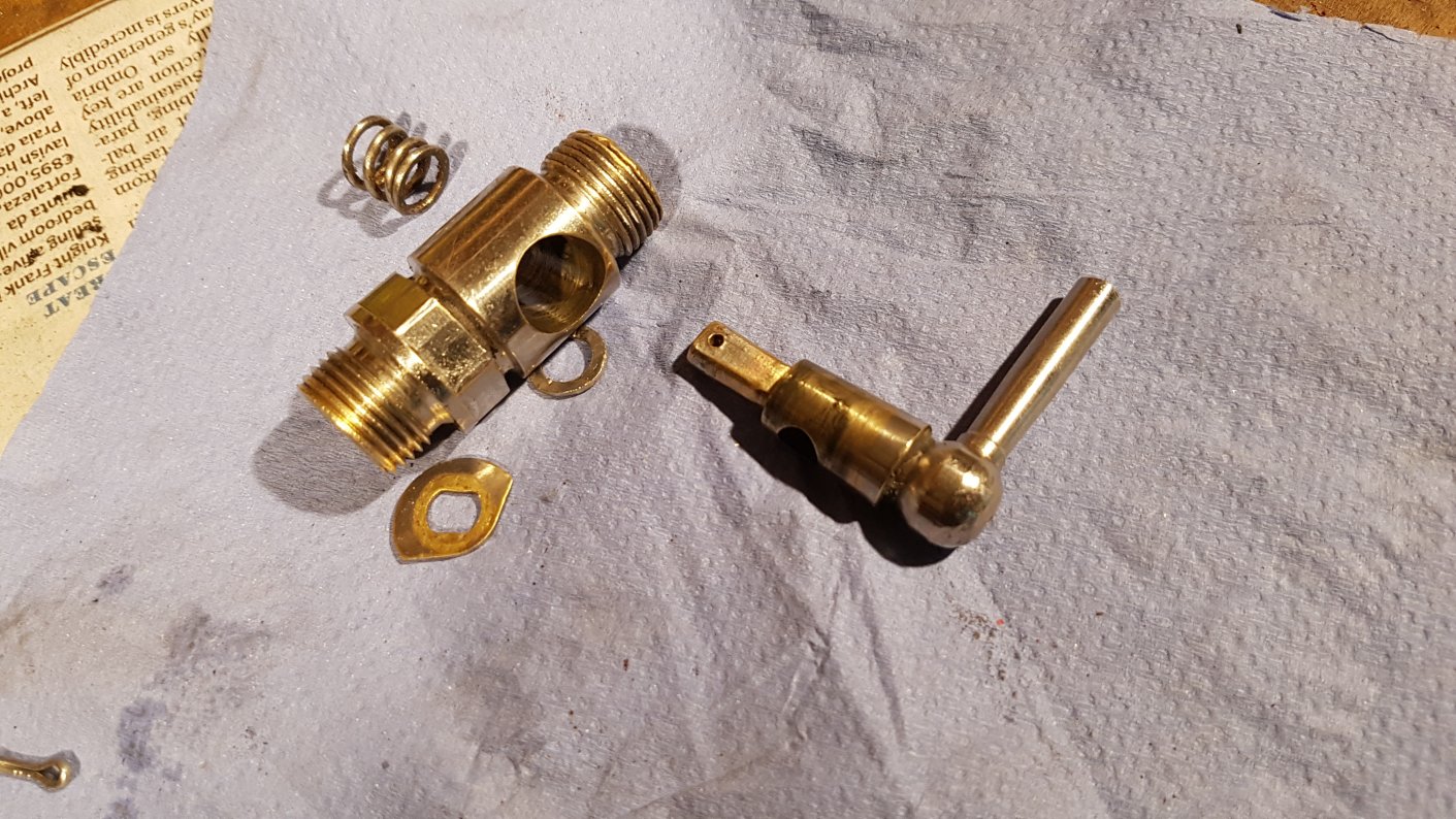

Working on restoring / fixing up an old compressor (vertical-style Broom Wade) and I'm looking at the drain valve, which is a simple but nicely-made little thing :

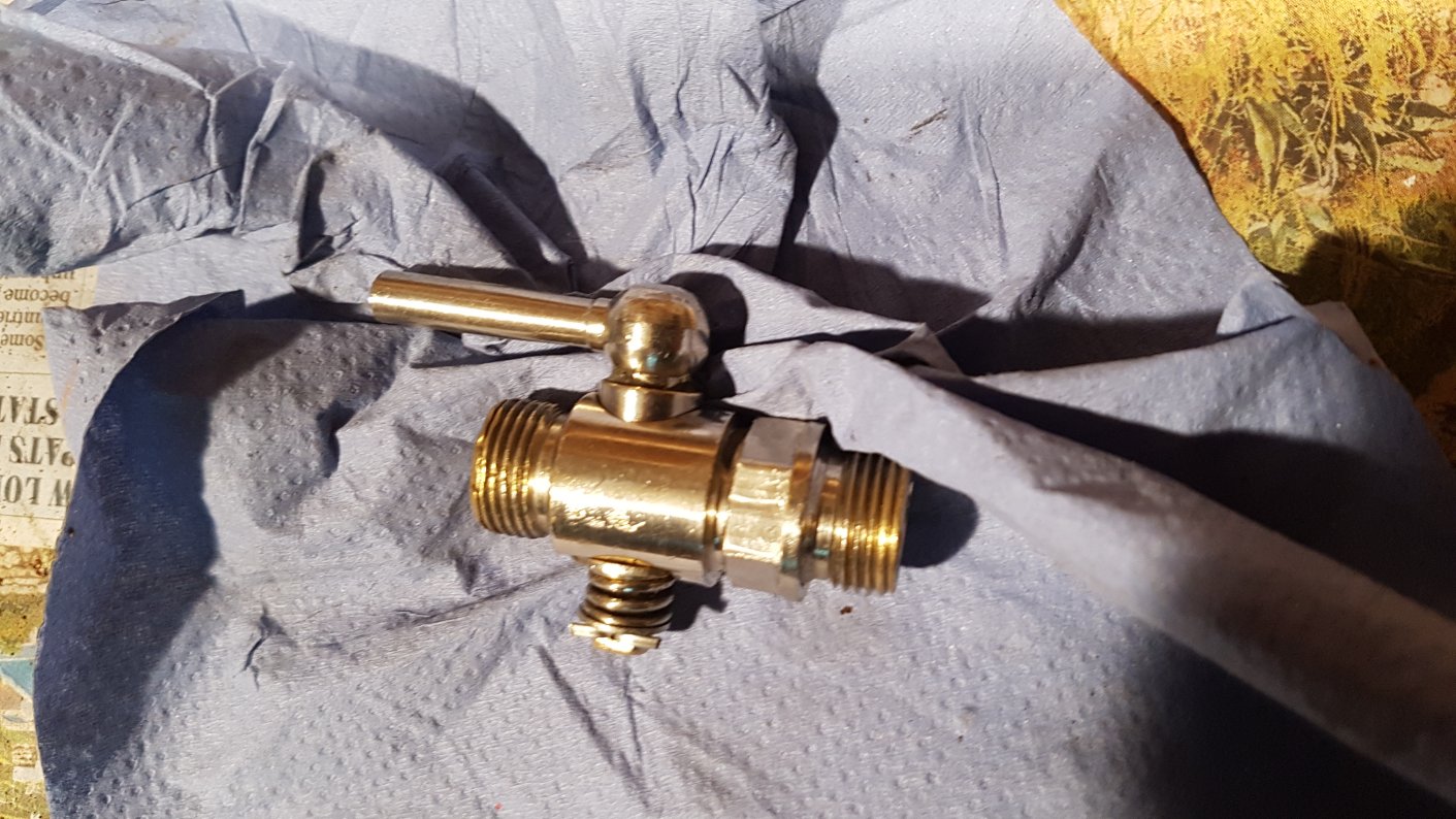

Dismantling it, it's really simple - just a taper-fit centre being pulled down into a conical bore by the spring at the bottom :
However... when I clean and reassemble it, it's incredibly tight, almost sticking solid. Greasing or oiling doesn't seem to help - almost makes it stick more. There is a second identical valve on the compressor I haven't touched yet, and that is smooth and good to use. So it's almost like it doesn't want to be too clean. I realised you could look at it a bit like a morse taper fit - the cleaner it is, the tighter it will be.
Is there some secret type of lubricant I should be using, or some other trick to making this type of valve turn smoothly ?
Thoughts appreciated !
Richard
