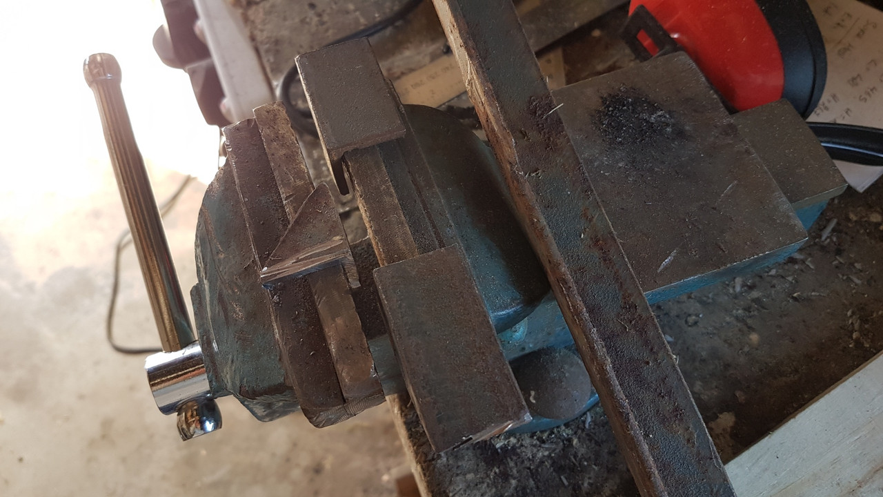

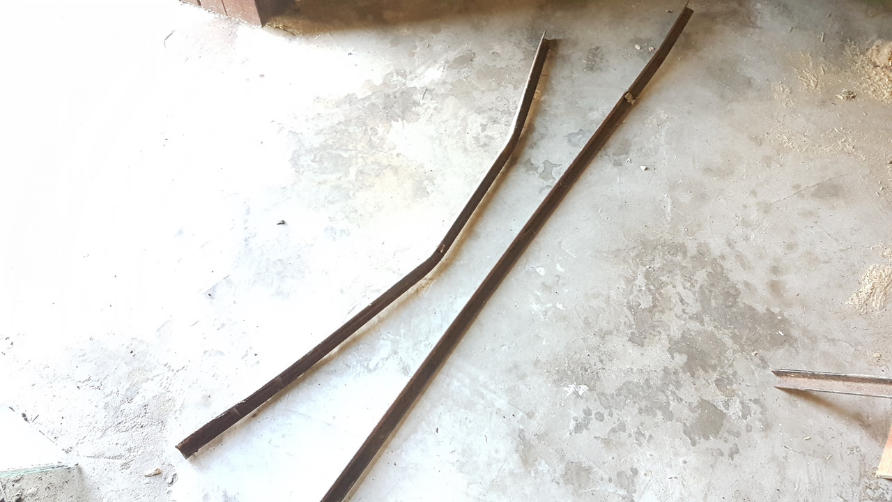

Thanks for tips. Will give it a try. It doesn't need to be perfectly straight.
I'll raise you to clamp, cut, clamp, weld.clamp,cut and weld

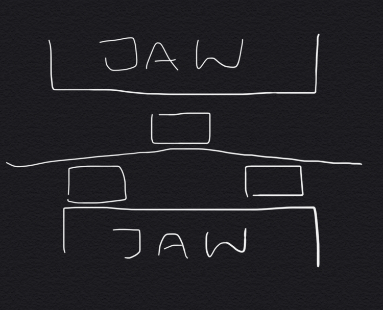

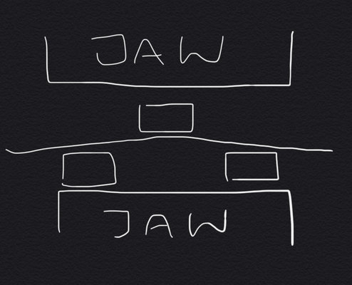

Sometimes I use blocks in my vice to iron out kinks

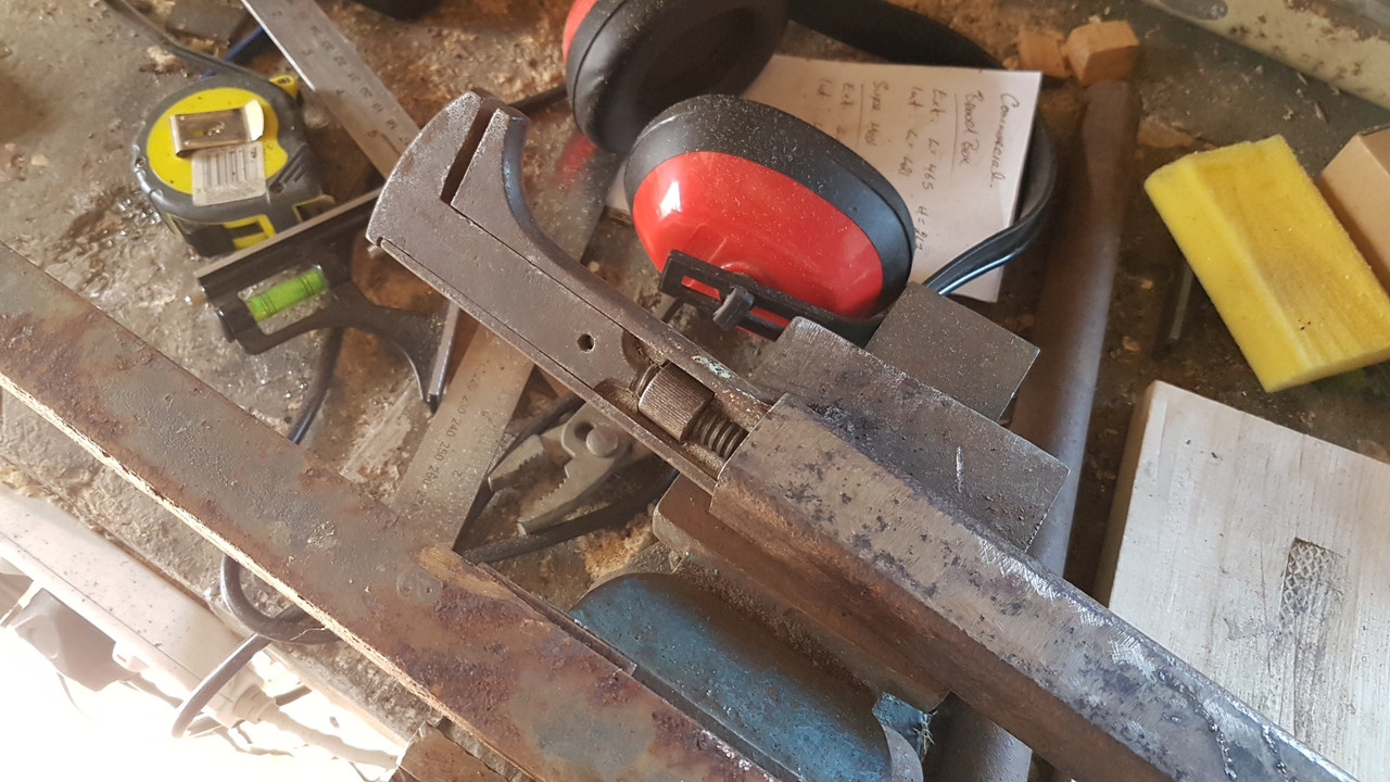

Worked a treat for some kinks in the bar. Used a monkey wrench and bar/lever to get some twists out also.
