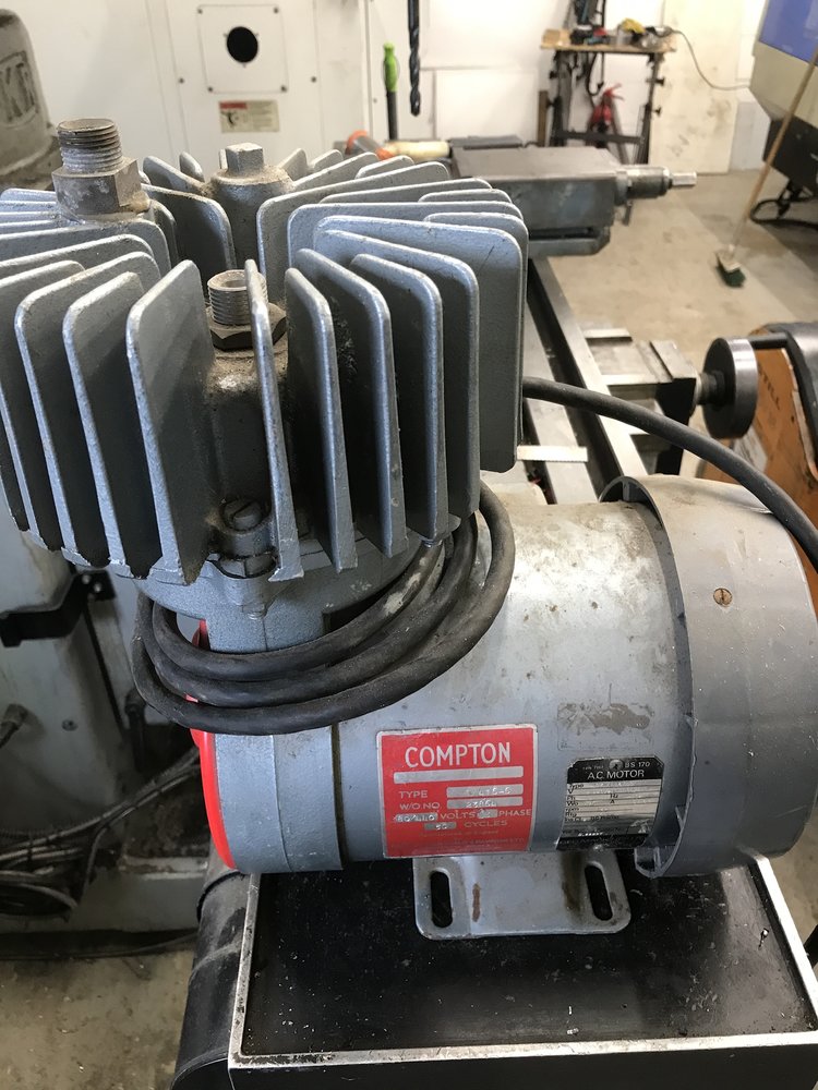

I recently withdrew a little Compton compressor from sale as I found a use for it. Connecting it up doesn’t seem to be as easy as it should be. Yes, I could machine fittings, but quite honestly,I am inundated with work and my time would be better spent doing other things.

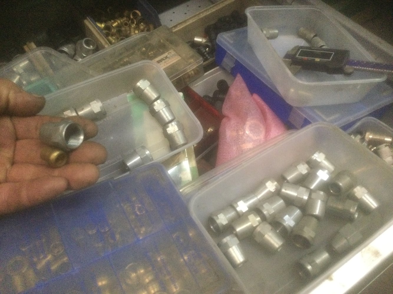

So, it’s got a male 3/4 x 16 unf male thread. Same thread as AN8 fittings or 3/4” JIC fittings. But… here is where the problem begins. Both AN8 and JIC male threads have a 37 degree male taper on the end. This has a male thread but a female taper going into a roughly measured 7/16” hole. Any ideas what this type of fitting is called and where I can find the mating part?
