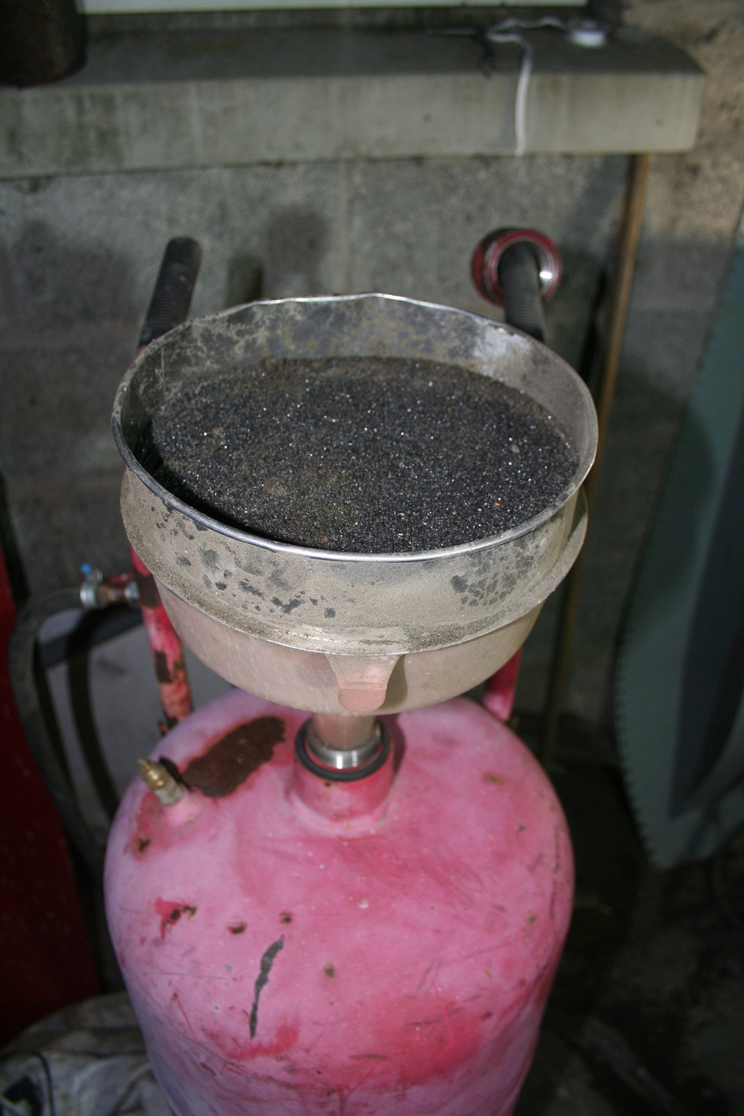

OK thanks, think might get something with handles and fine mesh.

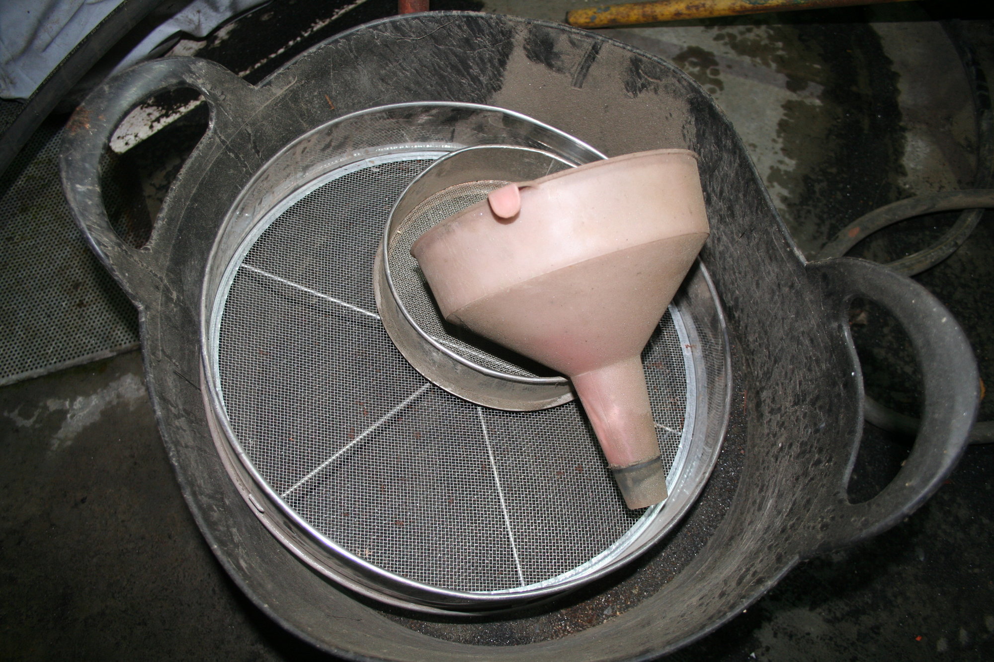

My pot didn't have one I'll look around for something suitable.The one that came with the blast pot that fits into the funnel are good and I still have the one that came with the pot.

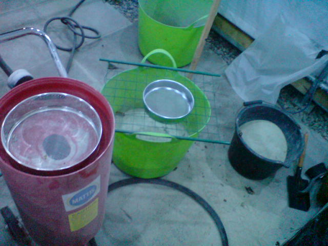

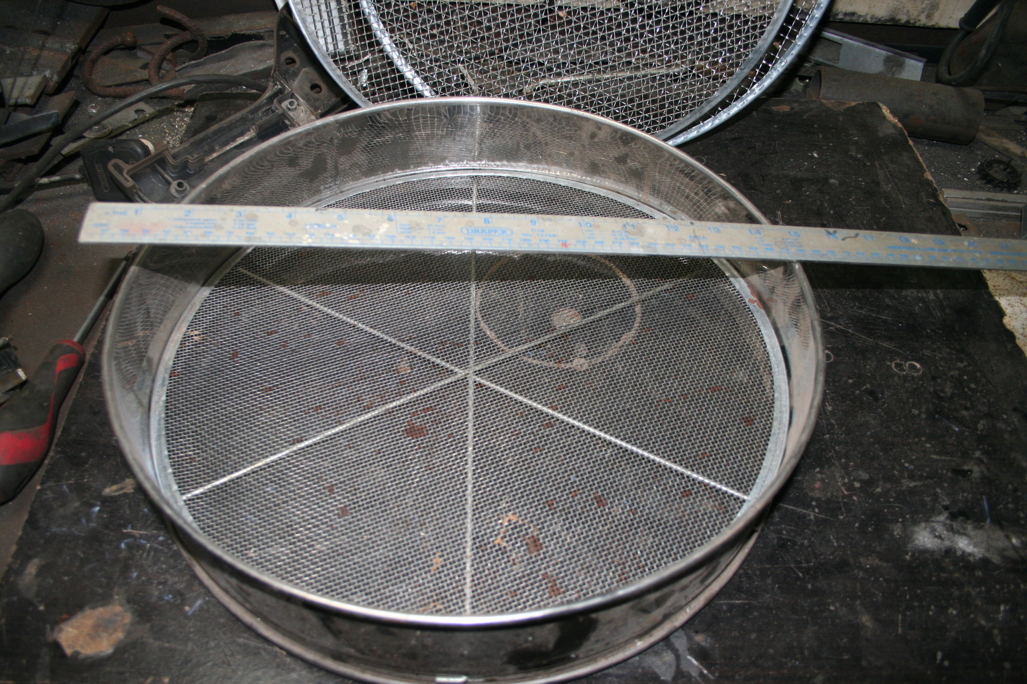

I also use a bigger one that came with 3 different screens that I got from the local hardware store.
It is excellent but you need to sieve sieve the grit into a gorilla tub or similar.
I think they are for sieving topsoil and if you double up on the screens you can go as fine as you like.

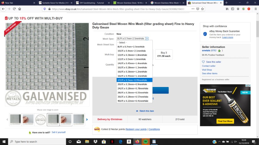

I was thinking about this mesh screen. I have several B&Q orange buckets for collecting from grit from the bottom of the cabinet. I could make timber frame use galvanised U nails to hold mesh in place. If I got a 40cm x 40cm would allow a wide boarder to nail to bottom of frame to give it plenty of support.The one that came with the blast pot that fits into the funnel are good and I still have the one that came with the pot.

They are bigger diameter than a yellow bucket, so the need to use a gorilla tub, but can sieve a lot of stuff in short order.
OK thanks for that. Don't think will bother with the expense of a tub and screen mesh, will get a sieve from Poundland or Asda and see how I get on.
