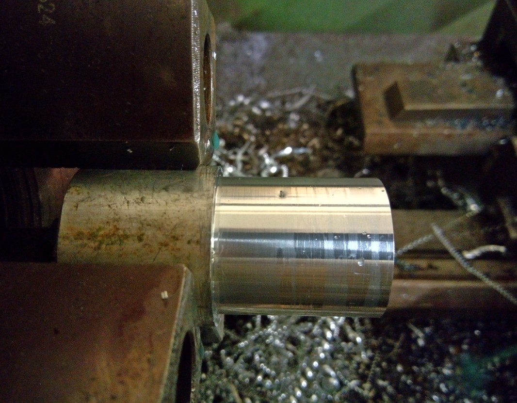

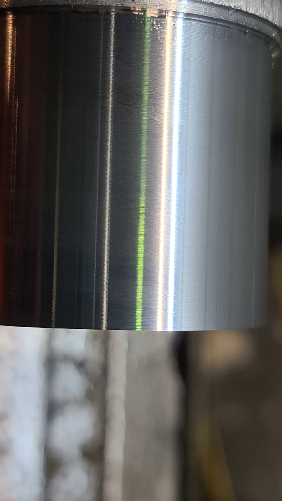

Used wd40.What tool did you use?
Did you use coolant or cutting oil?
The finish looks ok but like there has been smearing of the surface possibly by swarf being trapped behind the tool.
It could of course just be the camera as often cameras make things look worse than they actually are.
I don't see any harmonic pattern so I'm guessing just gummy metal. I bet the swarf is coming off in ragged edged strings.
Try winding the speed right up or use a polished insert tool.
The big question is: What is the material? Yes
is it a critical dimension and whats it for. you could use emery tape to clean it up and cover the lathe bed with cloth while its running

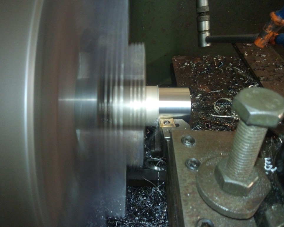

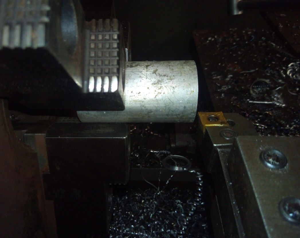

Just made a couple of bushes from 6082 tube so took some pics.
Tool used.
During cut, without coolant

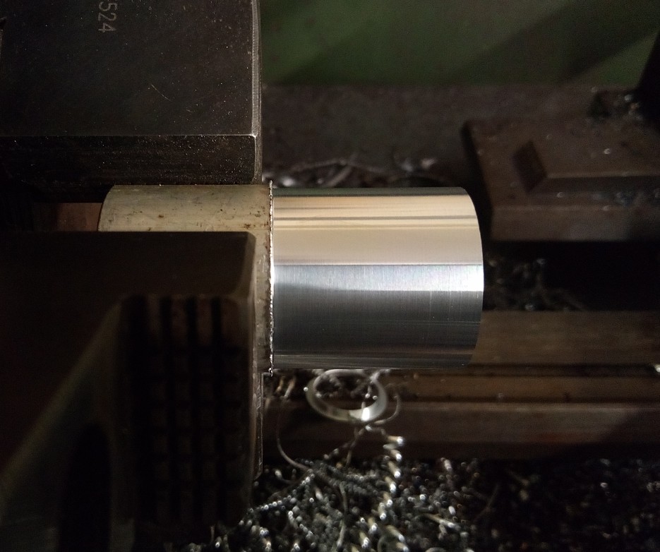

Finish without coolant.

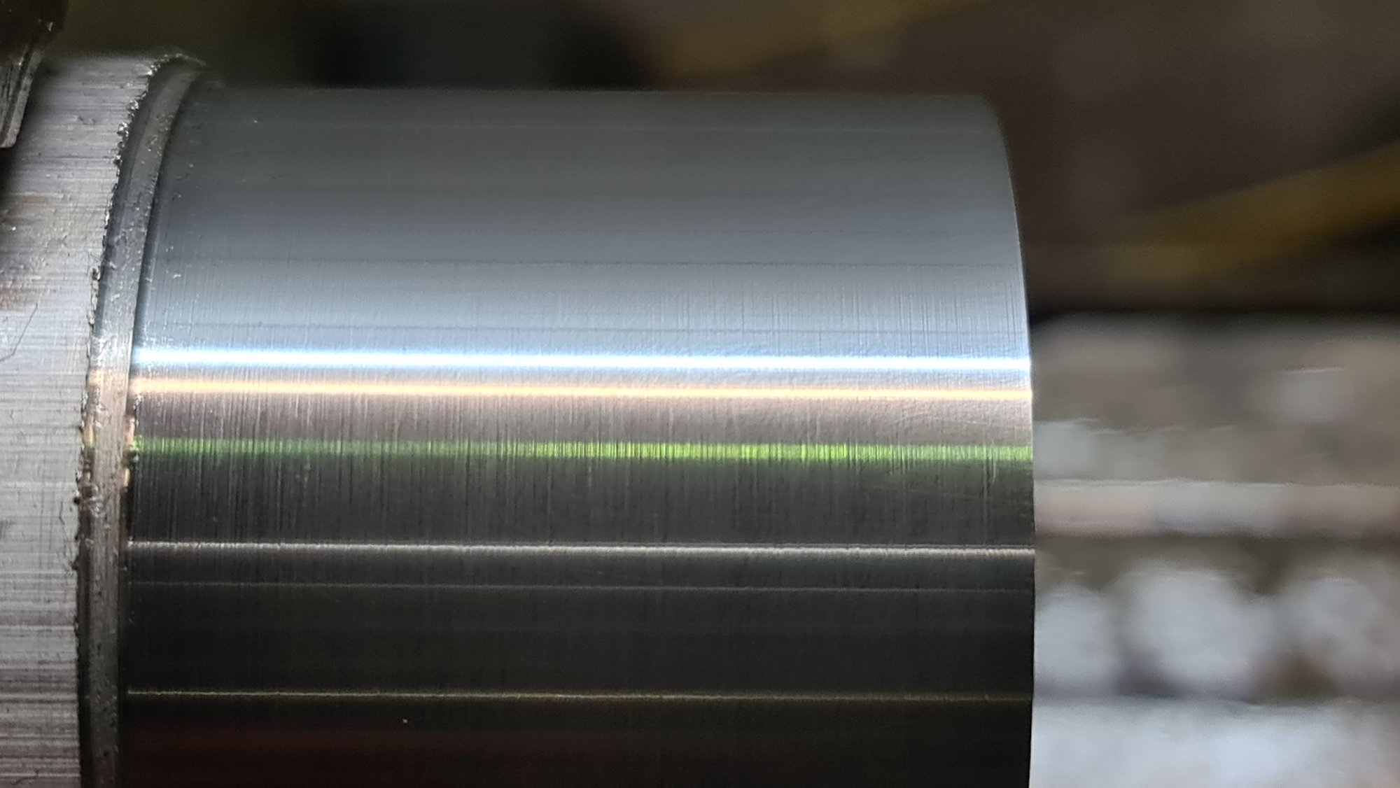

Pass with coolant.
As you say, hard to tell from pictures.Hard to tell from the piccies - lighting makes a difference as well.
How do you think mine compares to yours?
