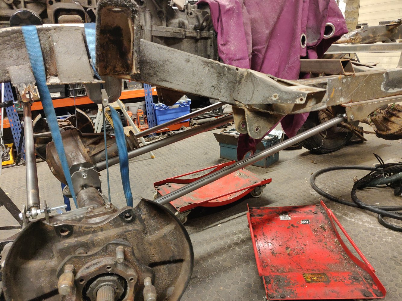

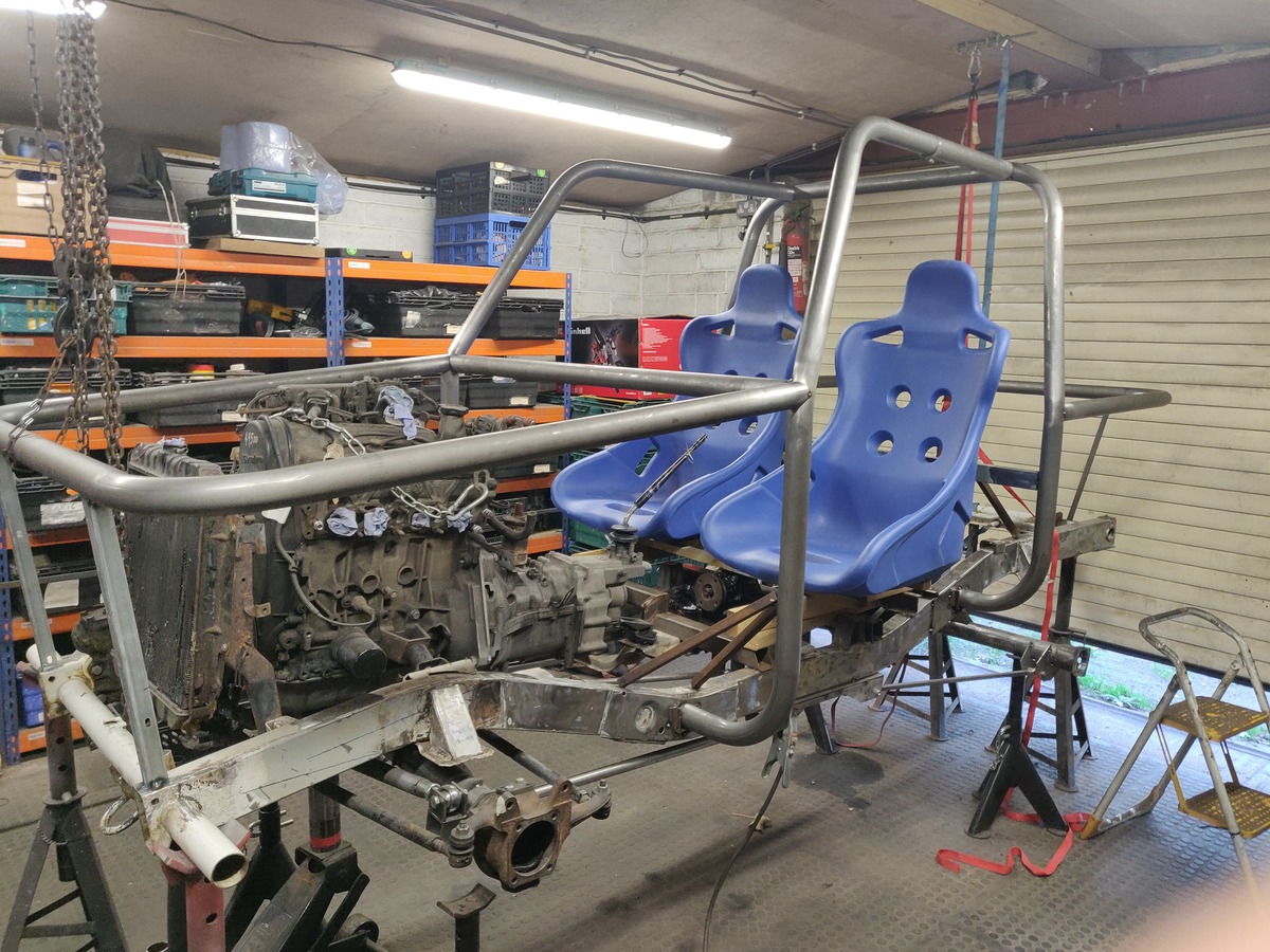

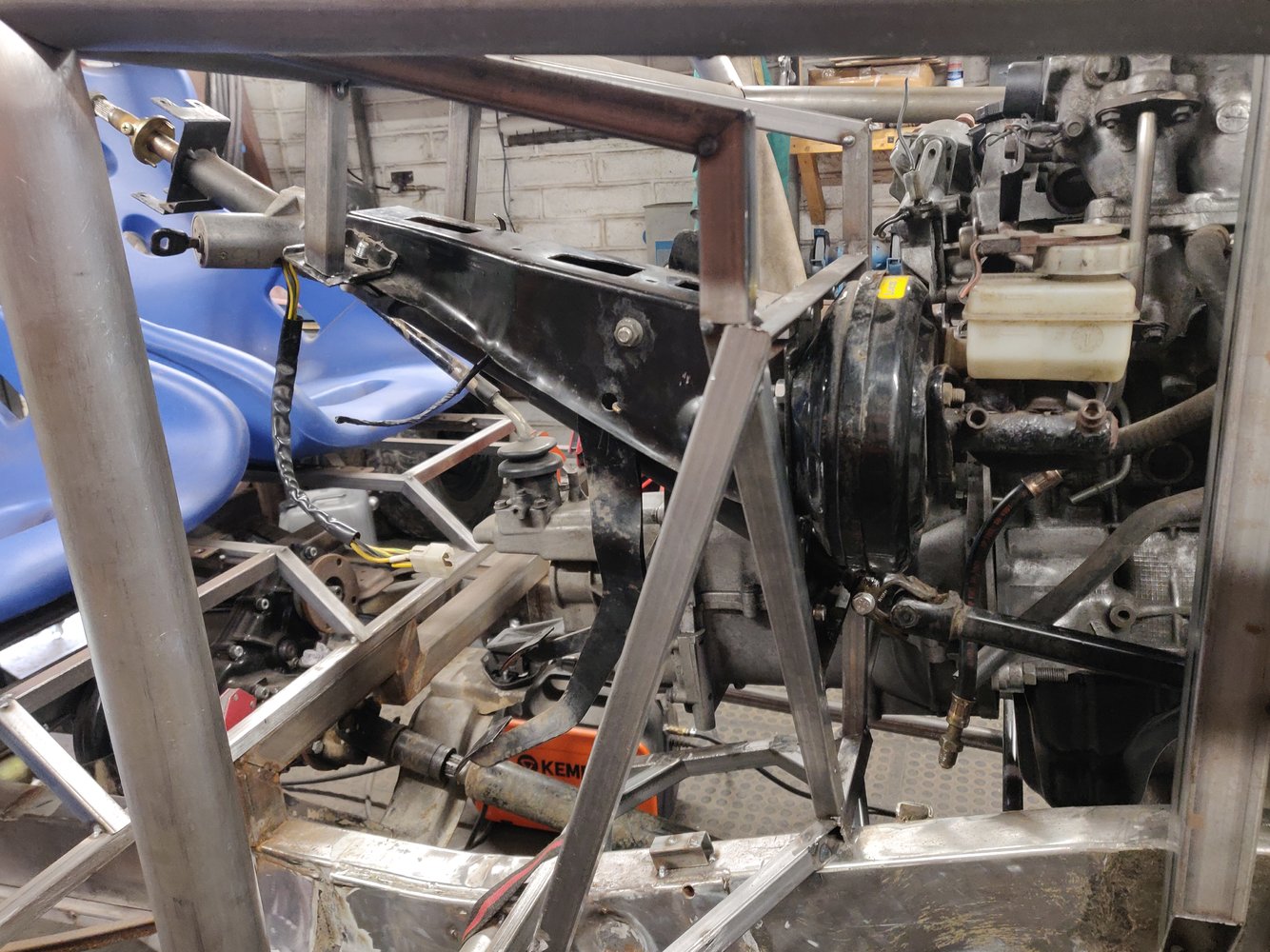

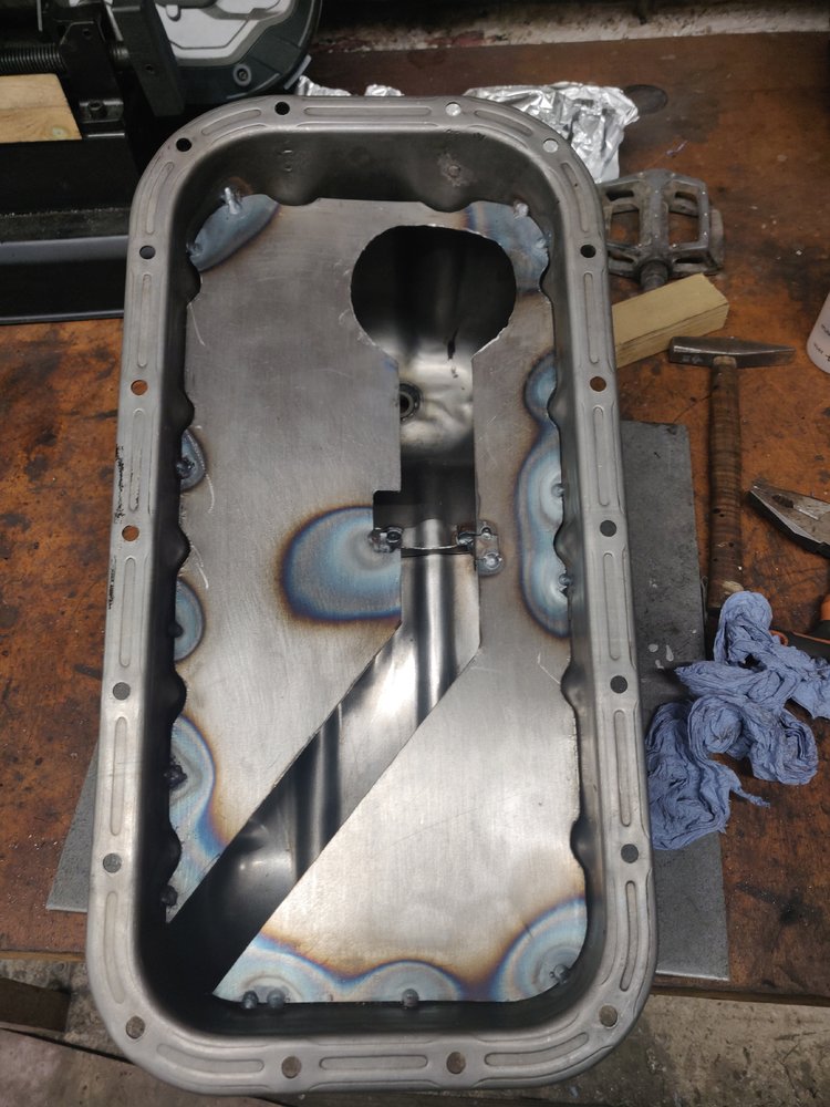

Hi everyone,

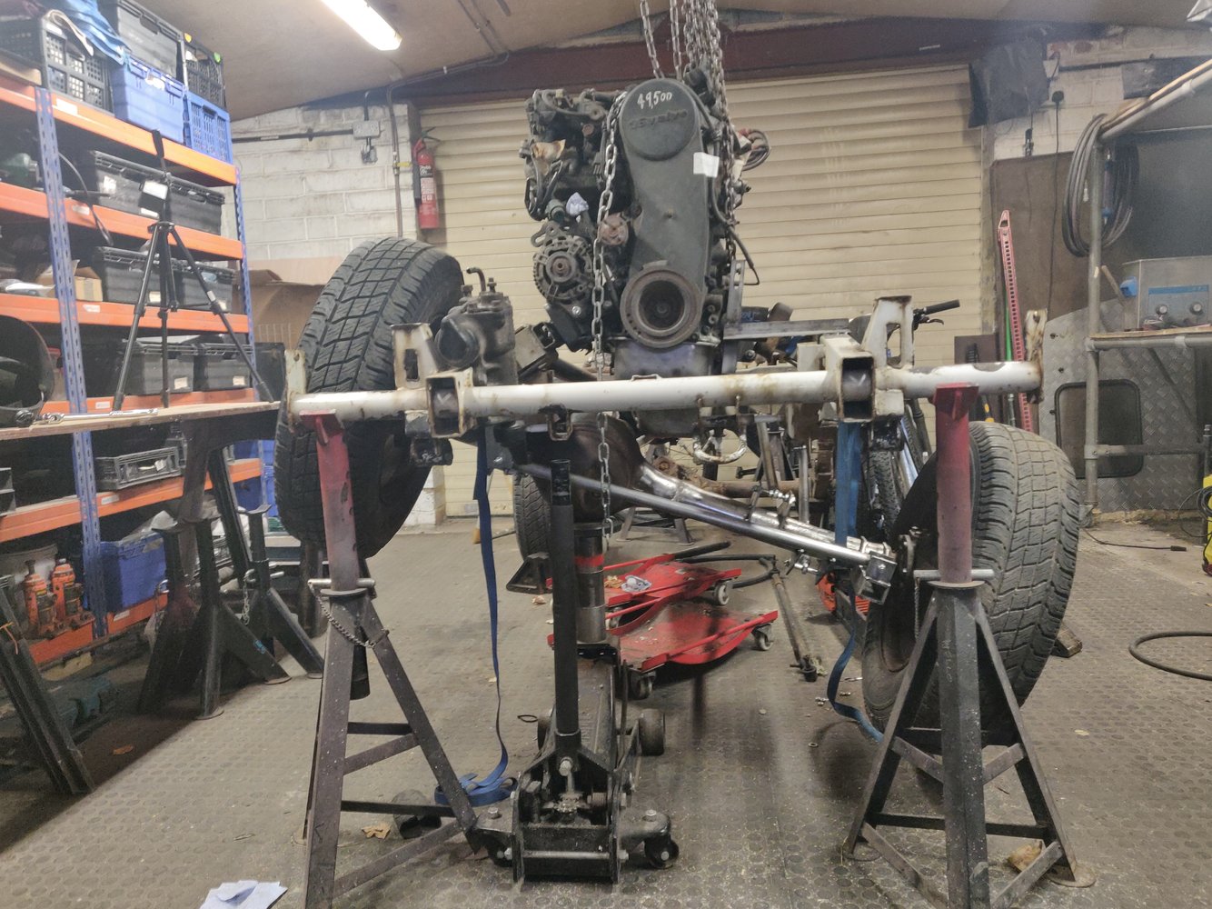

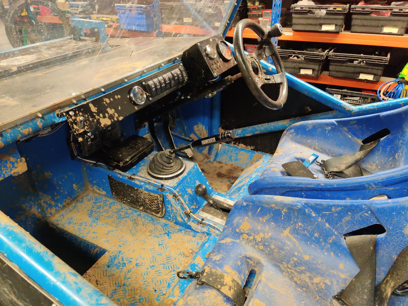

Now that my home built buggy looks like an actual buggy I thought I'd post some photos of it. If there's interest I'll also post some early photos of the build.
The motivation behind this project was to keep my brain busy and have a place to relax and tinker. I had previously modified a 4x4 for serious off road use but it didn’t work out, it was just too challenging trying to get any decent performance out of the stock suspension and to build anything around the stock bodywork.
This project started with over 12 months of research, including watching way too many US rock crawler/bouncer videos, learning suspension geometry, and doing CAD drawings.
I settled on Suzuki as the donor as it's well suited for a small buggy. Suzuki’s had a lot of 4x4s over the decades, the parts are cross compatible and there’s support for essential things like crawler gears. The cars are lightweight, and relatively strong for what they are.

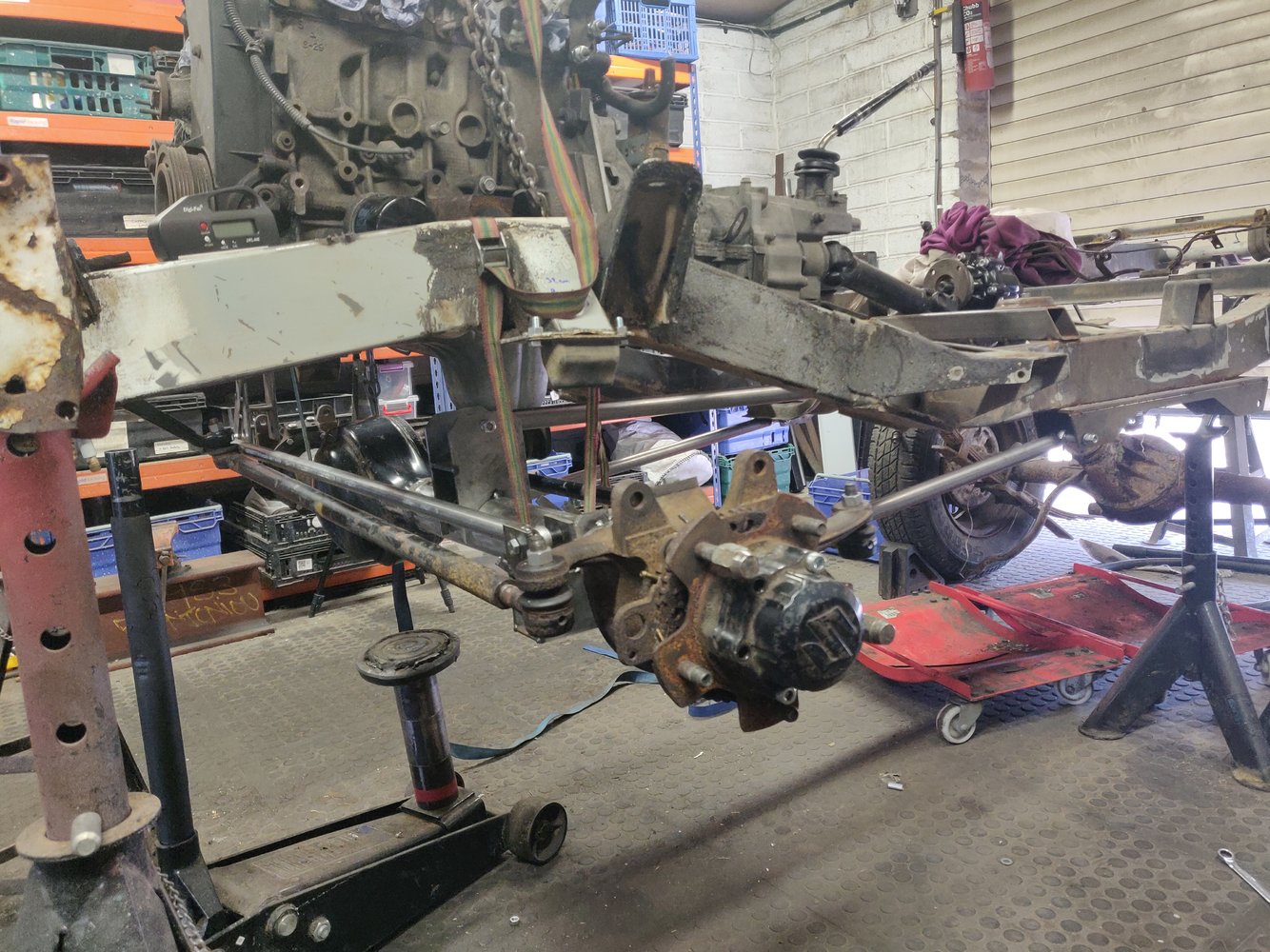

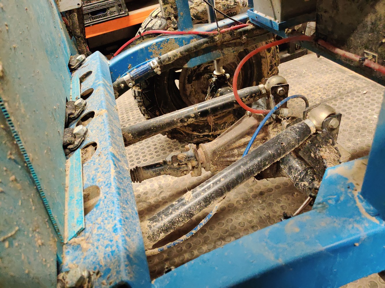

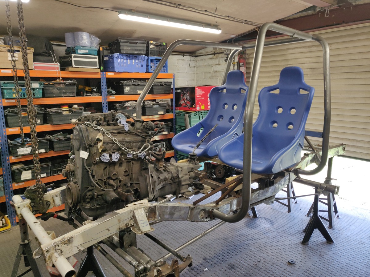

The chassis and drivetrain is from a Suzuki Samurai which has a traditional layout with separate transfer box and solid axles. The engine is an early Vitara 1.6 16v injection with stock ECU. It bolts straight to the Samurai gearbox and has smooth power delivery that works well off road. This engine and drivetrain are a match made in heaven for a small 4x4.

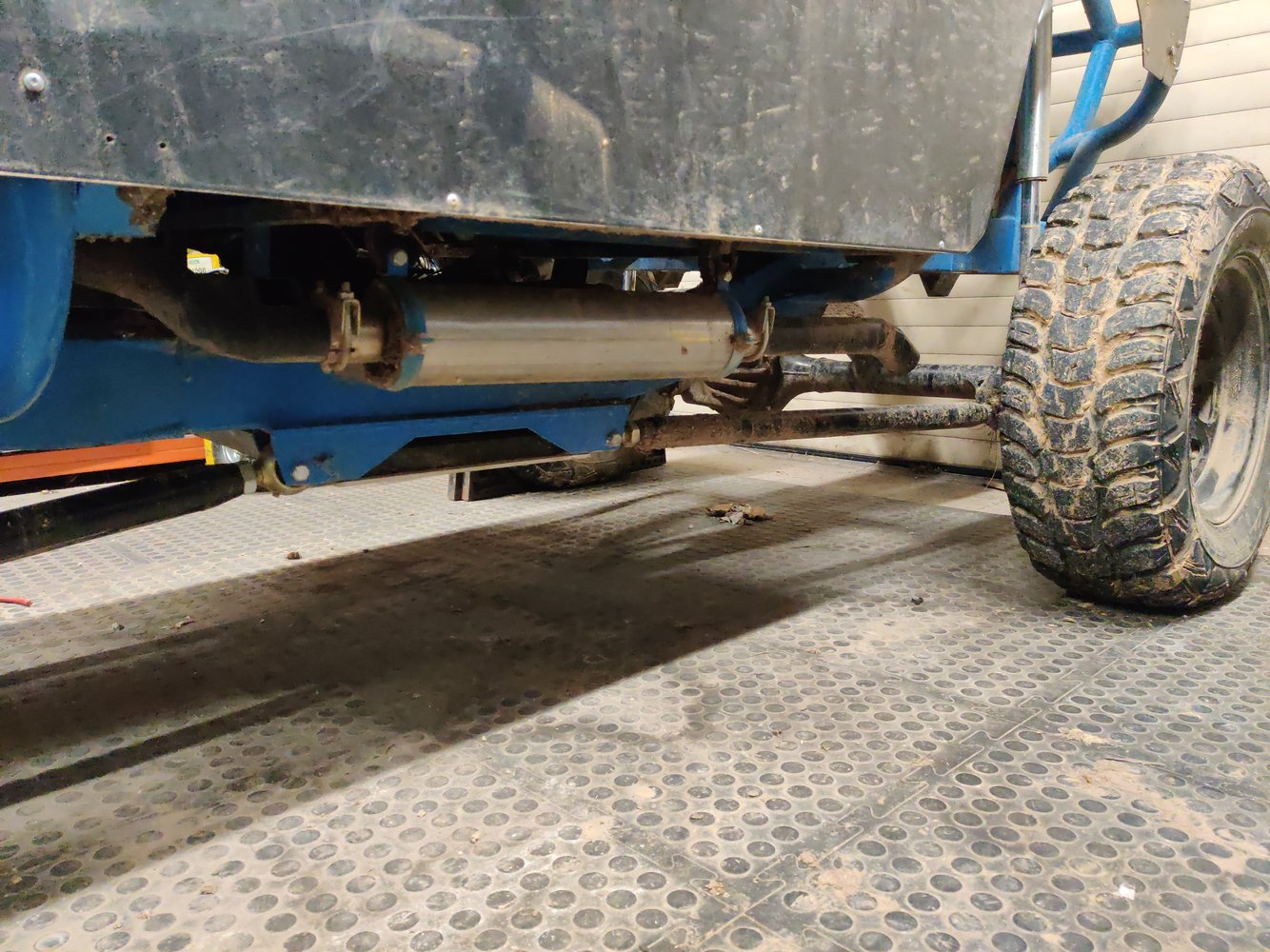

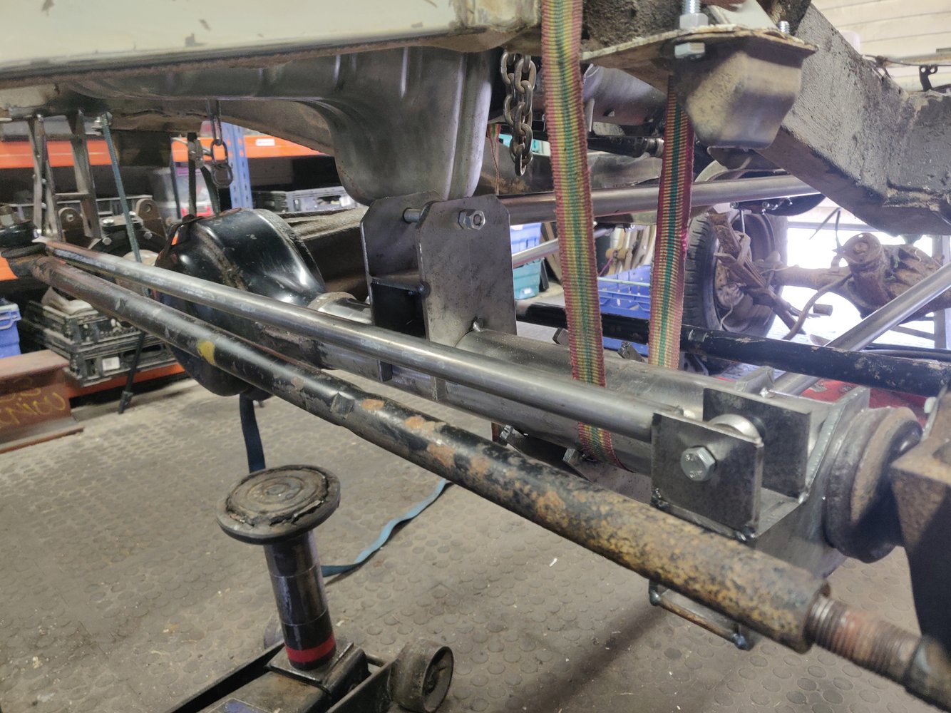

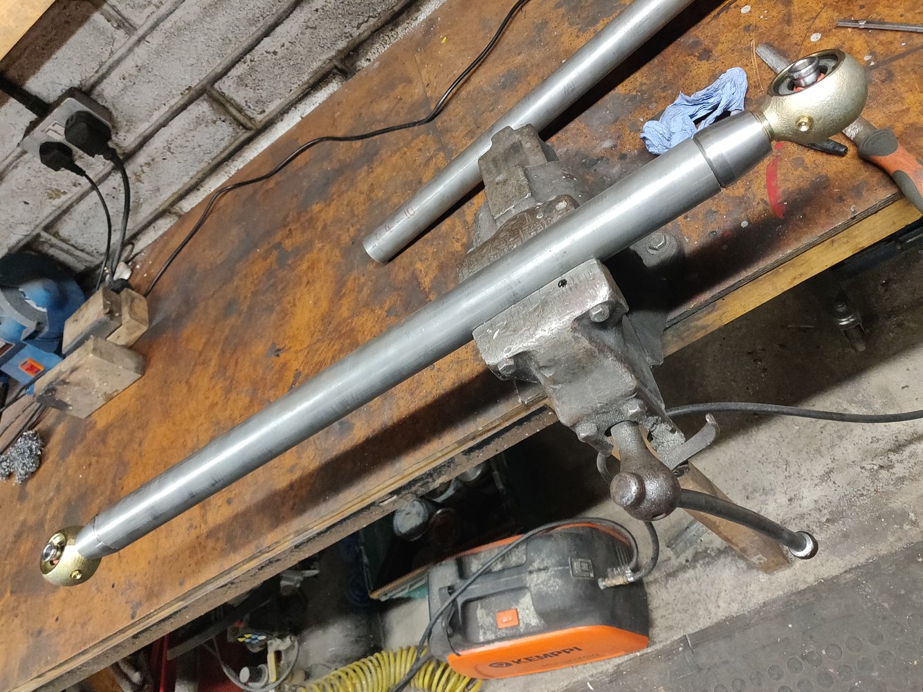

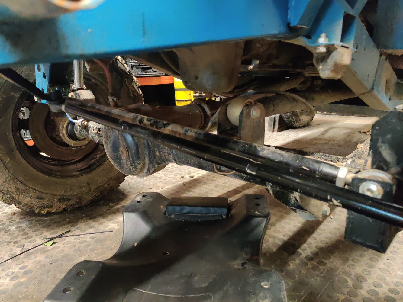

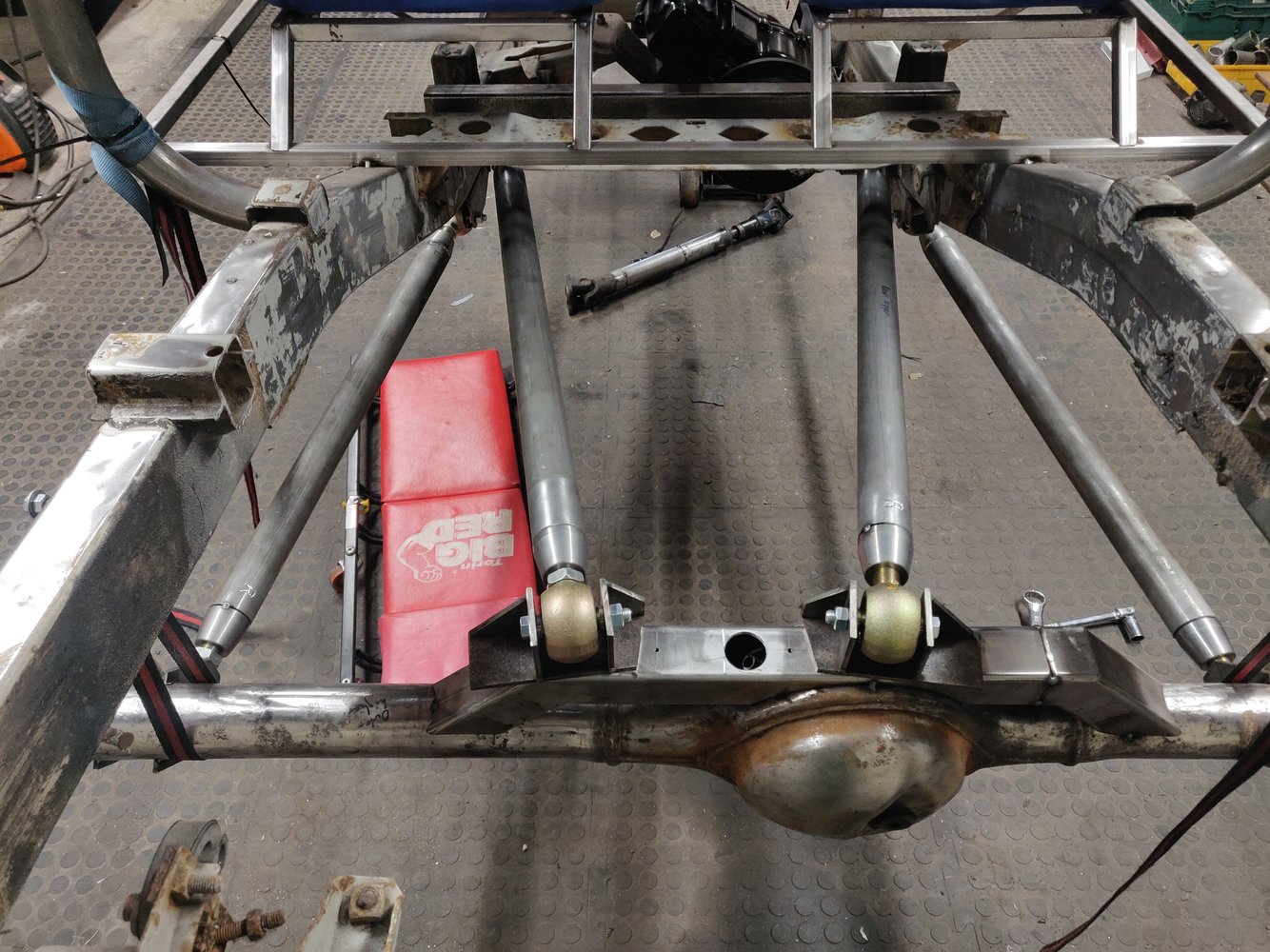

I went for four-link long travel suspension at the rear. Three-link suspension at the front to avoid having to use hydraulic steering. Front shocks are 14" and rear are 18". I built for compliance for 4x4 trials.
It took two years of work to have something barebones testable in the field. Then another year to do things like the cabin, power steering, winches, body panels. I reckon another year to do finishing touches like the lights, diff locks and final custom axles. So five years total !!!

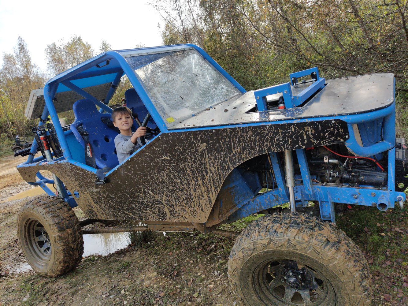

It's performed well so far but I'm still testing its limits and my skills. I was on some of the black trails last weekend with a much heavier, larger car. The larger car did better in deep mud, he'd sink to the bottom and find grip. Mine did much better on the uphill climbs due to less weight pulling it back down.

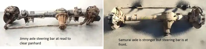

The next major piece of work will be custom axles. I initially fitted Jimny axles as they allow space for the panhard bar, but they're not strong. They're also a little too narrow to allow the full articulation of the suspension at the rear and fitment of bigger 31" tyres which are essential in UK mud.
Thank you to everyone’s help. I wouldn't have been able to finish the project without the advice and knowledge on this forum. I’ve also had help from my brother, buckets of tolerance from my dear wife and my young kids who'd play around the workshop instead of being properly supervised.
