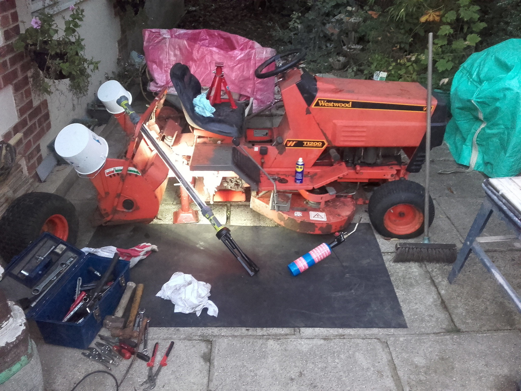

Abandoned this (under cover) last year pretty much as too far to push to work on. Finally found the mojo the other day to take the tarp off and with some help to push, get it onto the concrete.
Up on a couple of stands and a hose off so I can see what I'm doing.
The wife was complaining a year ago it was hard to get into gear and that the belt kept jumping off if you put it into reverse sometimes. New belt btw.

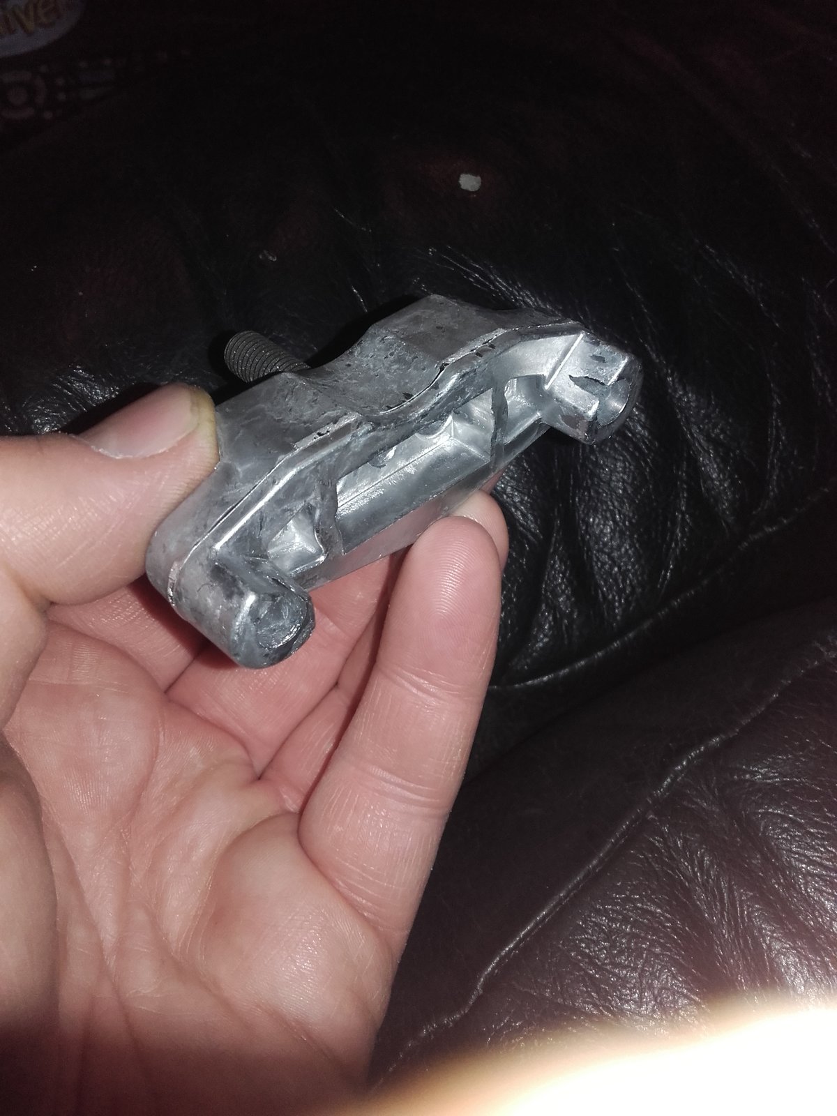

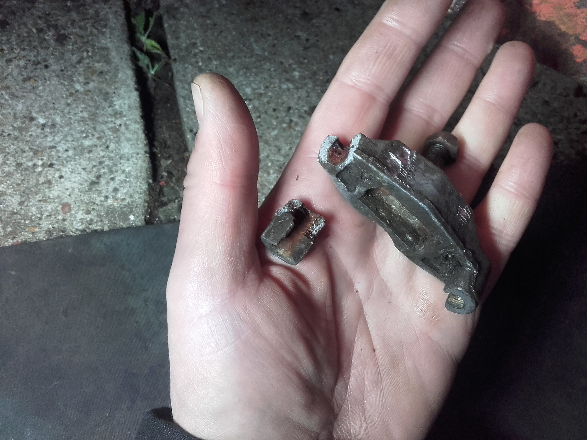

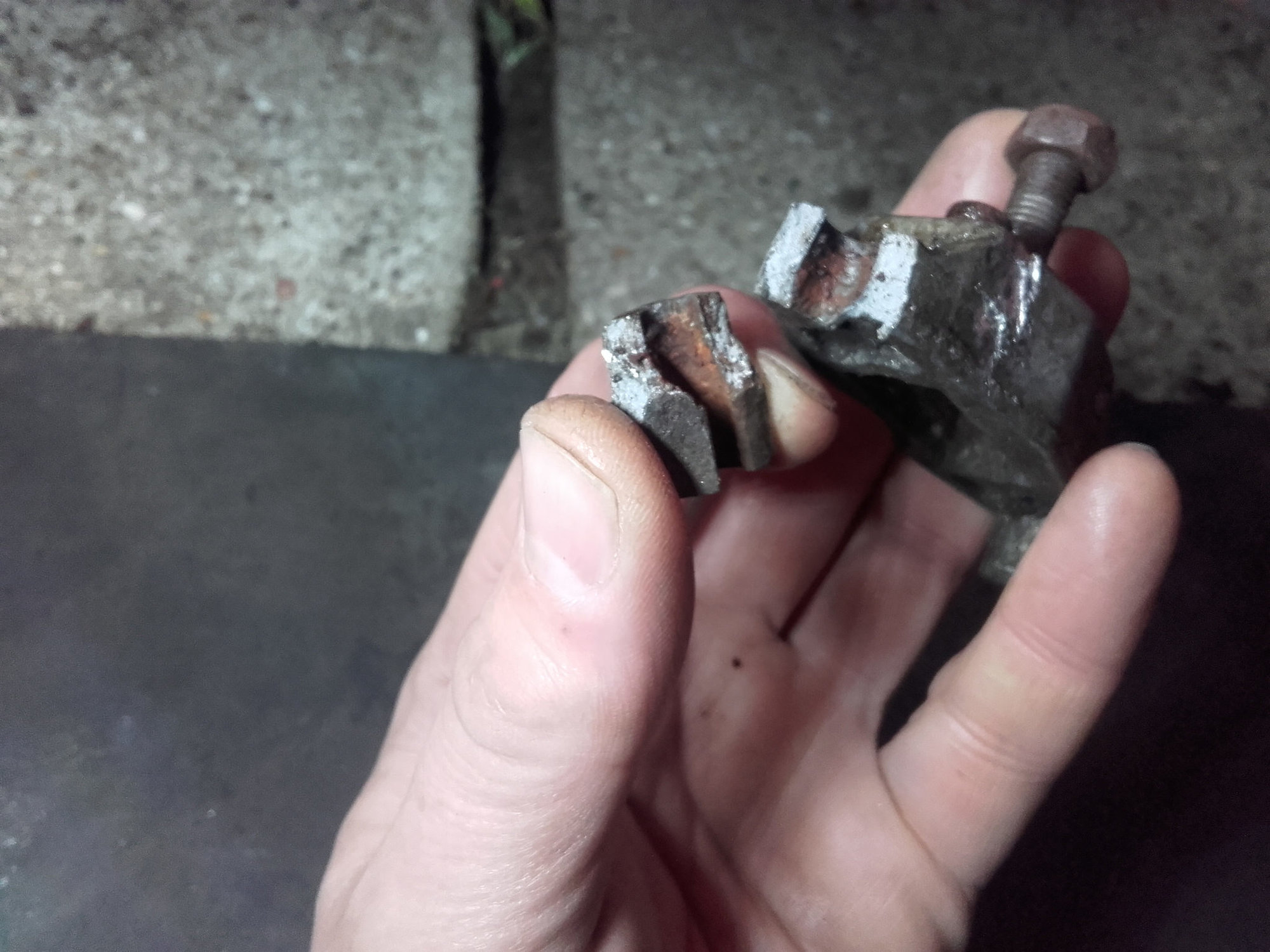

The brake on the side of the Peerless gearbox wasn't working so I thought I'd start there. Two M6 studs hold the caliper on and the whole lot was seized in an ali/steel electrolytic reaction fest! I managed to shear the M6 nut / end of the first stud. My mate, calling me a heavy handed giant proceeded to do the same on the next one!
The caliper was seized on the remaining studs. A bit of heat one side freed that up but...
A mate in the States is hopefully sending me a new caliper as they can be had for peanuts out there.

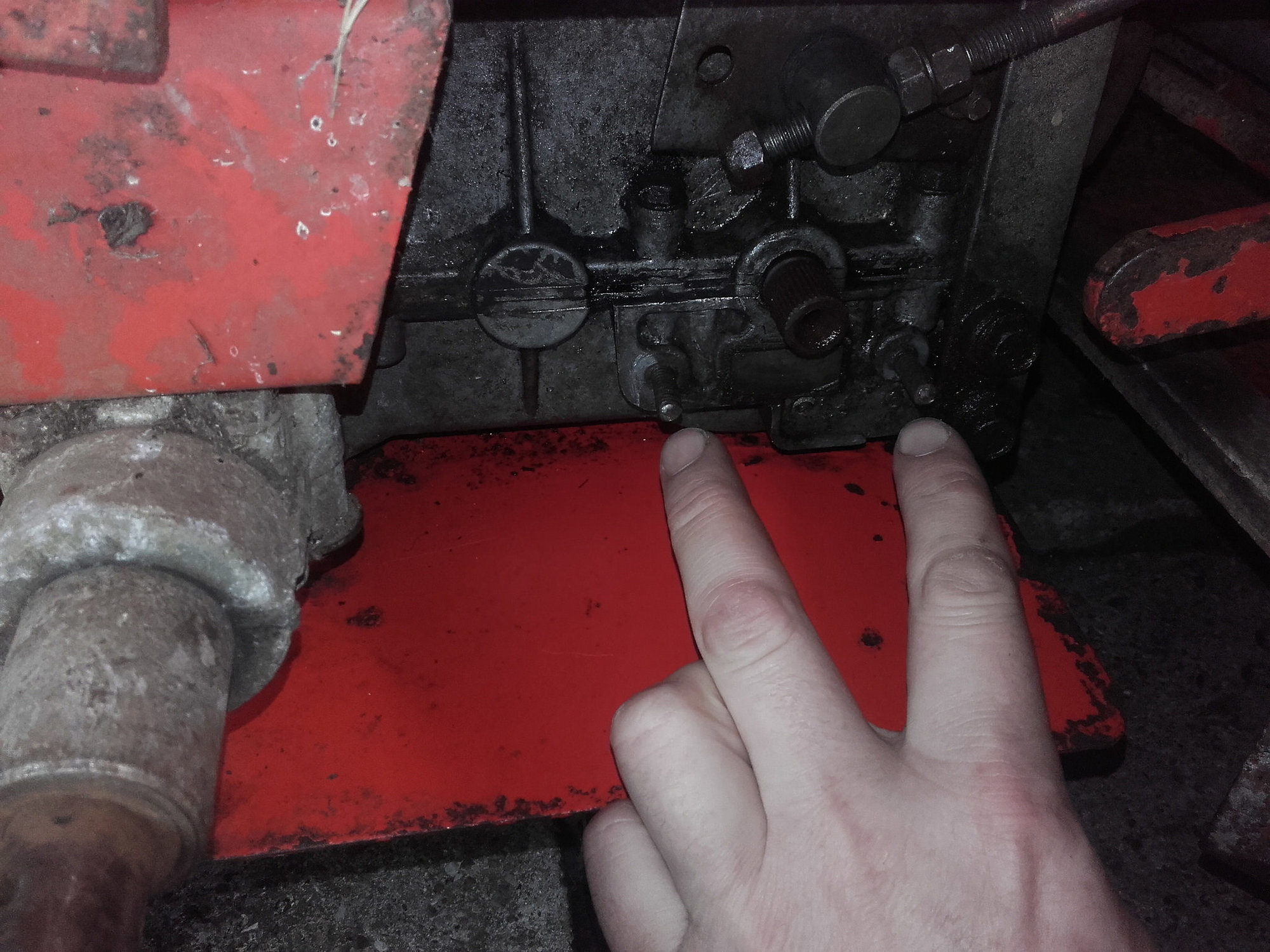

Going to fire it up one afternoon and see about this drive / gearbox issue. As I understand it the Peerless gearbox is supposed to be sealed for life and maintenance free? Feels alright turning the half shafts...

BMW [among other marques] will tell you "Sealed for life, Sir. No maintenance required" - yet the gearbox manufacturers [ZF in the brand I cite] say otherwise, and will even sell kits for the replacement of the oil and filter. It all hinges on your v. their understanding of the term "for life".
