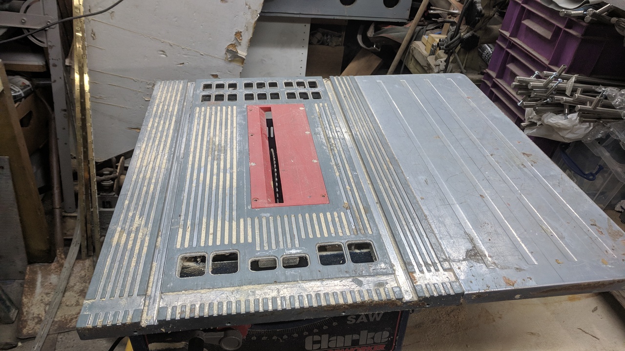

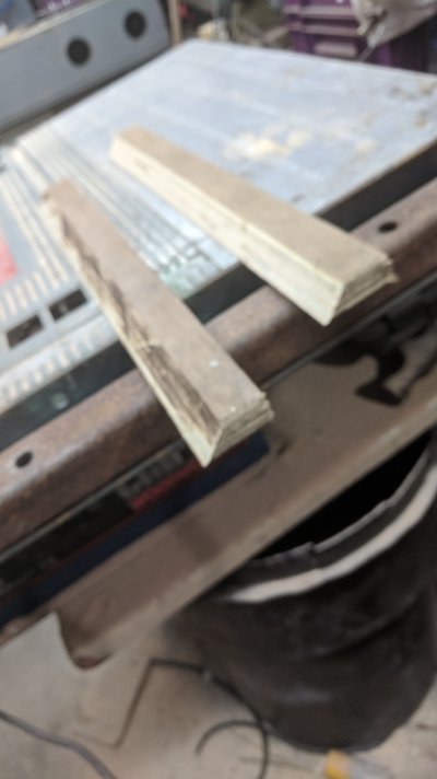

i have a "clarke woodworker 10"" table saw.
it came without a fence (or splitter, for that matter!)

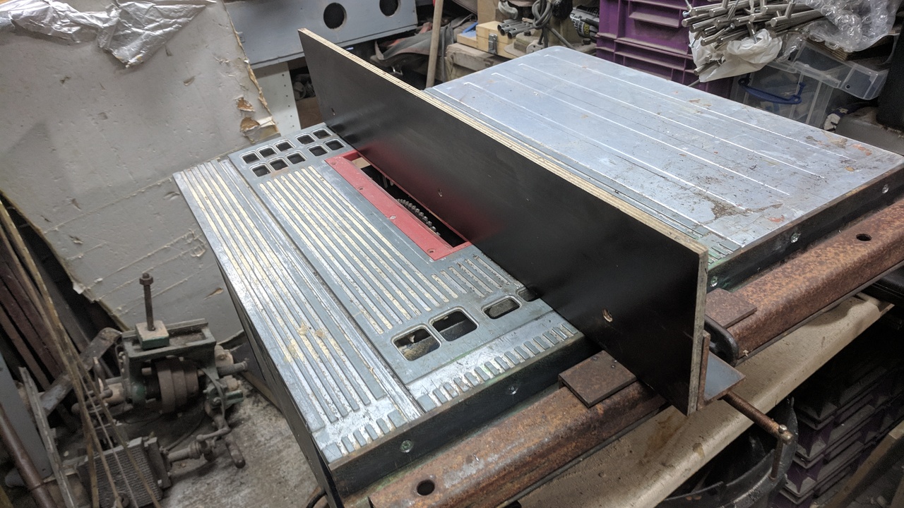

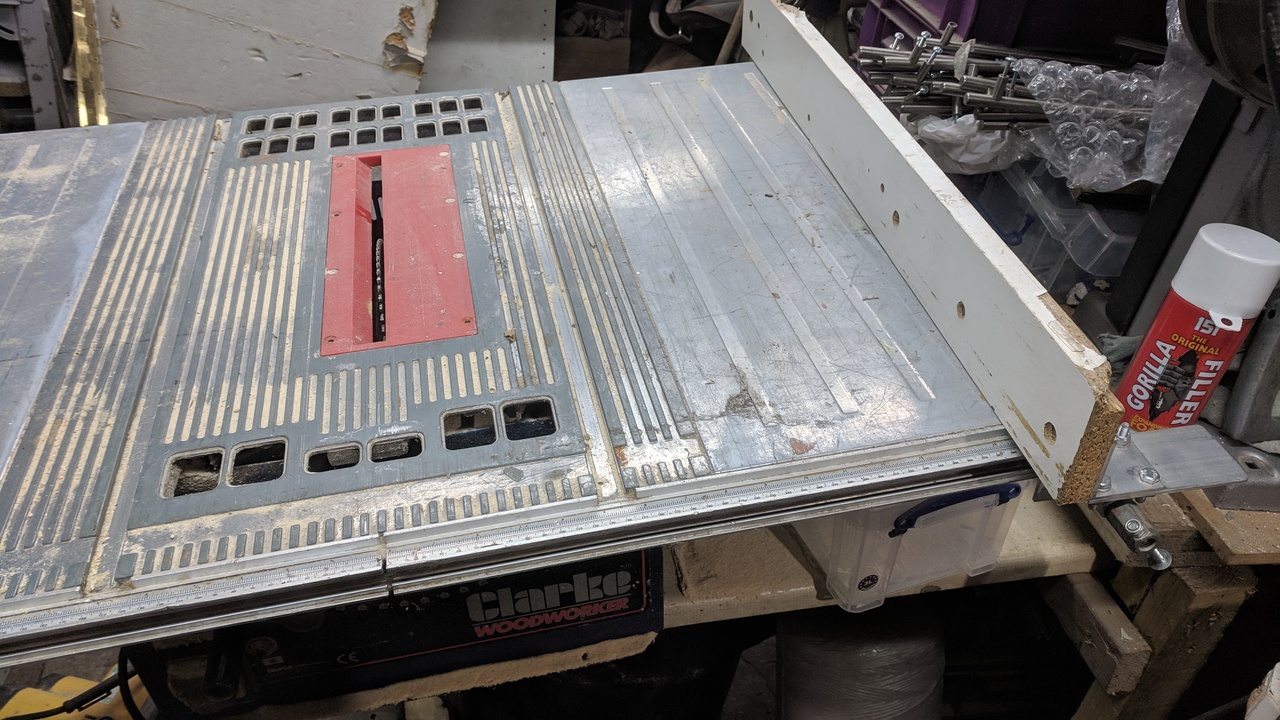

i bodged a fence when I first got it:
but it's rubbish.
so...

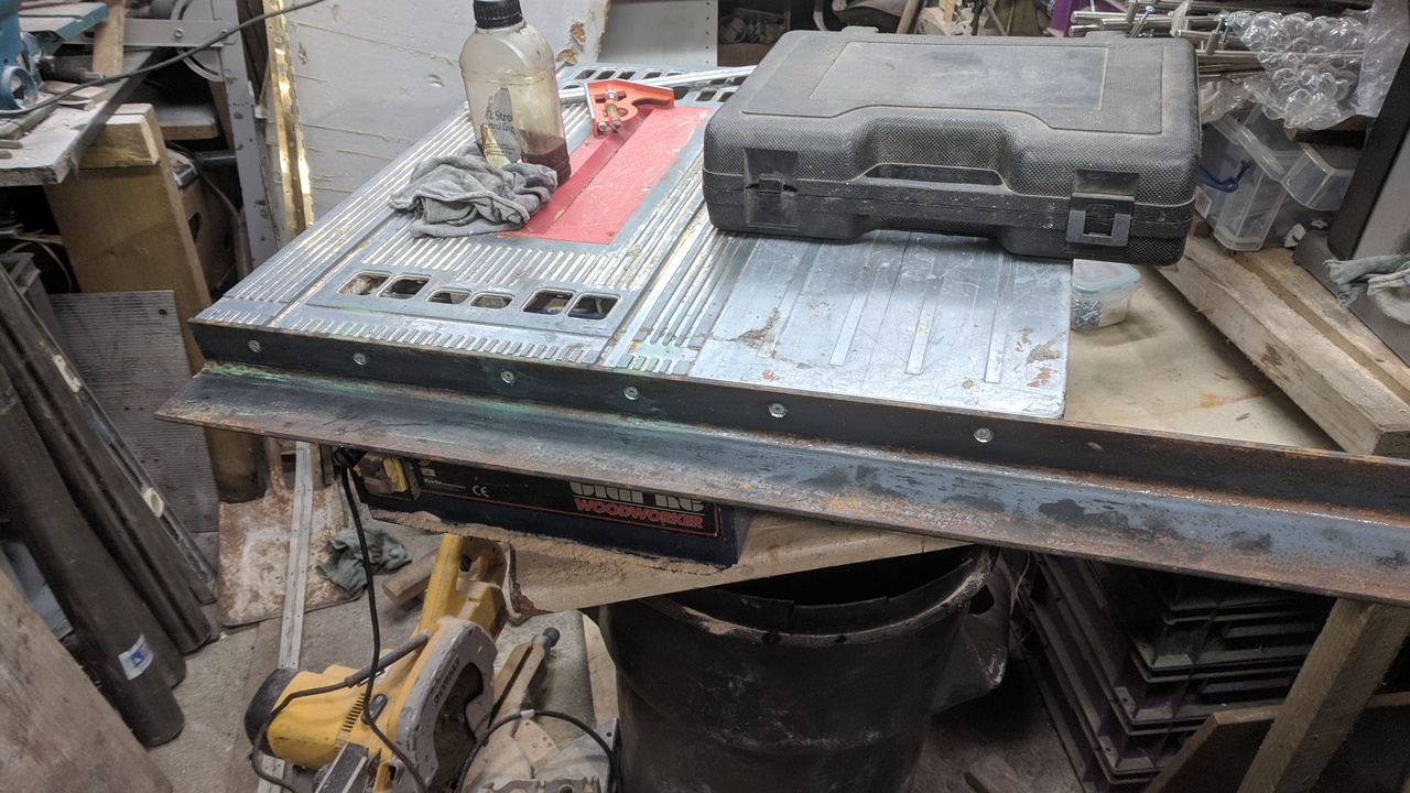

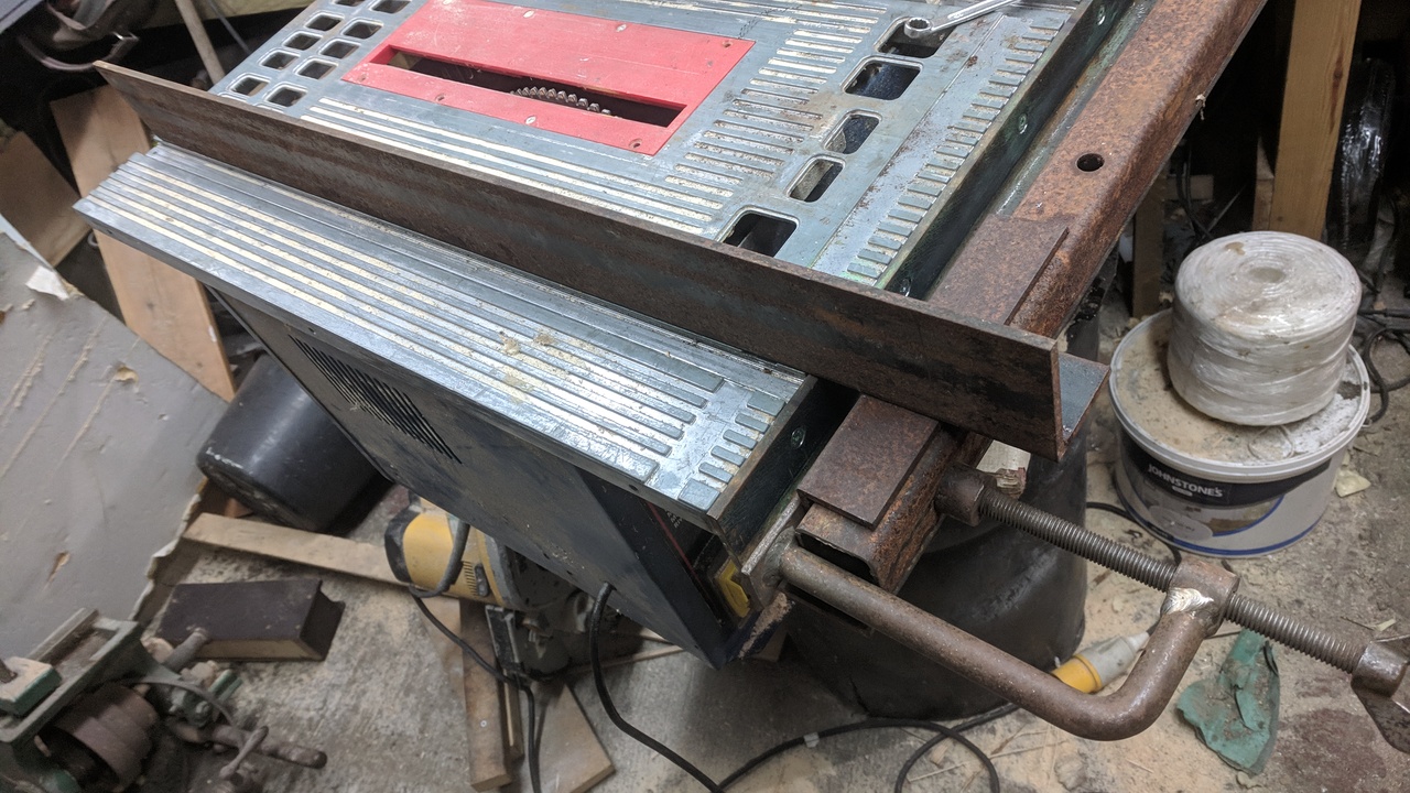

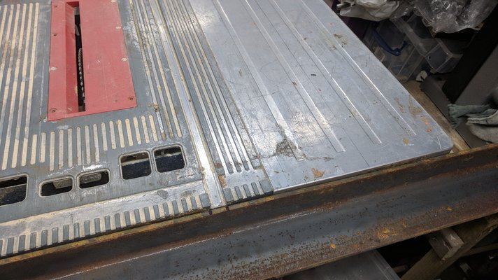

removed the fence rail from the front, and the left "wing"

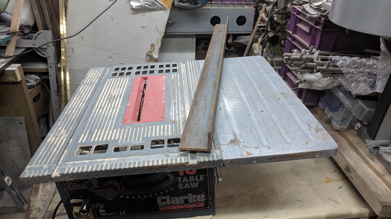

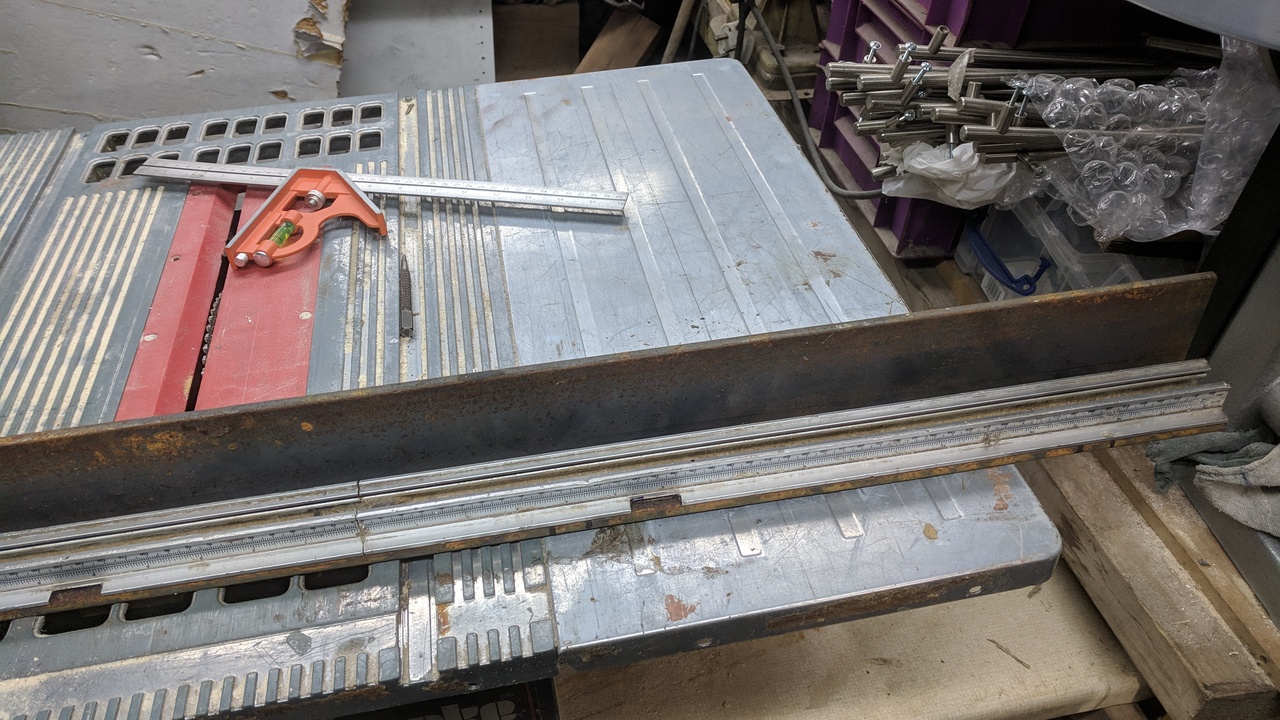

and i have this 75x50x6mm angle

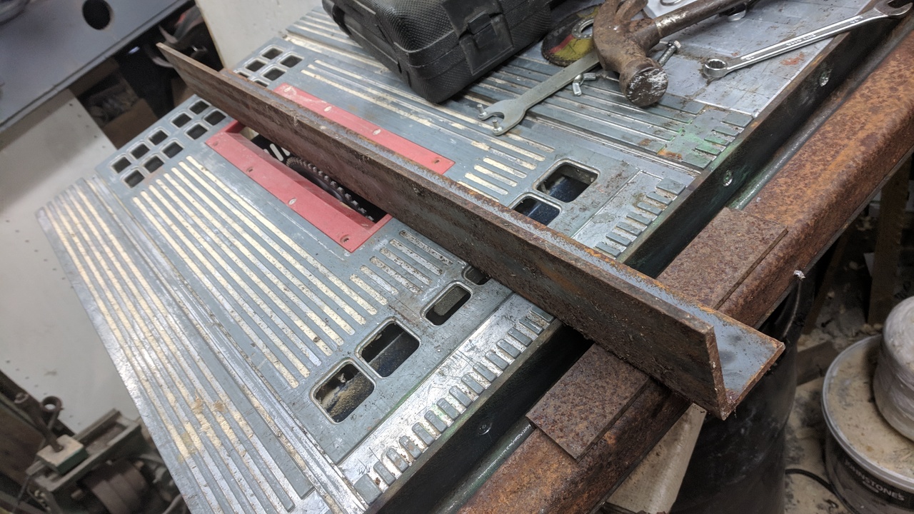

mark mounting holes and miter slots:

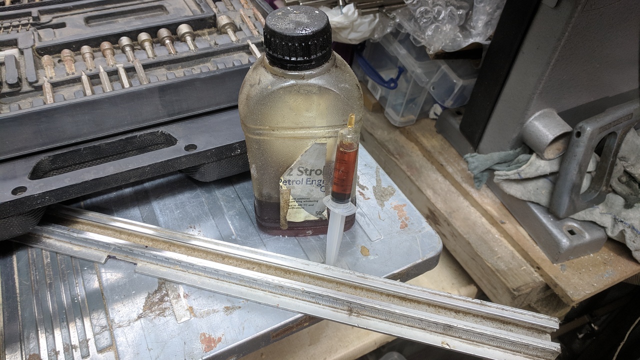

drilling fluid and applicator:
drilled, countersunk and bolted onto table

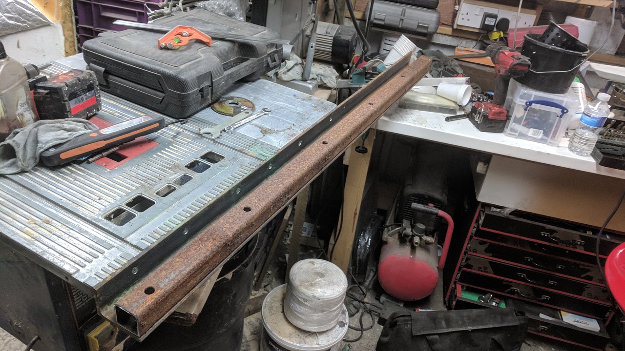

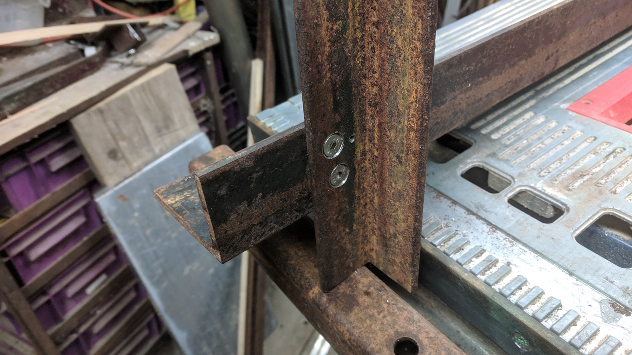

40x40x5mm square hollow section:
with extra! ferrous oxide. for flavour.

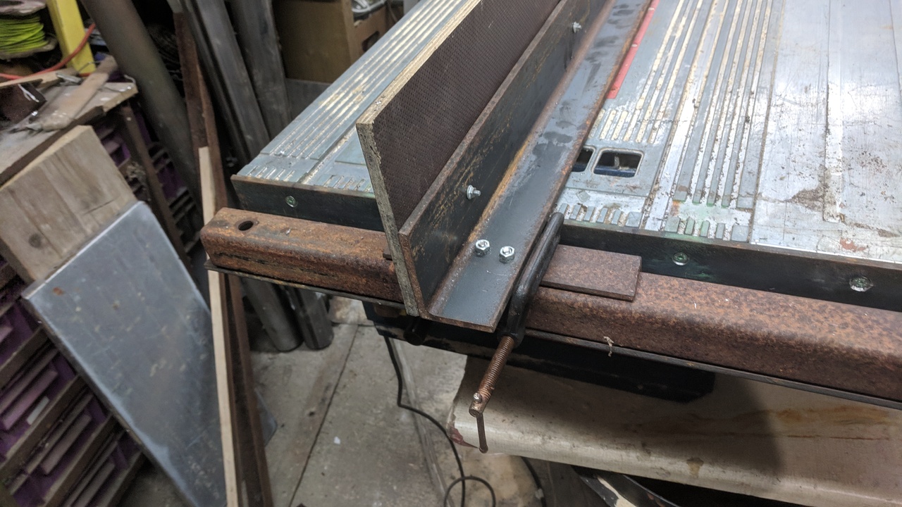

drilled right through@ 6.5mm, then top holes opened up to 10mm, and m6 cap head screws to fasten to the angle.
next job is the fence itself.
