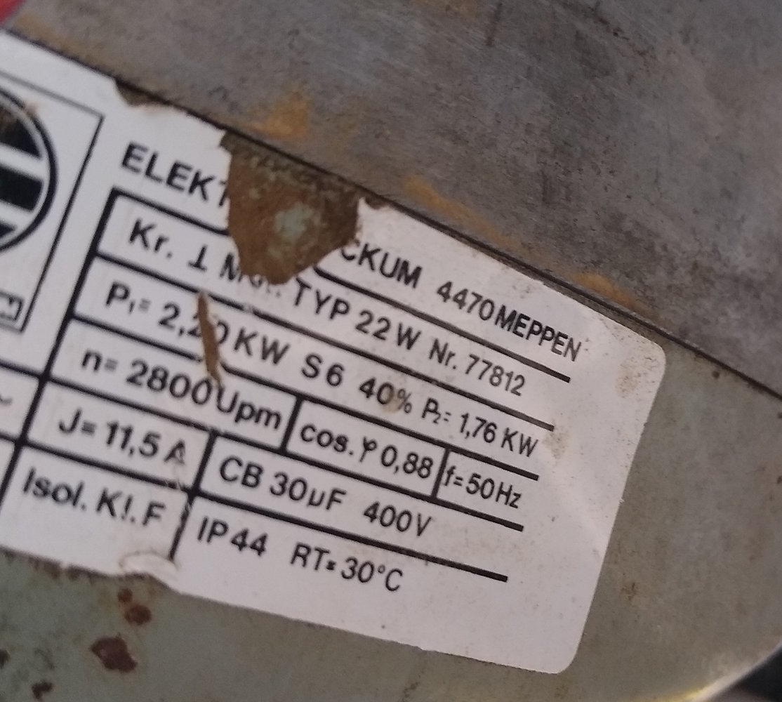

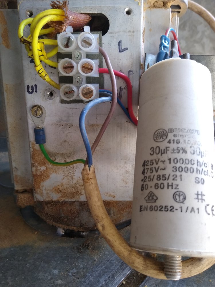

Several years ago I bought a used table saw and after using it for a month it started blowing 13a plug fuses a couple of seconds after switching on, If I spun the blade before switching on it worked fine. I replaced the only capacitor I can see on the motor with a 450v 30MF capacitor.
Initially this didn't seem to cure the problem but then it settled down and has worked faultlessly for 3 years or so.
Today it ran perfectly this morning then later in the day started tripping the ring main breaker (not the RCD) it's not blowing the 13A plug fuse at all and there is no delay between switching on and it tripping Using what little electrical knowledge I have I disconnected the motor and checked the motors resistance between L and N. I am only getting around 2ohm I think this is way to low , I disconnected the motors capacitor and still got the same 2ohm. Using an online calc I thing this motor at 2.2KW should be around 19ohm resistance, is that what you would expect? The motor is and has always been bone dry so it's not that. Is it worth trying a new capacitor or is that a waste of money at this stage?
