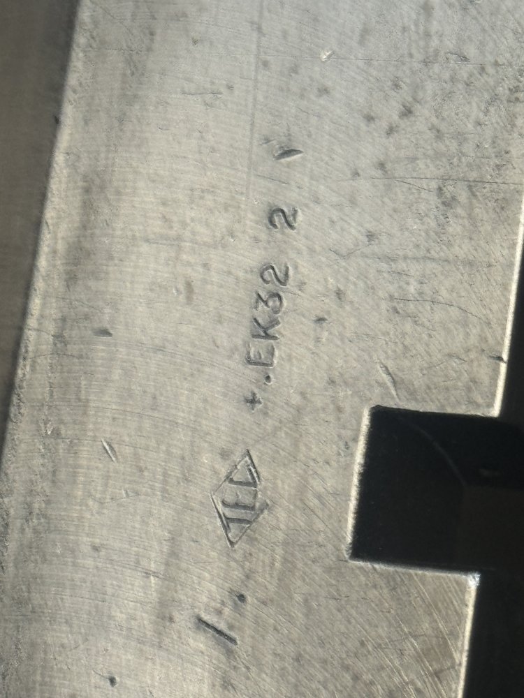

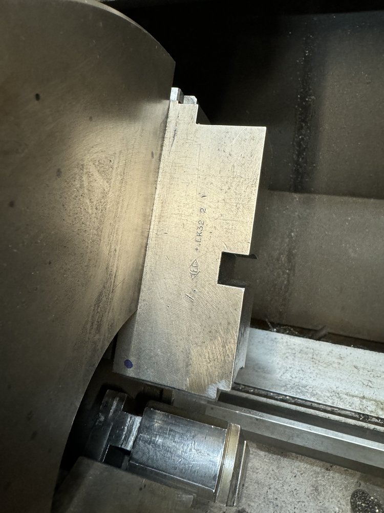

The lathe at work is fitted with what i believe are soft jaws. They are of a style which has a groove cut into the face. The groove is about ⅜-10mm wide. I have found a plain steel ring which fits the groove in the jaws so I assume you clamp the ring in the groove to load the jaws with equal pressure as they would experience gripping work.
I have watched Mr. Renzetti and Mr. Crispins videos on grinding/hard turning chuck jaws.
So the jaws don't appear to have been touched up in some time - you can see the wear in the jaw. This lathe gets used with all sorts of diameter of shaft but mostly around the 40mm mark.
It does clamp quite concentrically (usually within 2thou) but I'd like to get it better as the shafts I'm working on need to run very accurately (rotors from roots blowers).
