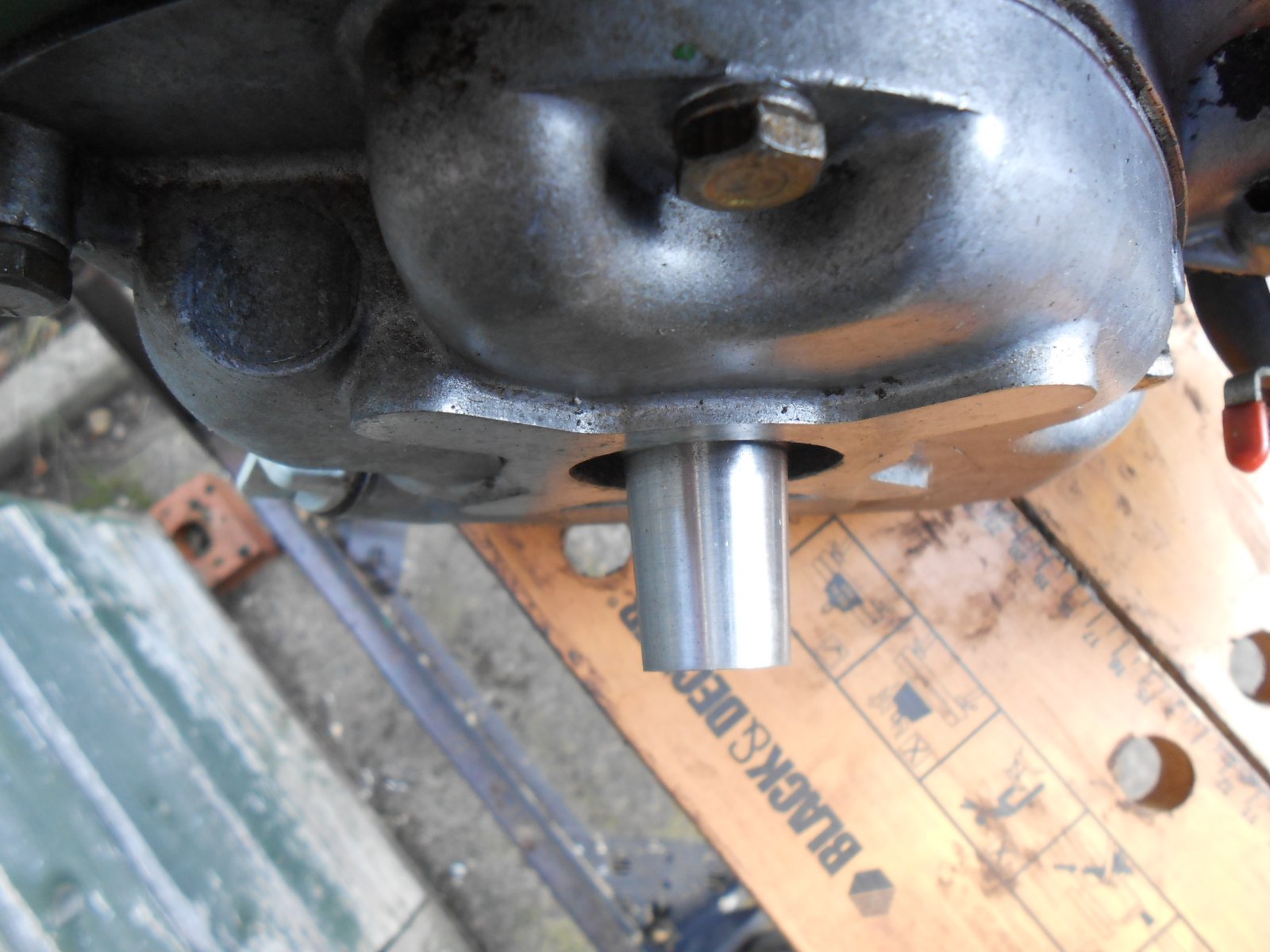

I have an engine with a tapered shaft which I would like to adapt to take a pulley, many hours of googling has found lots of parallel to taper adapters but only one (wrong size) the way I want.
I measured the exposed section of shaft 27mm (1.06") and it tapers from 22.7mm (0.983") to 20.15mm (0.793") and I wondered if there were any industry standard tapers that would help with the search?
The adapter would be retained by a bolt in the end of the shaft.
