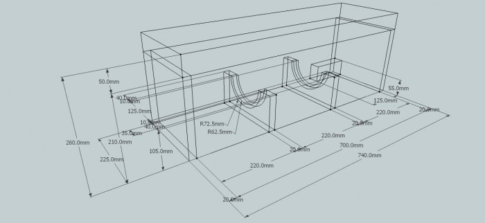

wasn't sure which section to post this in, but this seemed the closest fit !
the design is still a work in progress (as i don't have a welder yet!) and will probably be made with 1 - 1.5mm mild steel then painted and foam inserts glued in.
thoughts and comments please.

P.S. please excuse the drawing. first time i have had a go with a CAD program !
