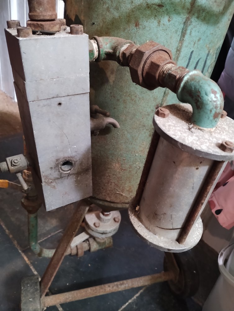

The courier dropped it off this evening and I've had a bit of a look at it. It is fairly different from the generic red ones.

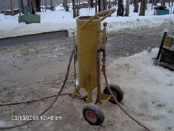

This is a diagram from the clemco site -

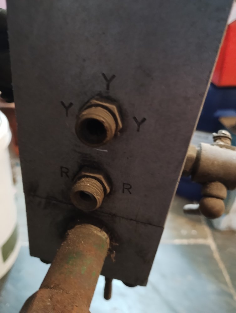

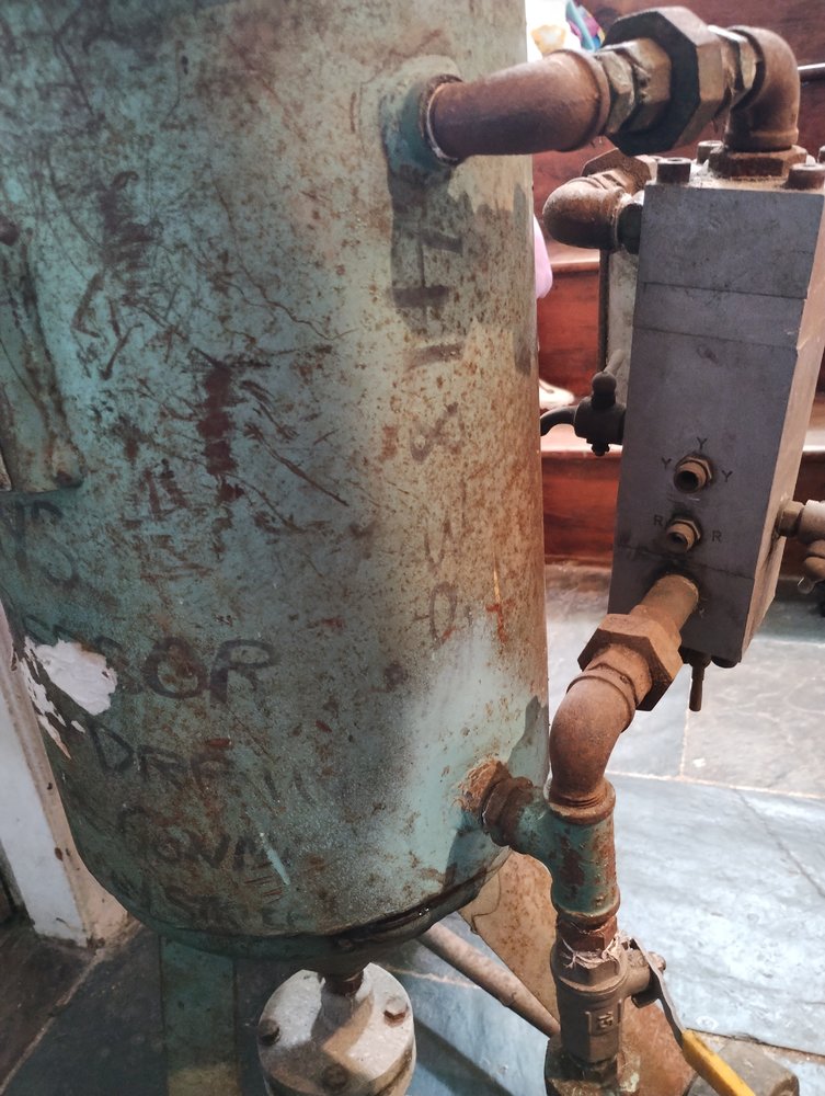

There's a big valve block on the side with a silencer attached. This seems to be controlled by some small pipe work to the dead man's handle.
It seems that the deadmans handle control causes the pot to depressurize, but this isn't clear to me. Something allows the pot to depressurize as that's what the silencer is for, that hangs off the side of the valve block.
There are two connections from the valve block to the pot itself. One to the mushroom valve and the other to the body of the pot. I'm assuming that the valve block first directs air to the mushroom and then, when the backpressure to that rises, it also sends air to the pot itself?
I don't have the hose / dead man's handle / control hoses. If they prove prohibitively expensive, I'm wondering if the valve block can just be replaced with a couple of ball valves. One to first pressurize the mushroom, and then a second to open up the flow to the body of the pot? Sure, the proper setup would be nicer but I thinking the handle etc may be multiples of the cost of the pot itself. Maybe not.
Anyway, is my understanding of the valve block operation correct? Mushroom, then pot body, then, somehow, dump the pot pressure through the silencer on release?
