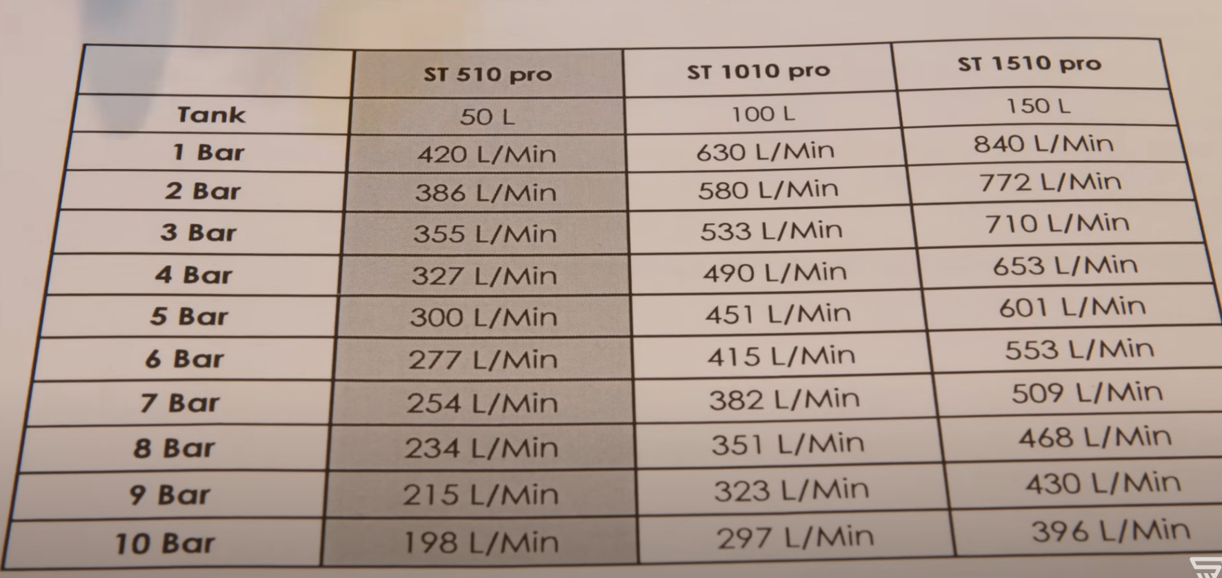

So i've been looking at those 'new' compressors that have a motor and 2 short stroke pistons either end, oil free due to a teflon seal etc, but they seem to have fairly low air outputs unless you get one with 3 or 4 of the compressor units on a tank.
Then i saw this compressor : https://www.stahlwerk-schweissgeraete.de/brushless-compressor-st-1250-bl
Each motor runs 4 cylinders rather than the usual 2, and it claims 12 BAR pressure, and upto 500L/min (that's obviously when the tank is pressured to something like 1 BAR, and the real L/min output will go down as the pressure increases)
it seems that instead of pumping that tank upto 12 BAR then using a regulator to vary the outlet pressure, it instead pumps the tank to the pressure you set on the control panel, not sure that's a good idea... i have a pressure regulator inside my workshop anyway, so i'd just set the pressure to max on the compressor all the time.
And this 'brushless motor' bit, mains induction motors are 'brushless' anyway, so is this a DC brushless motor? it has 2 speed settings to vary the amount of noise it makes.
Obviously a lot more electronics to go wrong, this compressor has a 7 year guarantee, but i can see my current compressor still running fine (if noisily) in 20 years time, and it's already 15 or so years old.
