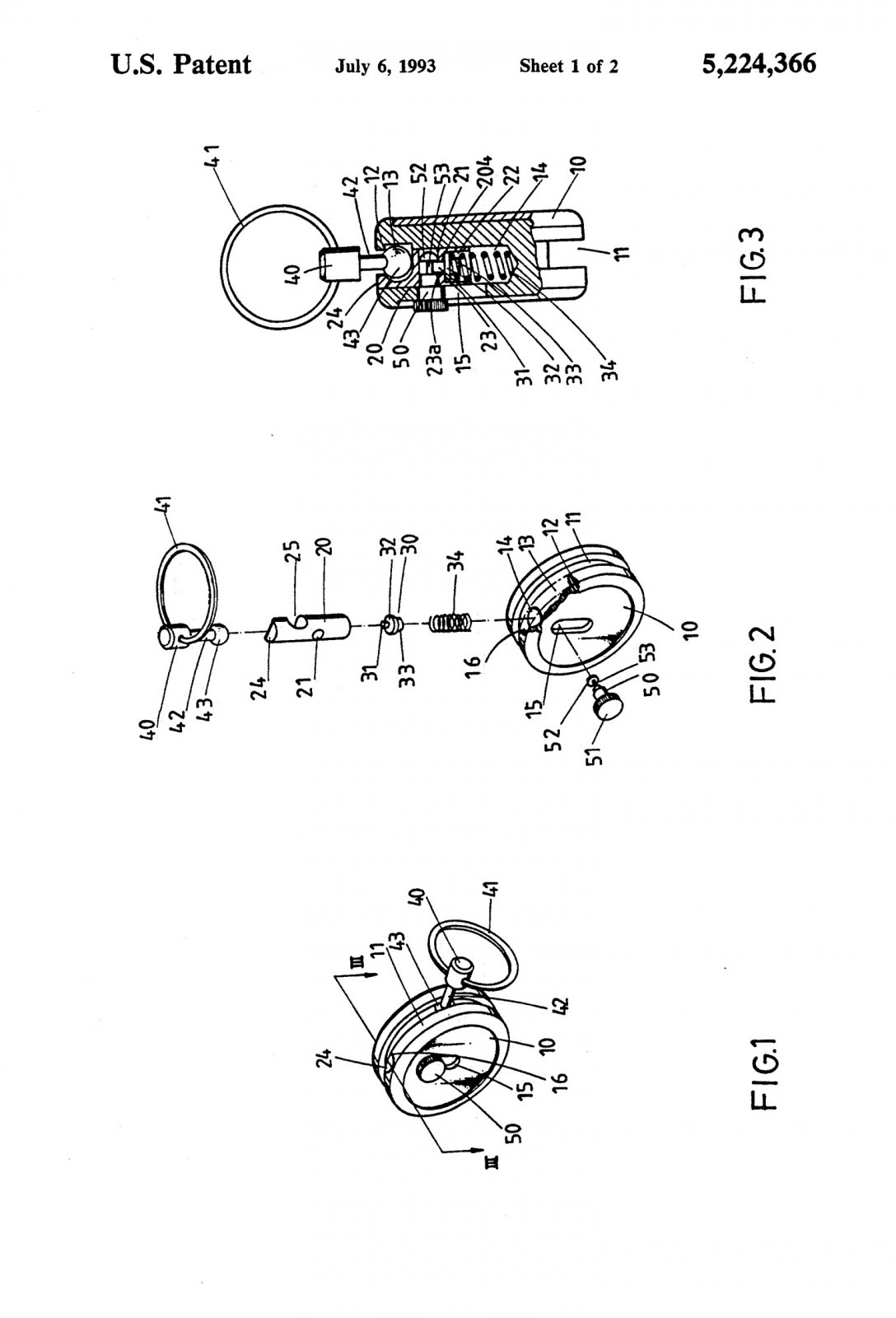

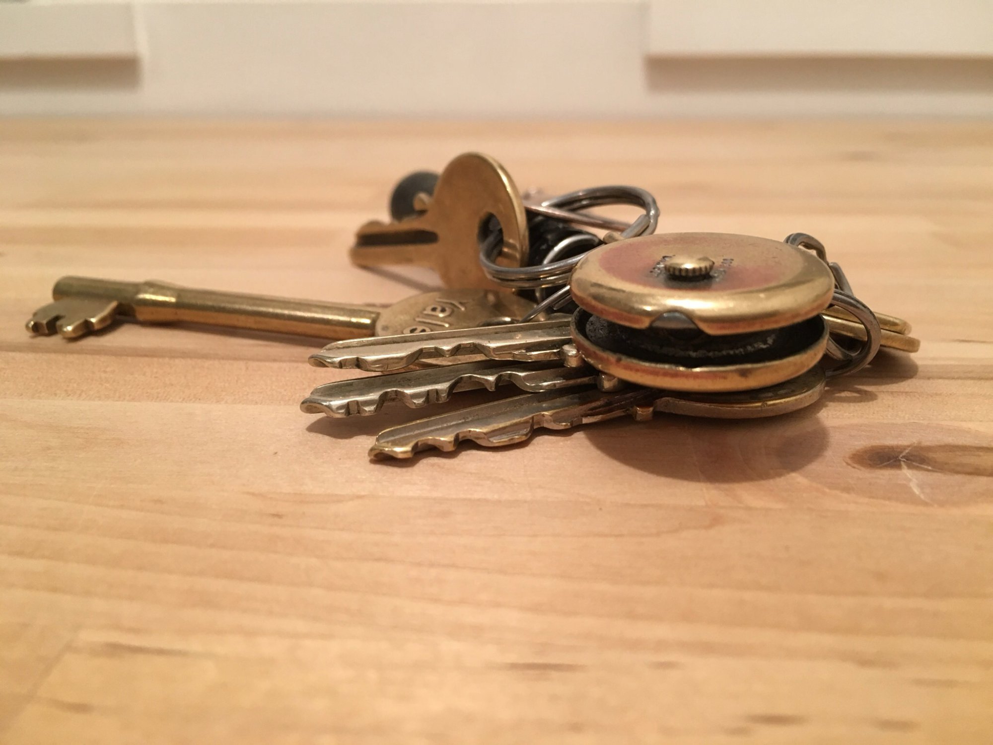

I need to repair my favourite keyholder. The Troika Patent key holder. Had one for years now it's worn and I need to take it apart.
Here's the construction:
Looks like the spring goes into the hole with a catch on top. The retaining bolt goes on top and the little stud then goes into the hole, retained by that tiny pin on the spring. I need to somehow pull the spring back with the pin latch, remove the stud. There's a 1mm hole under the spring....
