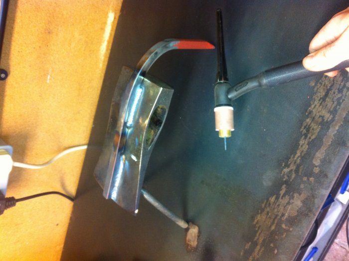

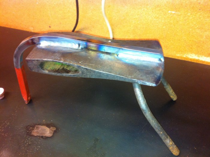

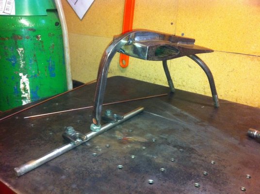

I have made two or three of those,(without the axe head) I took Jodies advise on "welding tips and tricks" and brazed a layer of brass onto the three contact points for better conductivity. Also stripped the insulation from a couple of feet of heavy welding earthing cable to wind round jobs that you do not want any arc strikes on.
