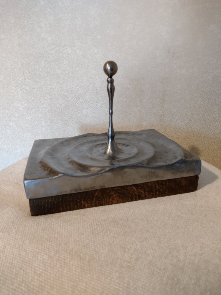

Sort of. I welded 3 pieces of different thickness rod together, welded some extra bits round it in places, then stuck it in the pillar drill and blended it with a power file. Ball bearing is welded on top.You turned the spindle, droplet thing ?
No, some concentric steel rings.I really like that
Did you form the metal sheet over a similar shape wooden former ?
