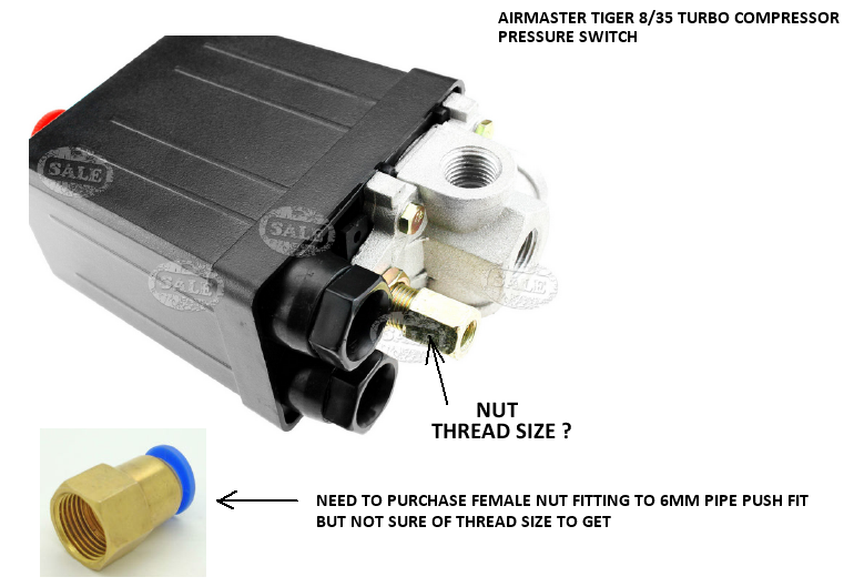

please could some body look at the attached picture of my airmaster tiger 8/35 pressure switch.
I need to purchase a female fitting to 6mm pipe push fit , but I am unsure of thread size to get
that will thread onto the pressure switch.
Hi thanks for that.
It turns out that for some reason, these pressure switches have a 3/8 unf 24tpi thread for the 6mm bleed pipe nut.
But to make sure I today purchased a 3/8 24tpi brake pipe nut locally and it is perfect.
So it looks like I will need a 3/8 unf female to 1/8 bsp male fitting. then purchase a 1/8 female bsp 6mm push fit.
Don't know why they went for 3/8 unf on these pressure switches though.
Thanks for your help.
it is -3 jic that is not a 'standard' hydraulic size, but if you have a brake flare nut to fit it then just buy 1/4 bsp socket and weld it together and then screw standard qr bsp to whatever pipe size you want.
