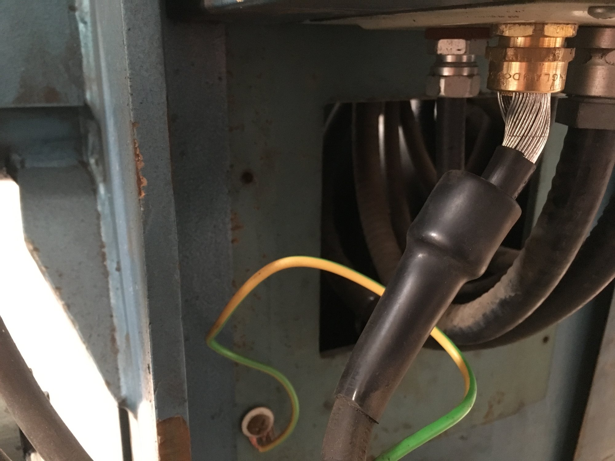

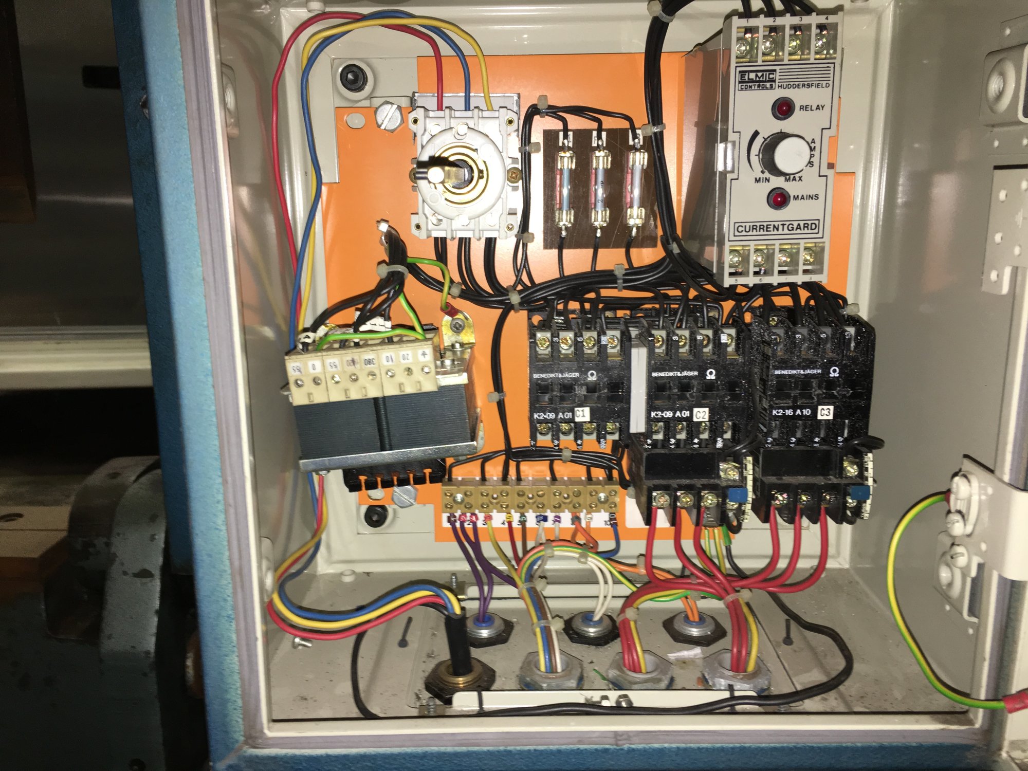

This folder was connected with a 4 pin plug using SWA cable, and a seperate earth wire going to an earth block on the fuseboard....the SWA was/is connected at the junction box end but just taped up at the plug end. The red, yellow and blue were connected to L1,2,3 at the plug...the black wire connected to the earth pin (assumed it was neutral at first with a 'custom' plug/socket...) but can see it connected to other earths with a green/yellow sleeve over it in the bottom right of junction box.
So the socket that was being used would have just been the 3 lives and an earth, no neutral in use?
the seperate earth wire had me wondering...was it probably an alternative to using the SWA armor or 'belts n braces'? fairly sure the earths in the junction box aren't isolated from the rest of the body
anyway...main thing is I want to connect it for now using 5 core cable and a 5 pin plug...what's best to do with the unused core and the neutral pin on the plug?
